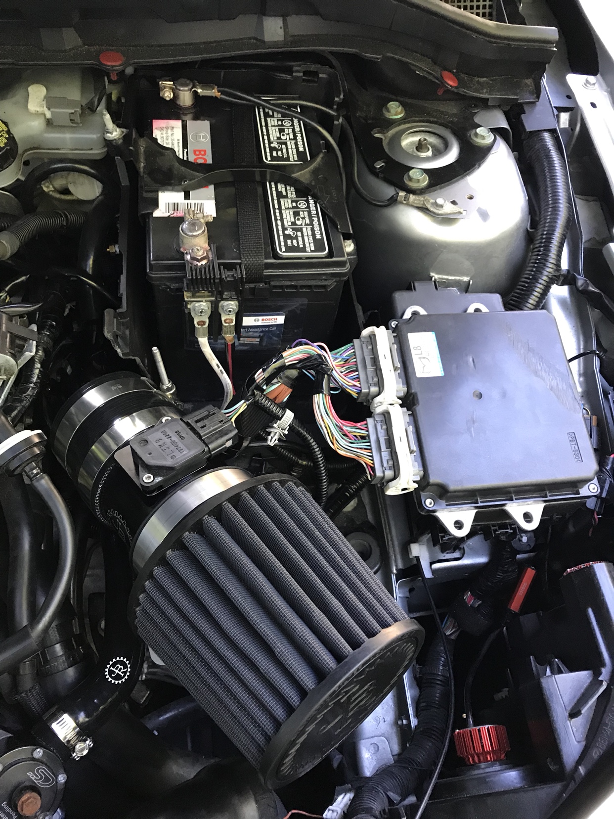

Corksport 3" only requires this:
$5 Stock Battery Box Mod
Any 3.5" intake requires ECU relocation or 51r battery.
Both will flow enough for 400HP.

Originally Posted by achulz View Post
Have you tried mounting it in front of the battery box? Or are the wires too short? I was planning on doing this too, didn't know it wouldn't fit a 3.5".
With a 3" you can just take off the ECU mounting bracket and bolt the darn thing straight to the box and not have to worry about moving your harness and securing the ECU somewhere. We did this on my buddy's car, too. He's running my old CS 3" on a Gen1. I have the JBR 3.5" now, which absolutely does require moving the ECU to the top of the fuse box, as the battery box had to be cut. Or you can just get a 51r battery. I'm cheap, so I didn't lol.

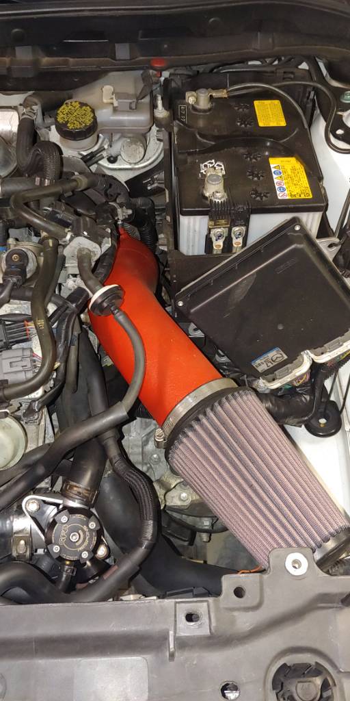

I run a 3.5" intake and just ziptied it to the front of the battery box.

Originally Posted by LowFlyin View Post
Ramfab
Sent from my LM-V350 using Tapatalk
Yeah that is a milder bend. Most intakes need a battery box cut.
I see what youre saying there. Mines a bit further forward before the bend.
