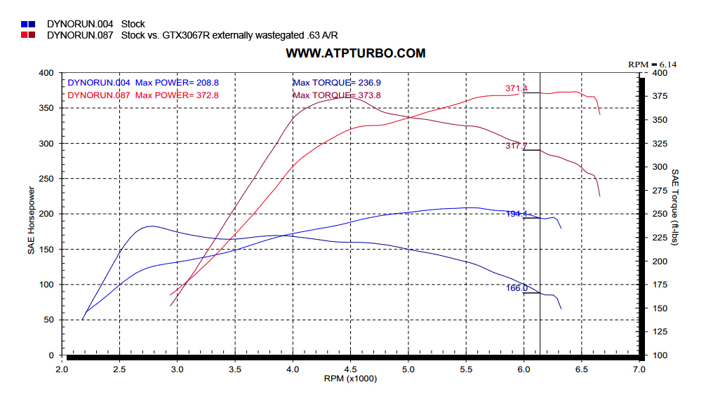

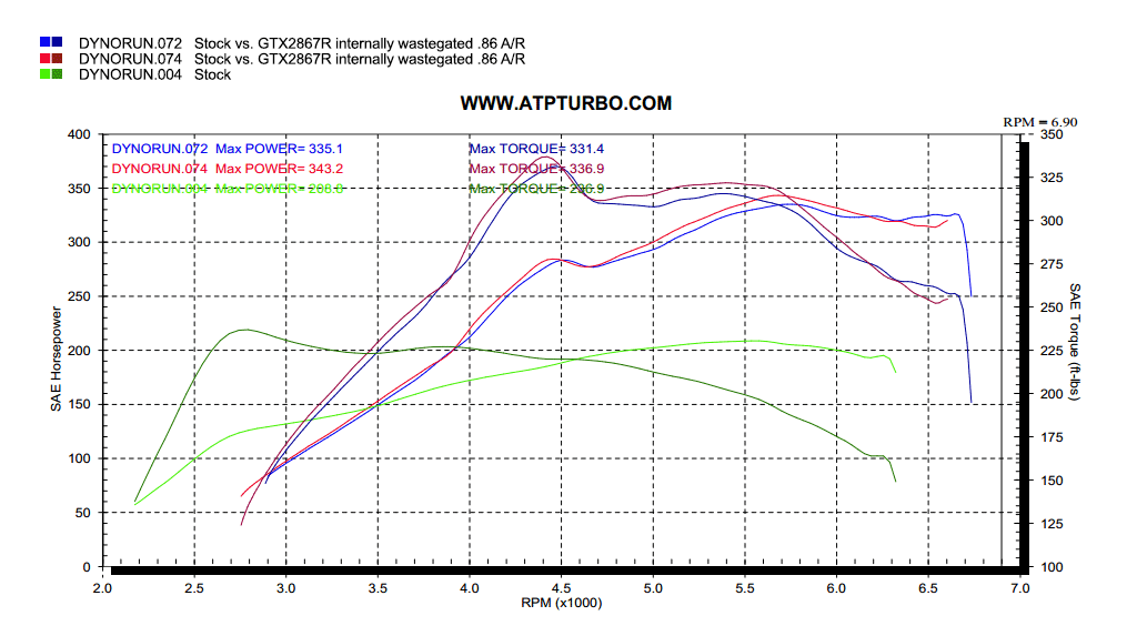

Also I was taking a look at the focus st dynos between the gtx2867r and the gtx3067r and there was virtually zero difference in spool but yet the GTX3067r made like 30-40whp more. Actually even looks like it may even have spooled faster as it was making more power down low than the gtx2867r.
GTX2867r
GTX3067r

I think a lot of people are thinking you want to switch to a gtx3076 which is a far different turbo than the gtx3067. Do they make an ATP 3067 drop in kit for us? Haven't checked yet. Lol.
