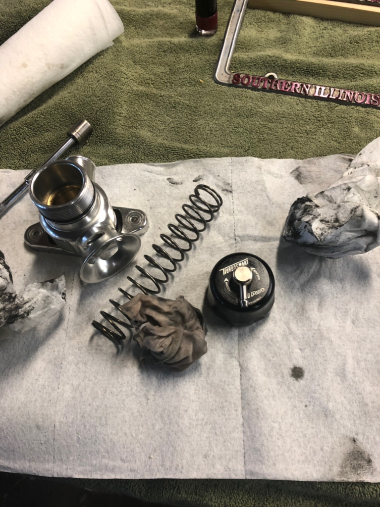

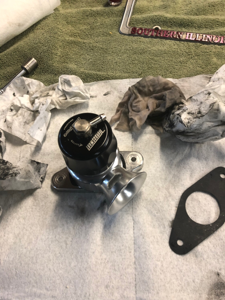

Default My adventures with the speed6
Pics from cleaning the bov. I bolted everything back up and took her for a spin and watched HPFP 1778 at a decent pull never dropped. I still seem rich but hit a decent 3500-5500 rpm pull 3rd -4th and was watching boost and hit 23.5 psi not wot. So hopefully I can hear back from PO lol I think my boost leaks are fixed

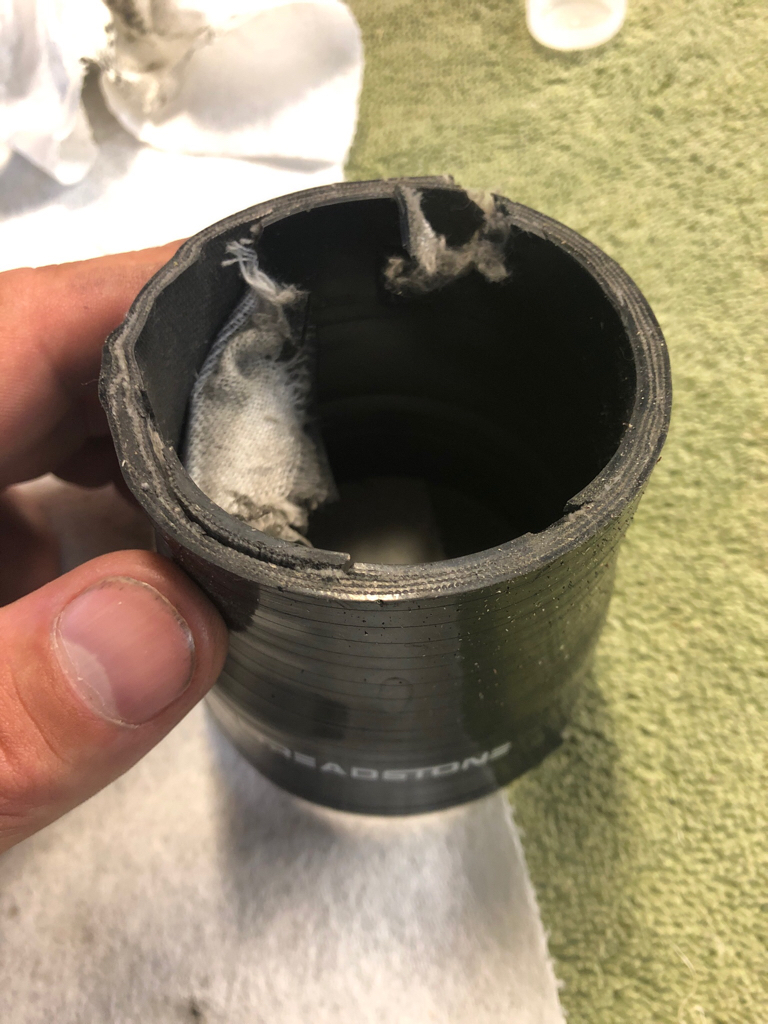

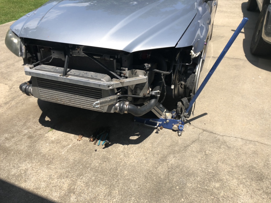

I’m getting absolutely so tired of blown off boots. Hairspray ain’t working I’m about to glue these bitches.

Try soapy water and maybe t-bolt clamps if you haven't already.
I have tbolts, some seem stripped and replaced a couple. Soapy water just lather up and install and let dry?
I wouldn't say 'lather' it up but maybe a spray of it or lightly lather your hands and smear a little on the inner hose.

My TIP was slipping off of the turbo. It had some tacky slimey stuff on the inside. I cleaned it up with Goo-Gone and it's all good now. Clean silicone is quite sticky, so you shouldn't need "hairspray" or GLUE. Lol!
These don’t feel oily or anything like that they’re just blowing off under boost. 3 different locations as well. I’ll look everything over real well over the weekend

The PO had like the ugliest little hornets nest of zip ties on the charge pipe from turbo to FMIC, I cut it loose and it keeps blowing a connection lol.
I’m thinking of getting new boots and tbolts and
I’ll try it out. Man it’s getting bad. 4 times yesterday just barely cruising and today twice. Day before was 5 minimum with my youngest ( my road Dog

Sounds dumb, but check to make sure the clamps and silicone are actually the correct size. I've had some issues with parts being miss-sized, 5mm isn't much, but it makes a huge difference in stuff staying together.
A couple of the clamps do seem they could be smaller.

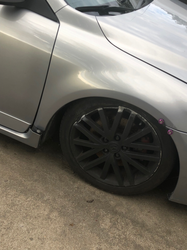

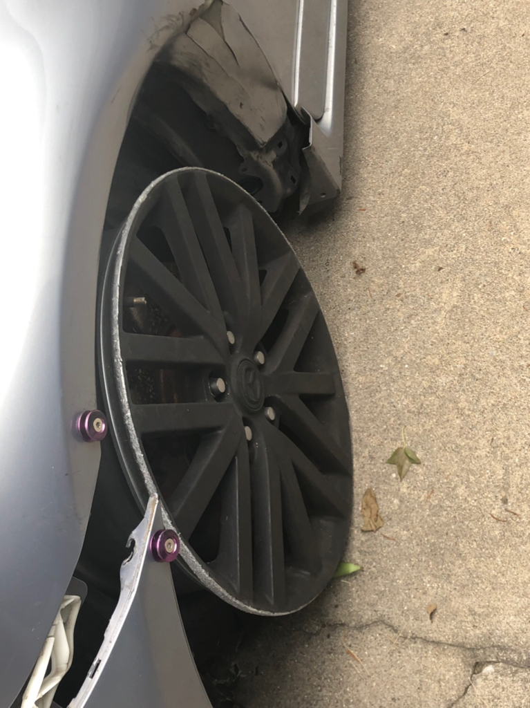

I recently wrecked in the speed had the abs/ etc sensor go off at the wrong time lol. Anyway this is gonna sound funny but how the hell do I pop the hood from outside the cab. Somehow through it all the pull was knocked off and I cannot find anything to pull under dash or even jacking the fucker up
Need 2 new rims and tires lol luckily the tires only had a couple K on them before this bs

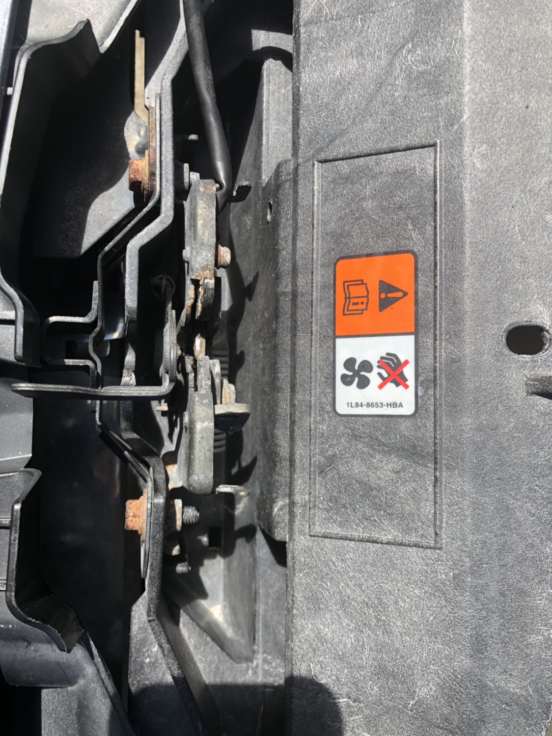

Can someone pop their hood and snap me a picture of the hood latch mechanism? Trying to figure out how to pop hood without being able to use pull from inside the car. Can’t find the cable or where it would have exited out. No clue how it’s gone all the sudden
When you say you can't find the cable, did it detach from the pull under the dash, or did it detach at the hood latch?
If it detached at the hood latch you may be fucked. When I had a MS3 I had the same problem, and I was able to wiggle the cable back into place from under the car. Not sure if you'd have the same luck on a MS6.
It detached from the pull under the dash and I cannot find a cable under dash to clamp a visegrip on, or even a hole through the firewall that’s missing something so I can look outside from underneath. What really pisses me off is the hood was popped and I pushed the hood down out of necessity lol
I can’t find anything online but I found a couple pictures of the new unit so I might be able to reach up somehow and hook it to in latch. Guess a hood pin set is in my future
I’m hoping I can make a hook tool to hook the cable pull location or maybe even come up from underneath on the left side to pull the other catch. So frustrating lol

Its just gone?!?! Was going so fast I blew off the hood pull

how'd you end up getting it open?
Was able to reach up behind the bumper and grill and search for that pull. Took a few tries cause I have big ass hands.

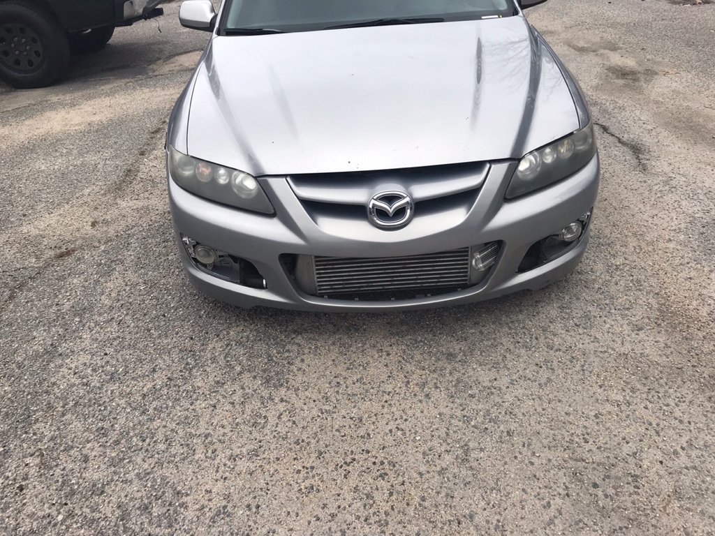

Here’s how she’s sitting right now
