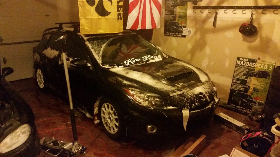

Picked up some new toys, got the yakima roof rack on (for that grocery getter lyfe).
Ordered a new skid plate, a prosport boost gauge, and a UR downpipe.
Should have them all on by next week sometime, and I'll post pics
For now this is all you get! And yes, it's awesome in the snow!
