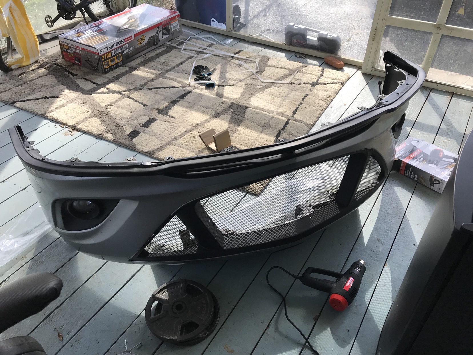

Finally got around to replacing my front lip that was smashed by a dead possum on the highway at 70mph. Still need to plasti-dip it matte black to match the rest of the trim, but my baby’s whole again.

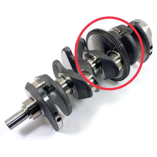

WTF helical gear are you talking about?
The one the balance shaft connects to.

Oh shit. My bad. I forgot about that gear for some odd reason.
Well...good luck with the build. No sense in putting all that stock crap back in. Time to go full forged build. 700hp. GO!

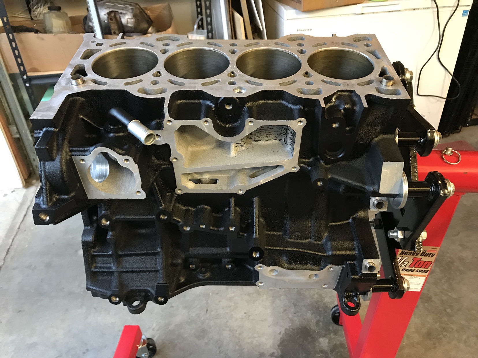

So, I took my block to the machine shop and got amazing news. All 4 cylinders are perfectly round, crank pin and main journals literally have zero wear, everything is .000" from factory spec, main bearings literally look brand new. After 190,000 miles it's still like a brand new engine inside if not for the oil discoloration. I think I found a unicorn!

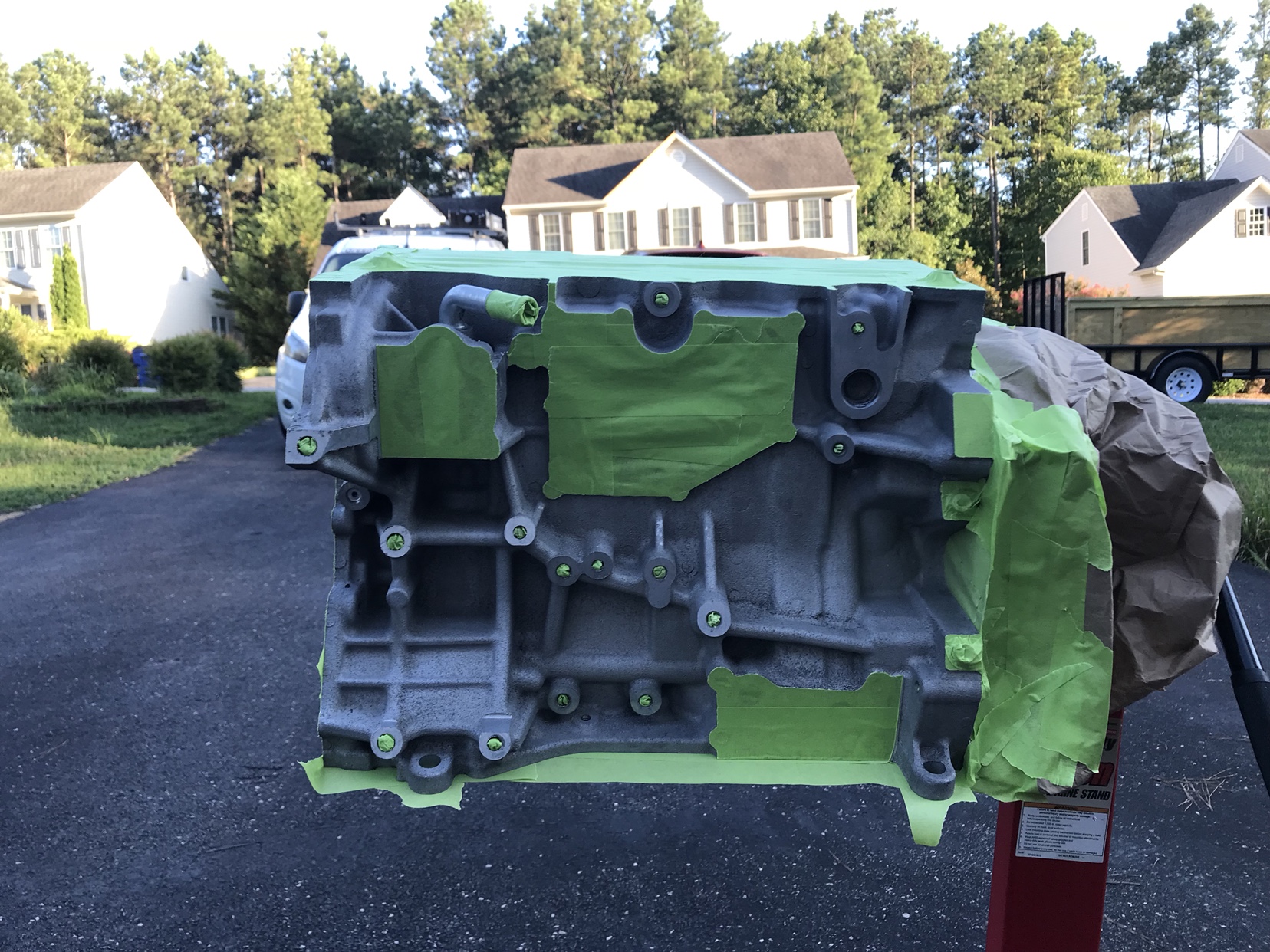

Decided to go with Manley Platinum Series 87.5 Pistons w/.210" Wall Pins and Manley H-Tuff Plus Rods. Still researching bearings since Clevite H Series mains aren't made anymore for the speeds. Bummer.

Got a whole bunch of parts in. Got the block back from the machine shop. Since I’m still waiting for parts, I painted the block today.

Oh yea, I forgot to mention before that when the head was thoroughly inspected, it turned out the recently redone valves were done poorly. The seats were obviously done by hand and were visibly uneven, so I made the executive call to go with a brand new, fully redone Supertech valvetrain. The head is also being custom worked, crank keyed, and rotating assembly precision balanced by a freaking wizard who works primarily on professional race cars and has taken an interest in my project. I'm so excited I can hardly contain myself. More info to come later.
 Old 07-19-2018, 02:28 PM   #114
Fstrnyou's Avatar
Join Date: Jul 2016
Location: Near Charlotte NC
Posts: 2,498   (View Stats)
Thanks: 55
I weight matched my stuff to within a few tenths of a gram. I asked to have my crank balanced, and paid for it, but saw no evidence of material removal. Maybe Mazda got it perfect.
JBR Tru-3.5/3-port EBCS/EGR-D
Damond RMM/PMM/OCC/PCV Plate
Other rides:
History:
2008 GSX-R 1000 - Stolen
 Old 07-19-2018, 02:31 PM   #115
Solarsurge's Avatar
Join Date: Apr 2016
Location: Richmond, VA
Posts: 577   (View Stats)
Thanks: 24
Thanked 120 Times in 95 Posts
Manley was pretty good right out of the box. All my pistons were within 1g and the rods were all within .6g on the little end and 1.2g on the big end. I’m gonna get them even closer, but that’s pretty solid as a starting point.
 Old 07-19-2018, 02:54 PM   #116
Fstrnyou's Avatar
Join Date: Jul 2016
Thanks: 55
Ya. They weren't bad. My machine shop only matches to within a gram though, so I did mine myself.
The piston, ring pack, wrist pin and locks, and the small end of the rod are all considered the reciprocating parts. The weight TOTALS should match. You don't have to make all the pistons identical, or all the wrist pins identical. The ASSEMBLY should be identical. Measure everything individually. Then shuffle the components around to get the assembly close. Then weigh the parts as an assembly for an accurate combined weight. This will drastically cut down the amount of grinding/filing necessary to match them. The lightest assembly will be your target. Remove material from the heavier assemblies.
Other rides:
History:
 Old 07-19-2018, 03:00 PM   #117
Solarsurge's Avatar
Join Date: Apr 2016
Thanks: 24
Yea, I’m well aware. I haven’t touched anything yet because I’m still waiting on my bearings before I weigh everything officially and start matching parts and grinding things down. I’ll cover the blueprinting tool I made later down the road. Everything is being measured, weighed, put within spec and balanced.
 Old 07-19-2018, 03:19 PM   #118
Fstrnyou's Avatar
Join Date: Jul 2016
Thanks: 55
The bearings will all be identical. But that only matters on the big end. You can match the reciprocating assembly while you wait.
Other rides:
History:
 Old 07-19-2018, 03:24 PM   #119
Solarsurge's Avatar
Join Date: Apr 2016
Thanks: 24
I’m also waiting for a new, more accurate scale lol.
 Old 07-19-2018, 03:25 PM   #120
Fstrnyou's Avatar
Join Date: Jul 2016
Thanks: 55
Consistent is more important than accurate. I used cheap eBay scales.
Other rides:
History:
