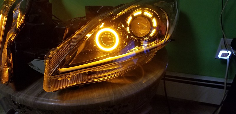

Hello Guys!
I'm new to the forums and a new mazdaspeed 3 enthusiast. I hope this post is in the right section.
I haven't picked up a speed 3 yet but im looking to grab one by end of summer, beginning of fall.
In the mean time ive been working a project, i used to do custom headlights on the side and ive always waned to do a custom job on Speed 3 tech package headlights. So right now i have opened a set of speed 3 technology package lights and have modded the stock projector with sharpen the cut off, as well laser etched a custom design and did a passive demon eye mod, as well as led demon eyes. To my surprise i discovered behind the triangle section of the lights cover the DRL section, there might be space to add a second projector. I shall post pics for your viewing and progress here shortly.

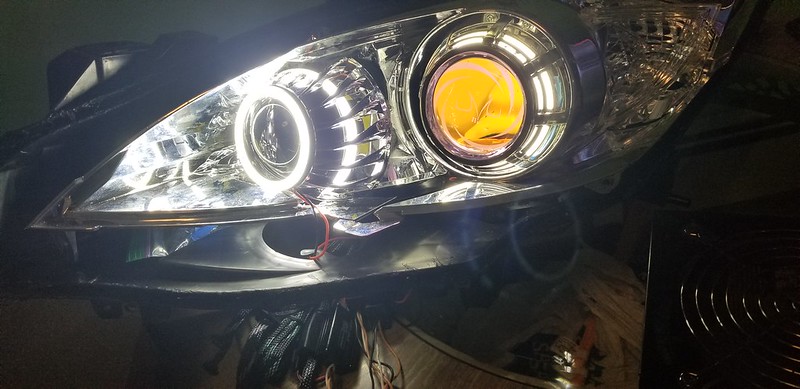

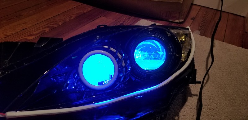

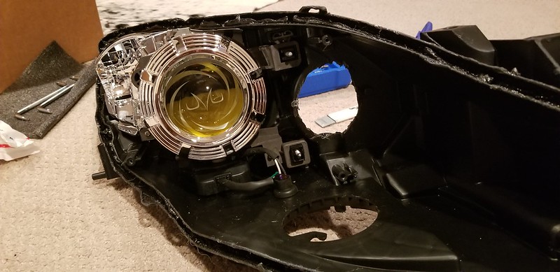

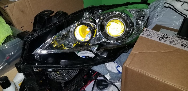

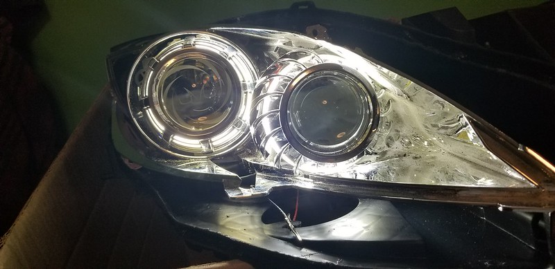

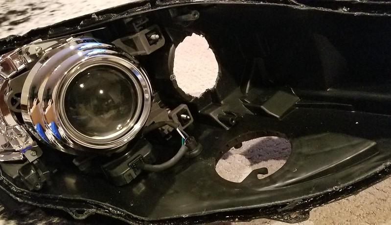

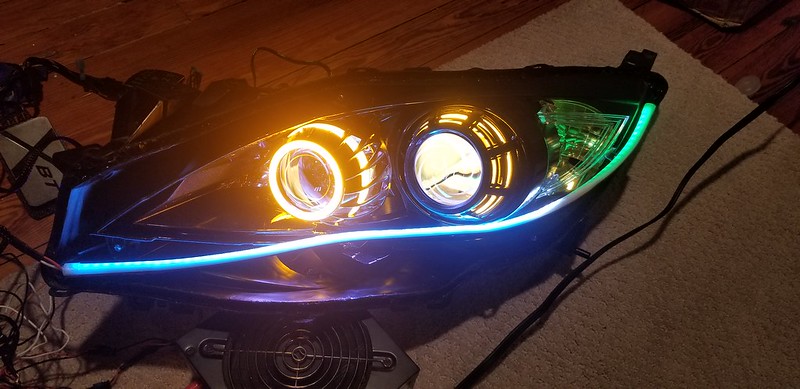

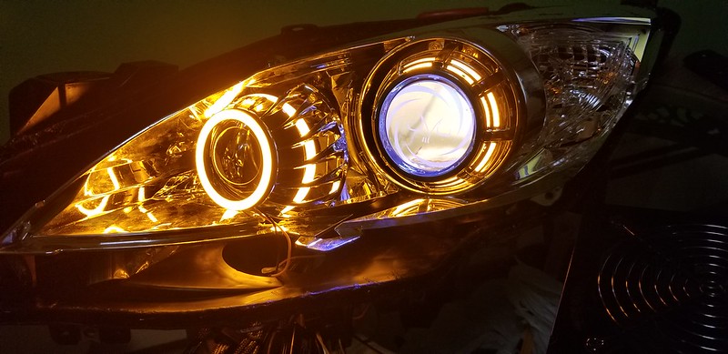

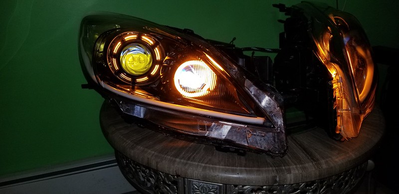

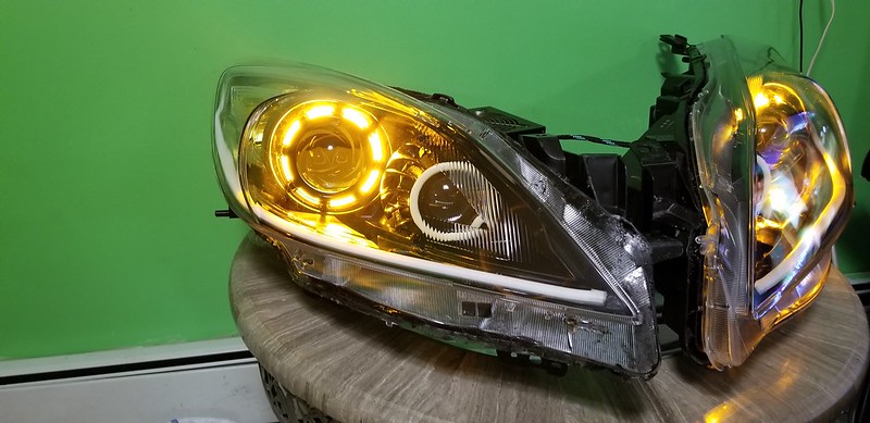

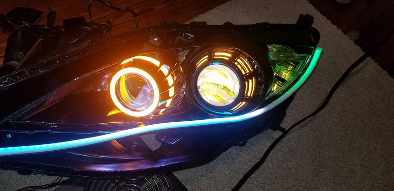

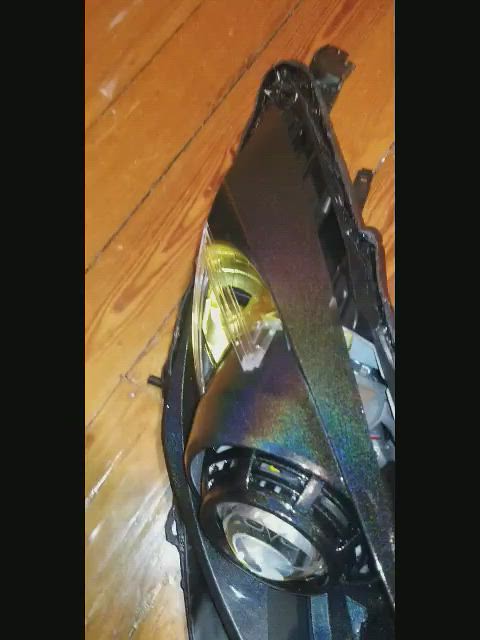

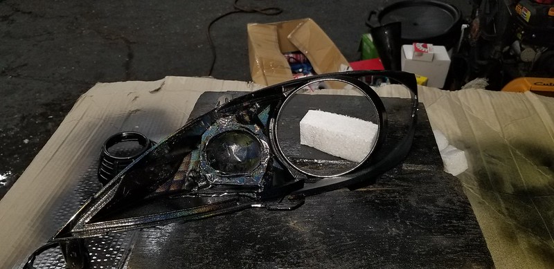

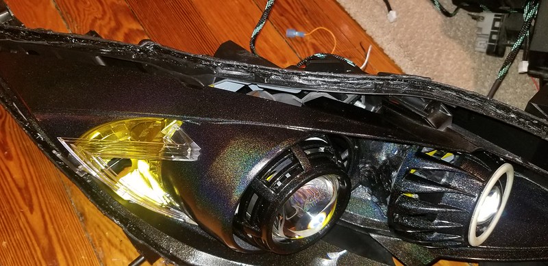

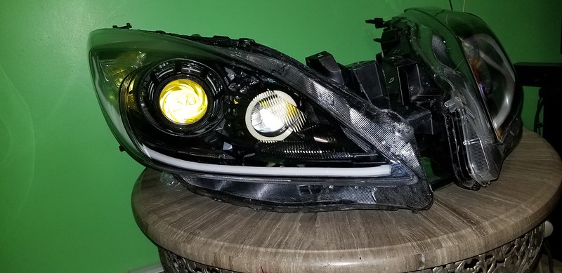

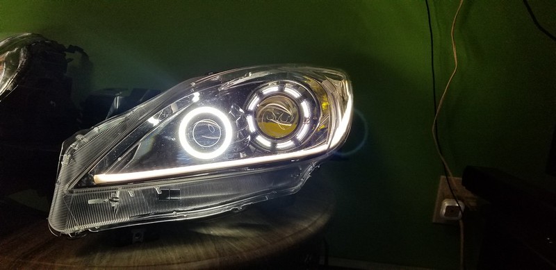

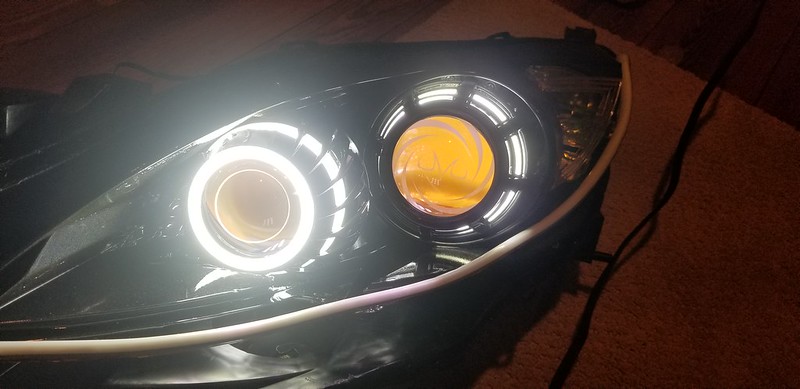

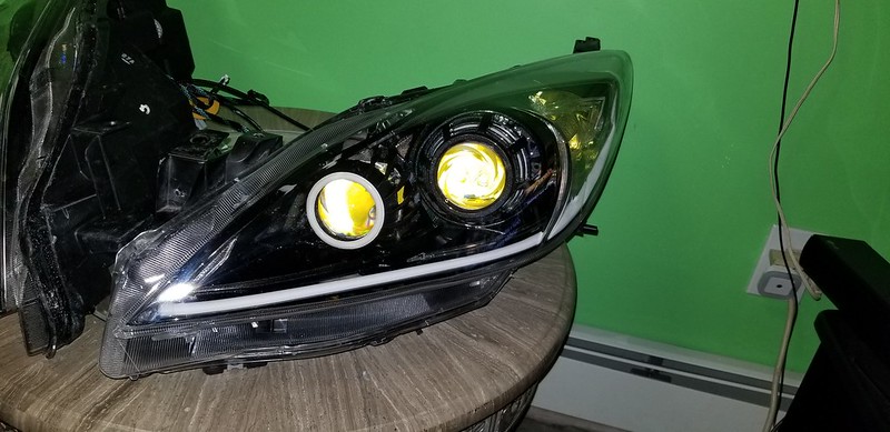

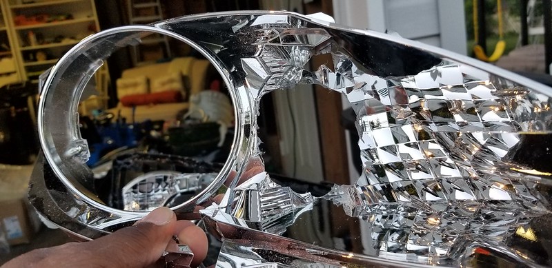

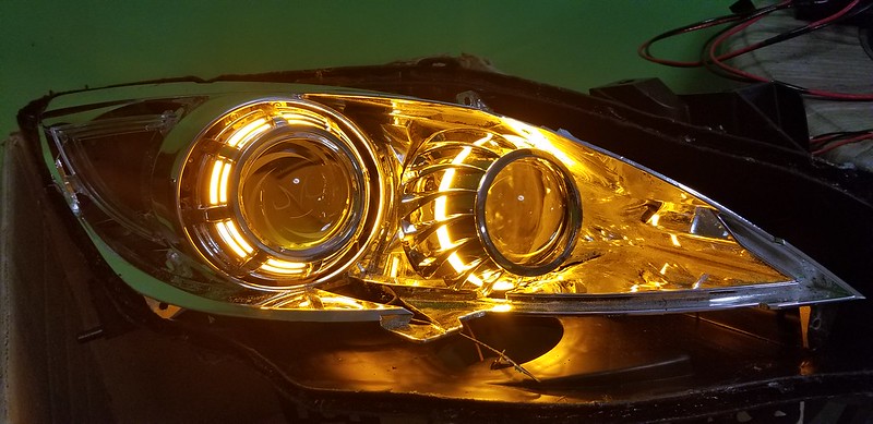

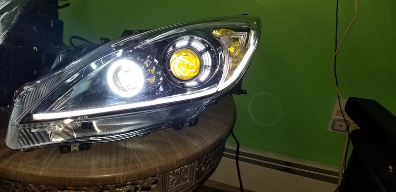

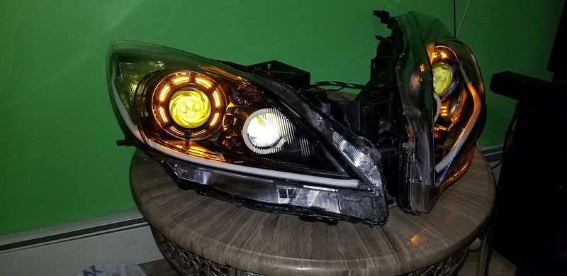

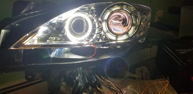

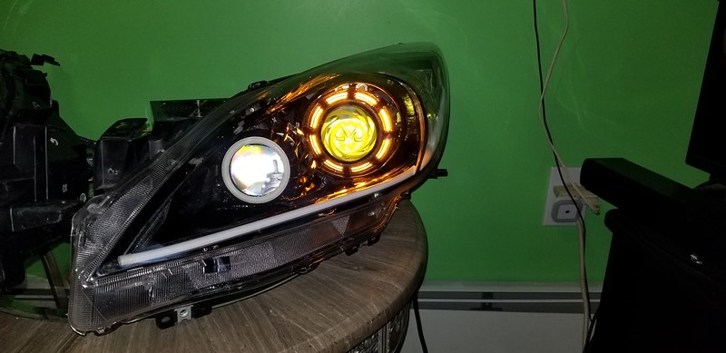

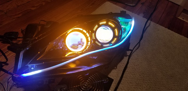

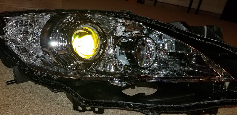

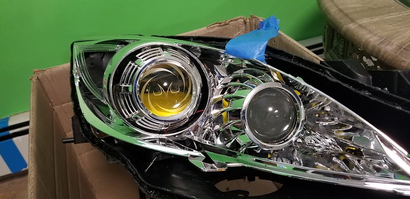

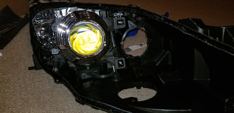

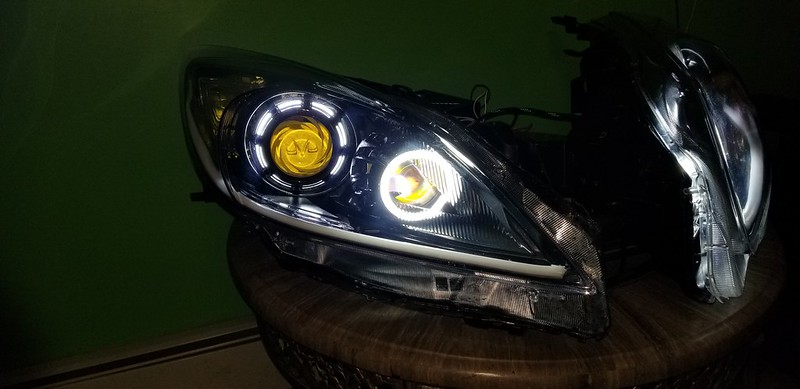

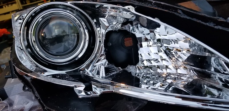

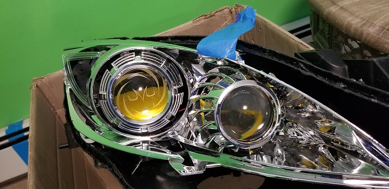

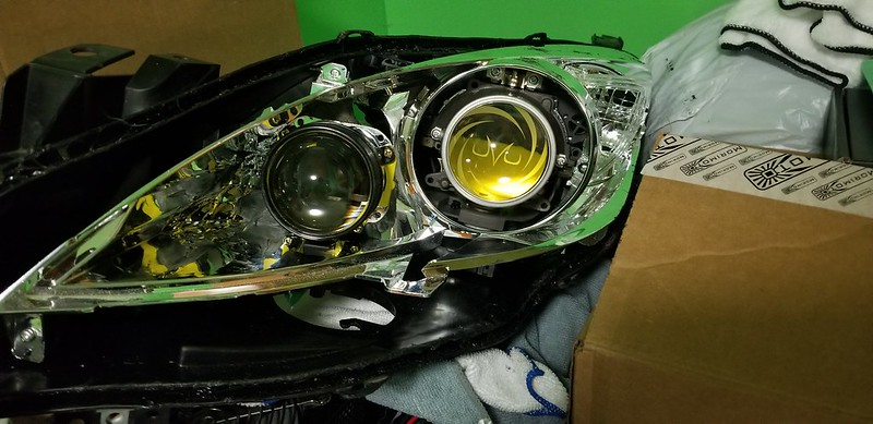

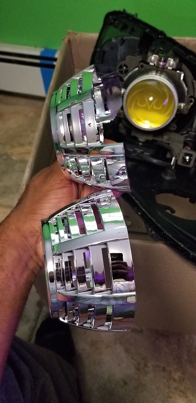

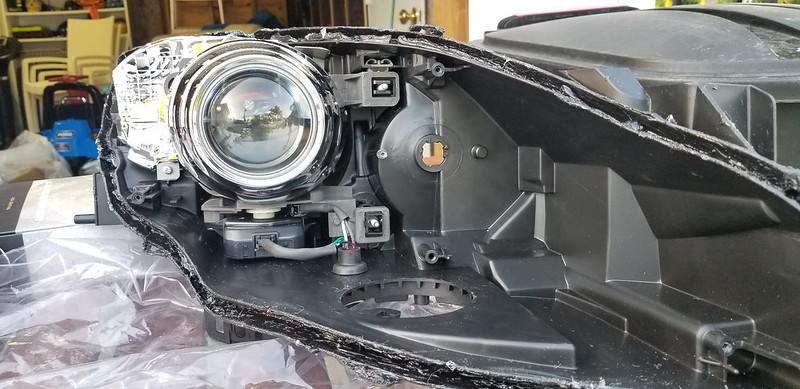

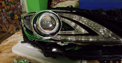

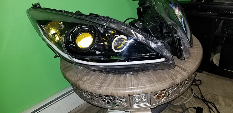

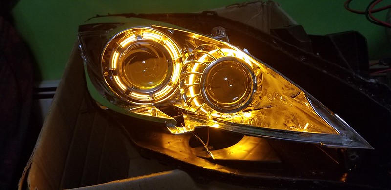

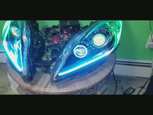

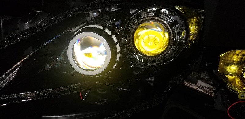

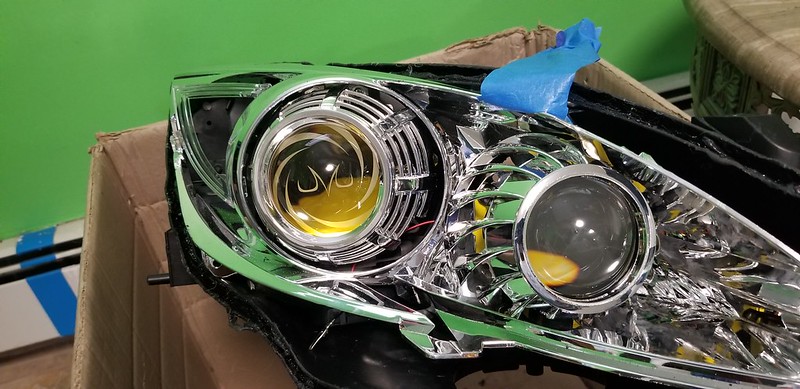

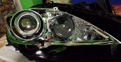

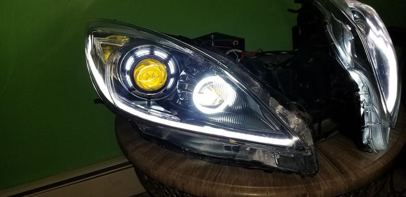

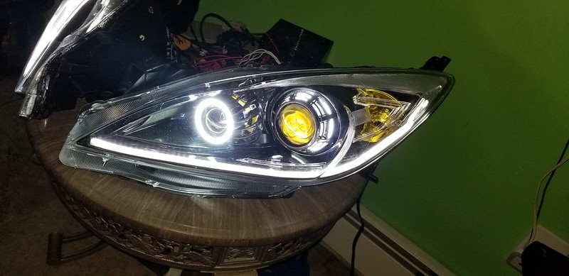

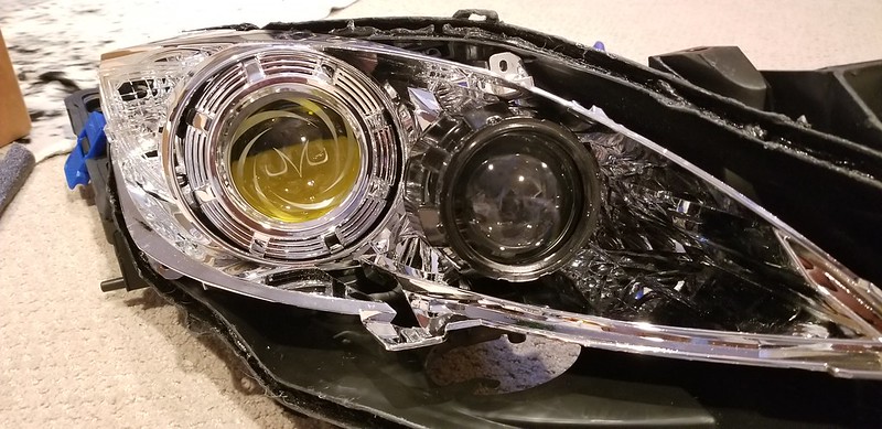

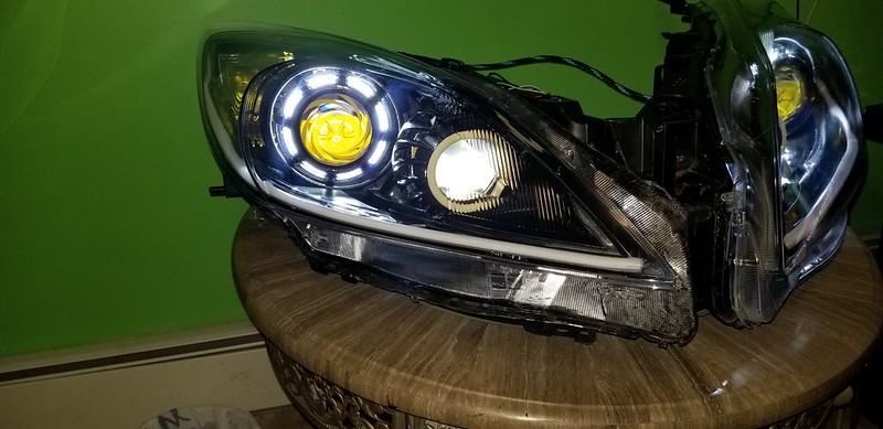

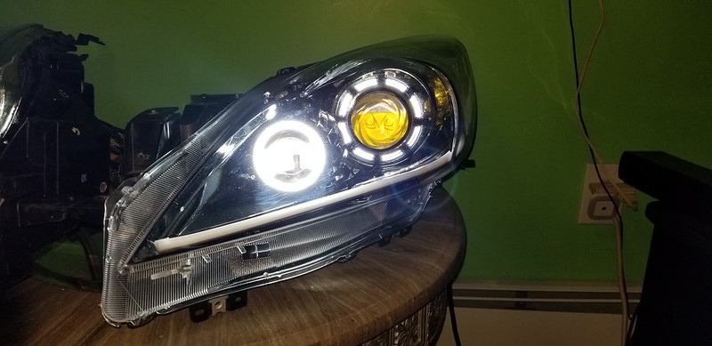

Opened the light and discovered some space there for possibly a second projector.
received_2178948442172722 by stephen martindale, on Flickr
received_436615110474349 by stephen martindale, on Flickr

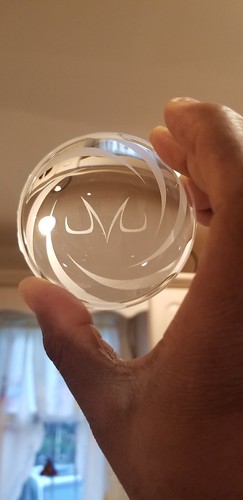

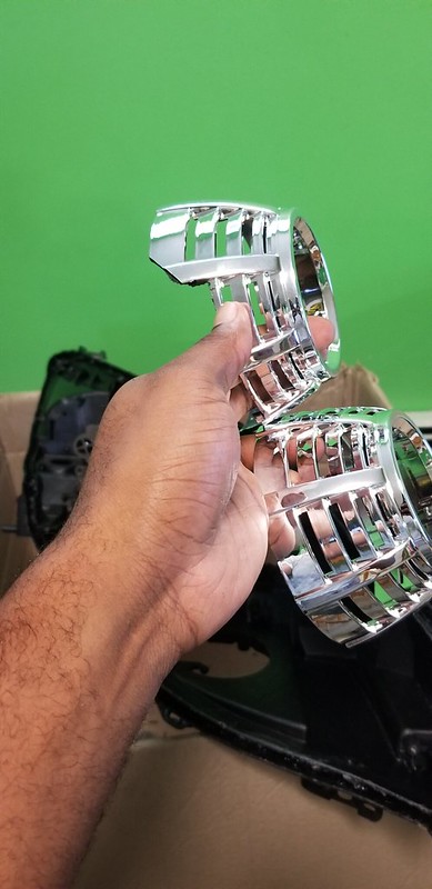

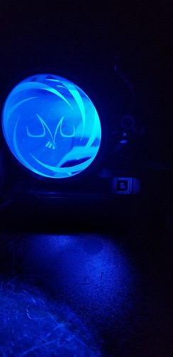

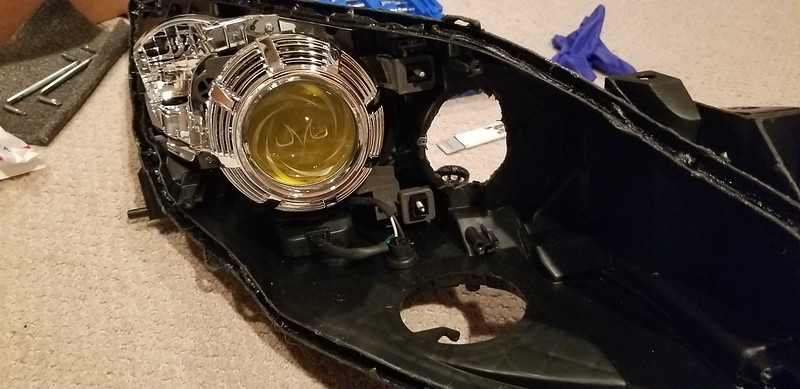

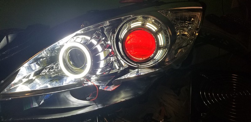

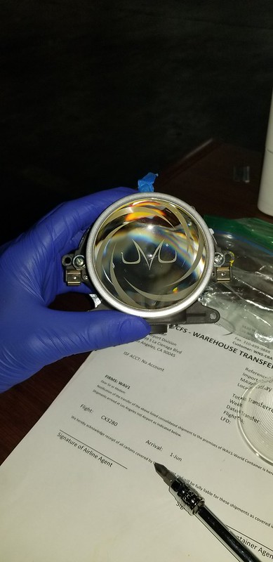

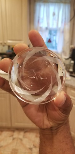

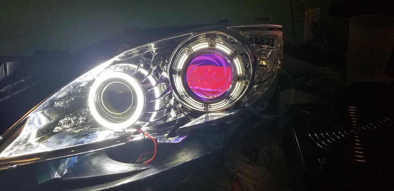

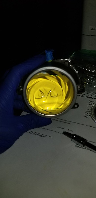

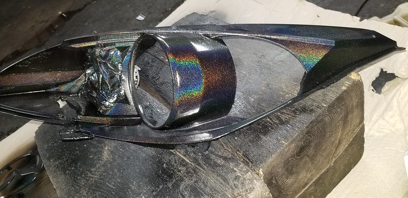

I went on the retrofiitsource.com and got STI-R clear lenses and had this design laser etched
20190513_182039 by stephen martindale, on Flickr
20190513_182018 by stephen martindale, on Flickr

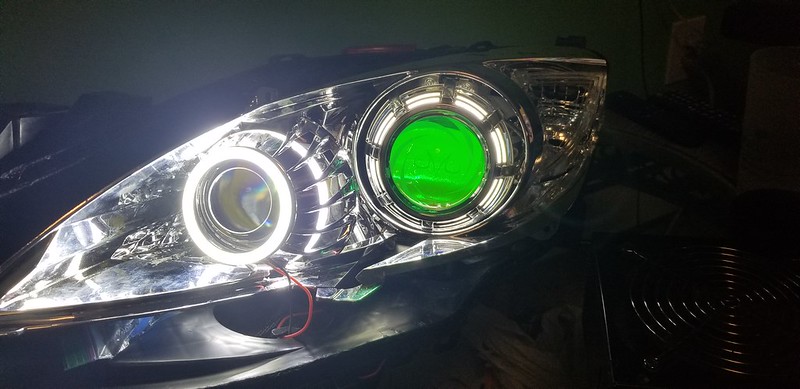

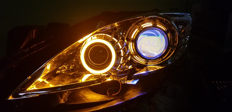

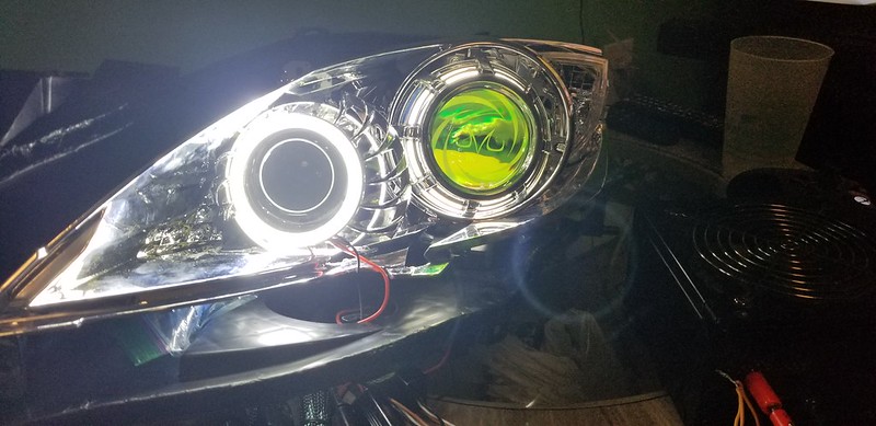

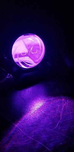

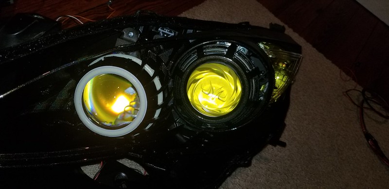

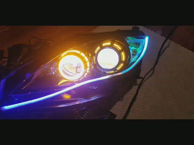

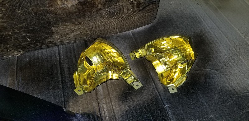

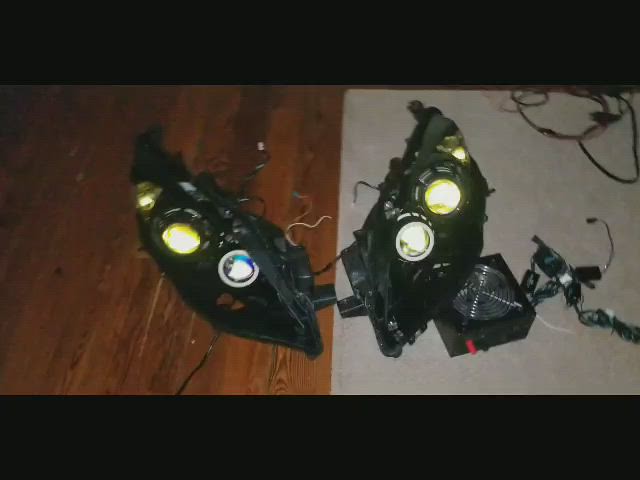

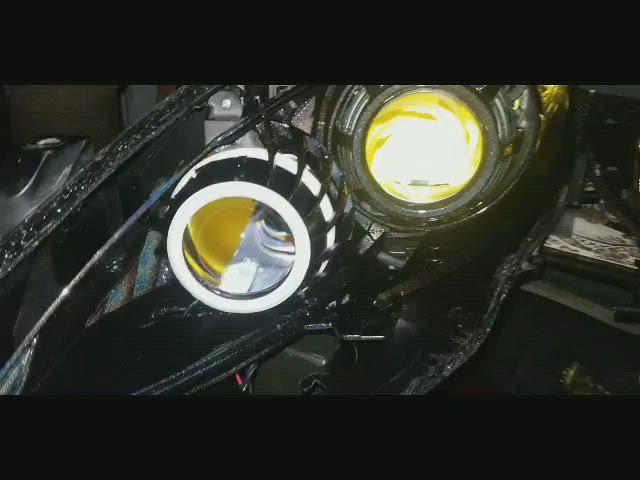

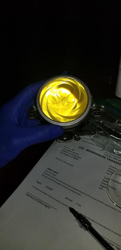

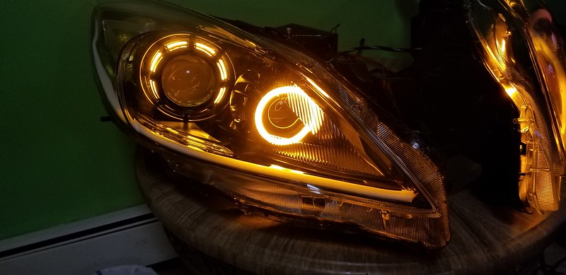

Testing led demon dye mod
20190513_214835 by stephen martindale, on Flickr
20190513_214746 by stephen martindale, on Flickr
20190513_214801 by stephen martindale, on Flickr
20190513_214332 by stephen martindale, on Flickr

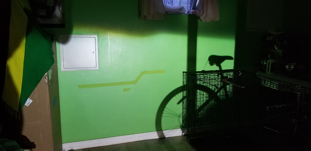

The Majin M is so dope, i cant wait til i finish them, havent had much time, 7 day work weeks between 2 jobs suck!

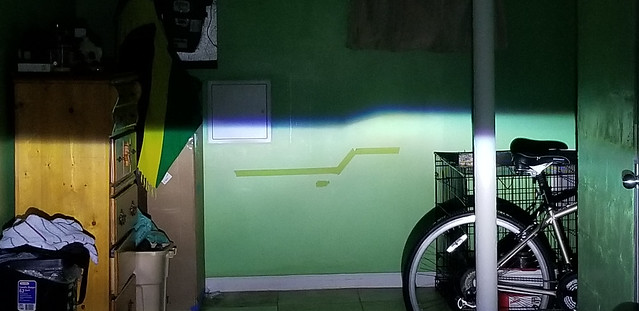

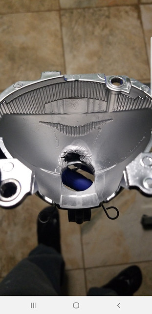

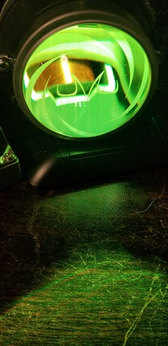

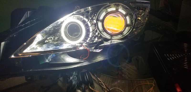

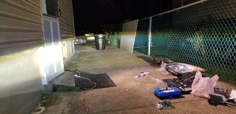

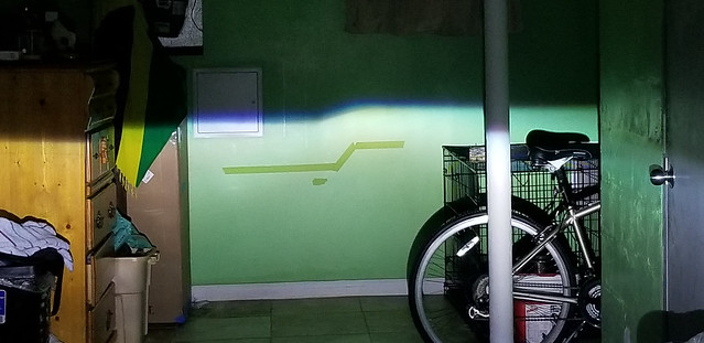

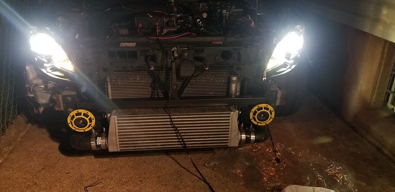

20190513_194744 by stephen martindale, on Flickr
20190513_194114 by stephen martindale, on Flickr
Screenshot_20190517-092550_Messenger by stephen martindale, on Flickr

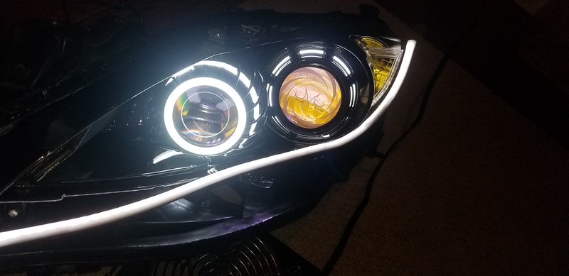

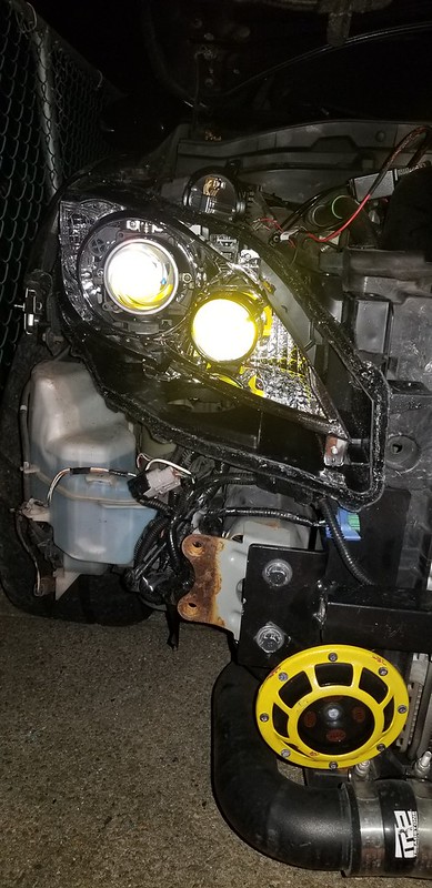

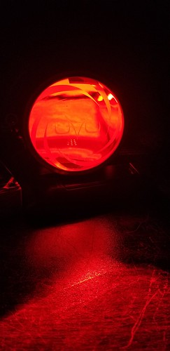

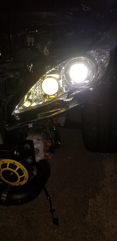

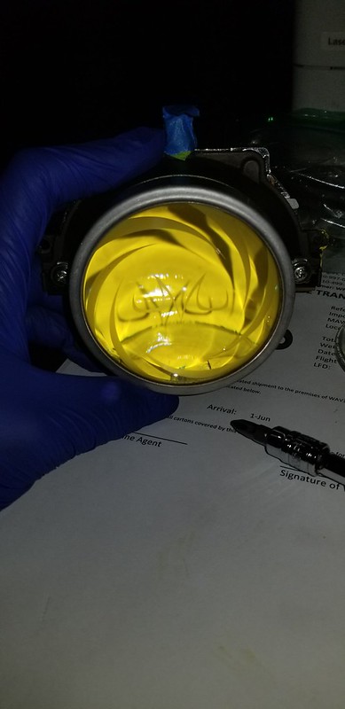

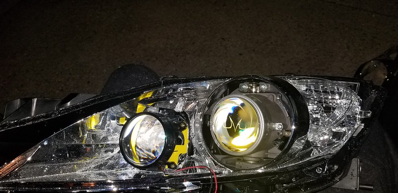

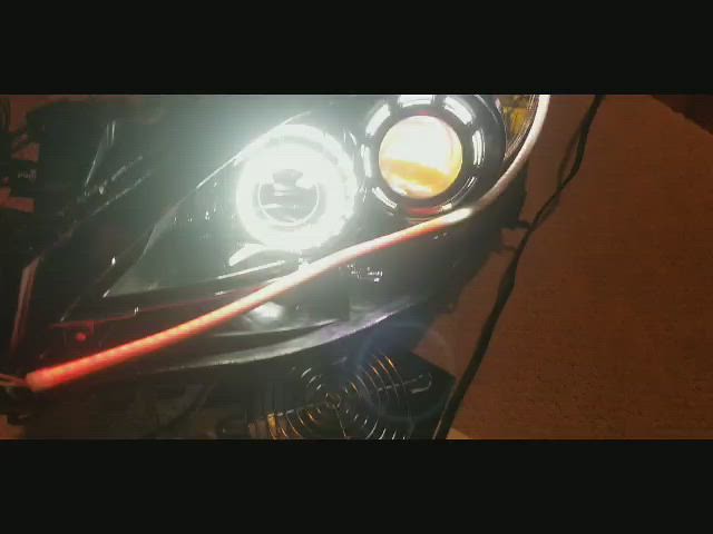

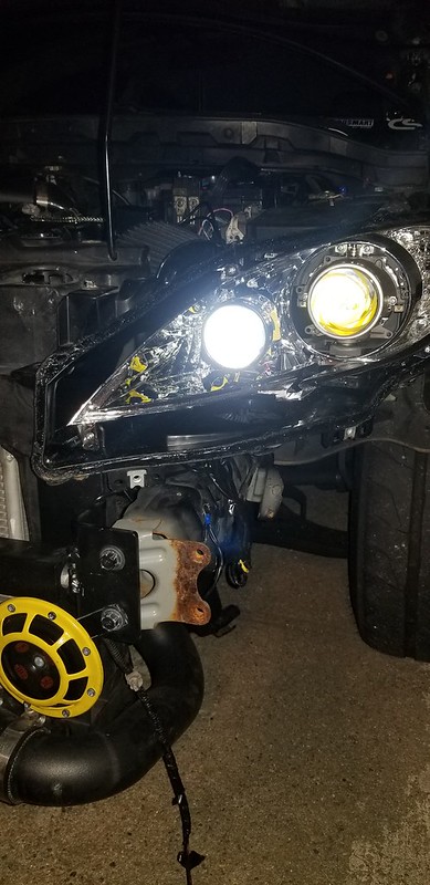

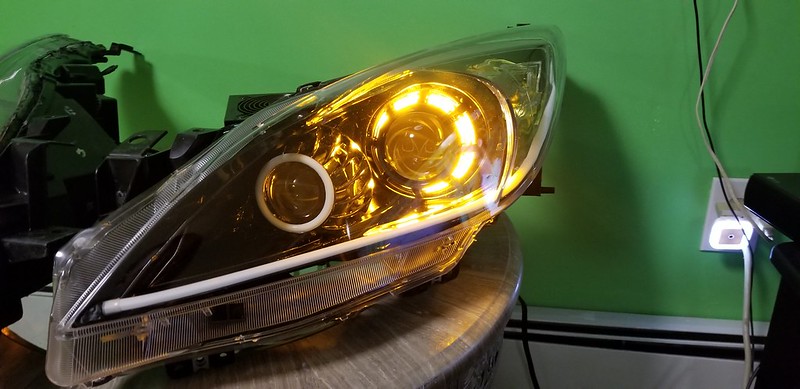

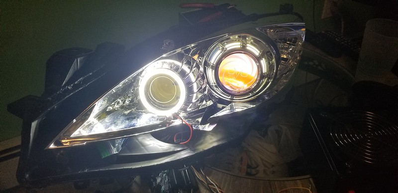

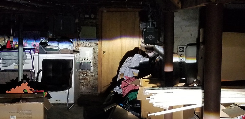

So the above photo shows the projector cut off stock and unmodified. as you can see its a bit blurry with not much color, In the back of the projector, the reflector bowl where the hid light reflects, is dull and burned.
After opening the projector and swapping the reflector bowl with a fresh one, and a bit more tuning, i was able to get a better cut off.
Screenshot_20190517-092554_Messenger by stephen martindale, on Flickr
20190517_010507 by stephen martindale, on Flickr
A much better cutoff
20190517_010508 by stephen martindale, on Flickr.

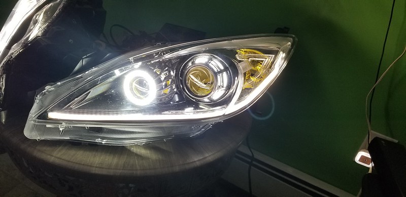

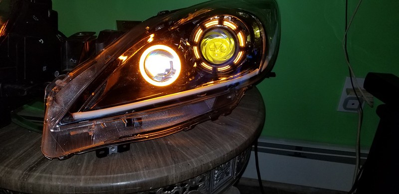

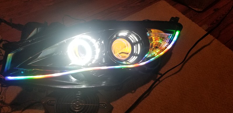

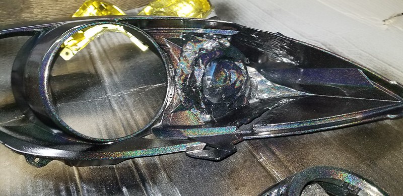

I finally found a better image hosting site that allows me to adjust the picture sizes.

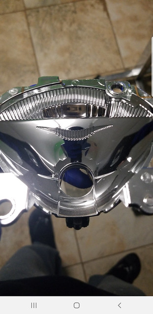

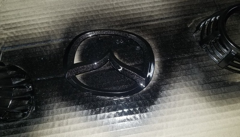

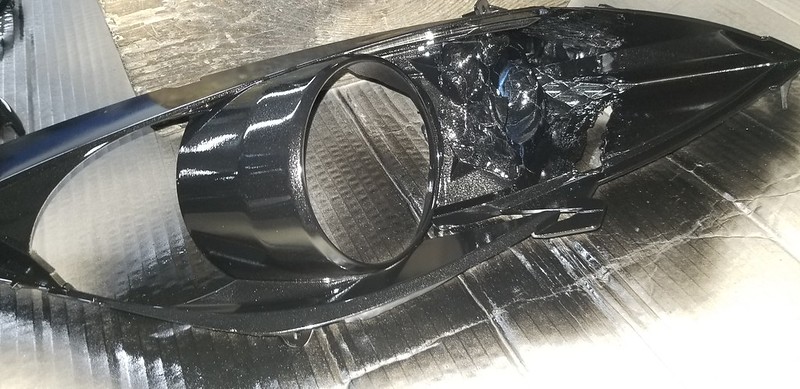

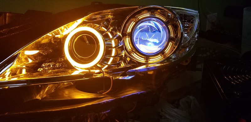

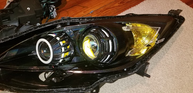

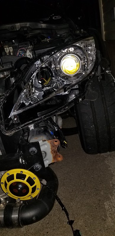

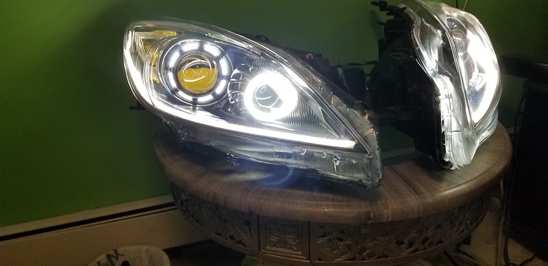

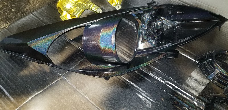

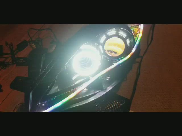

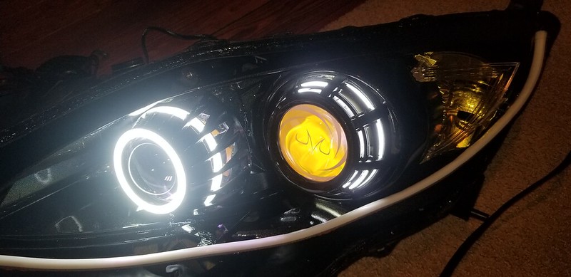

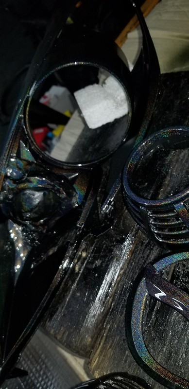

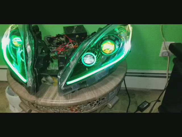

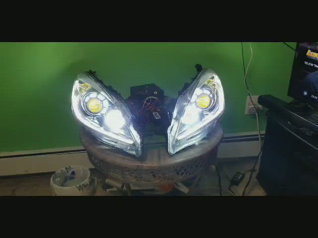

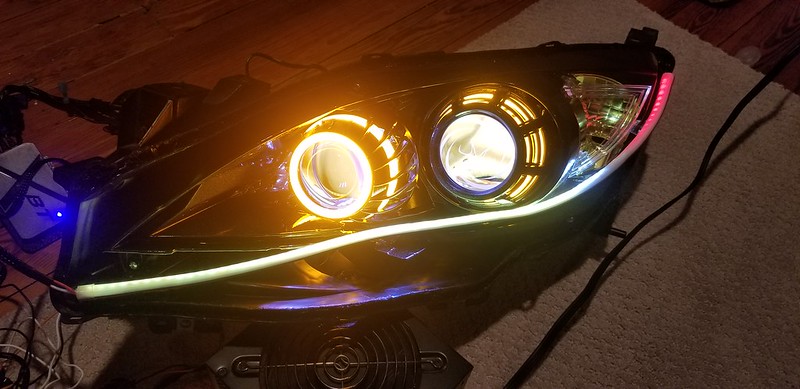

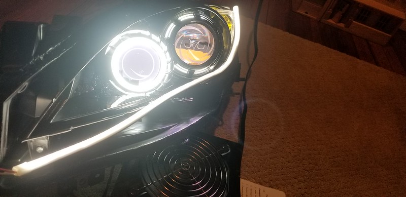

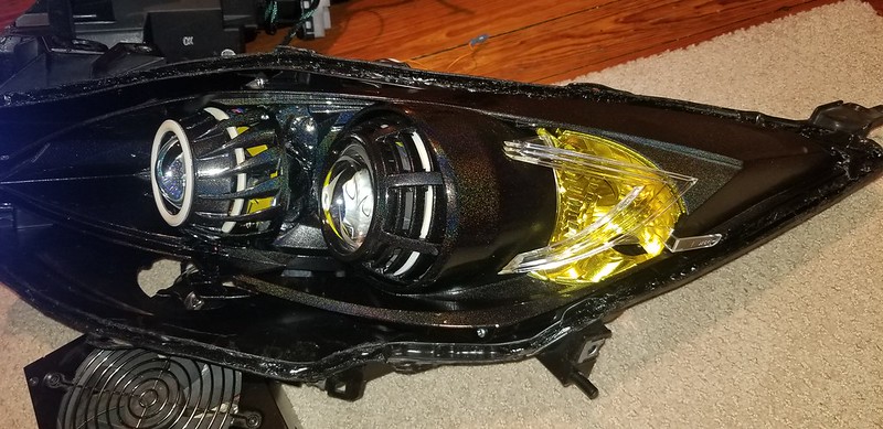

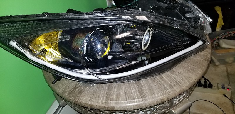

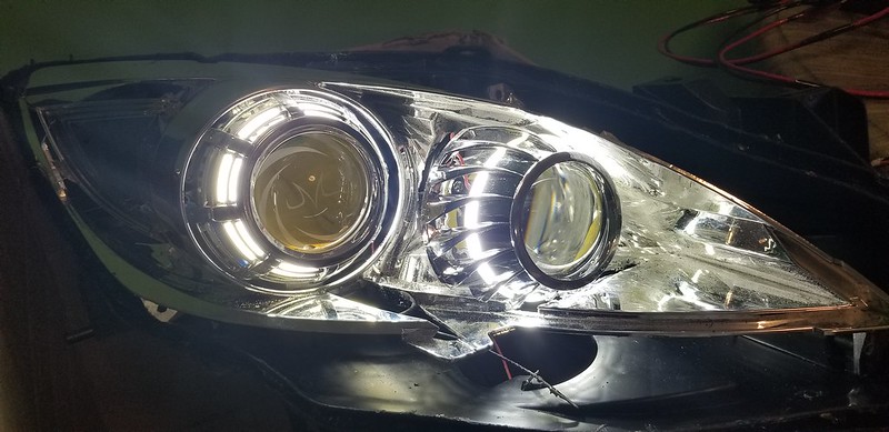

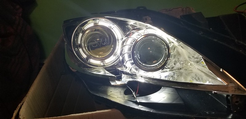

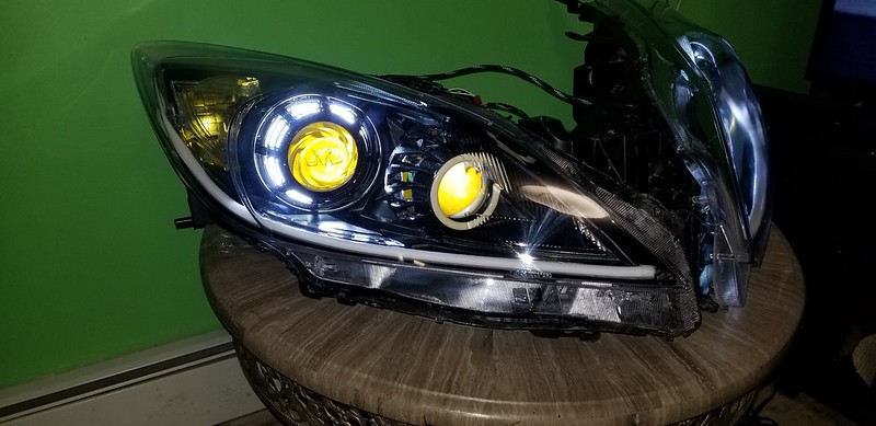

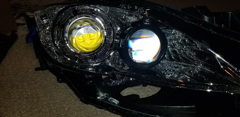

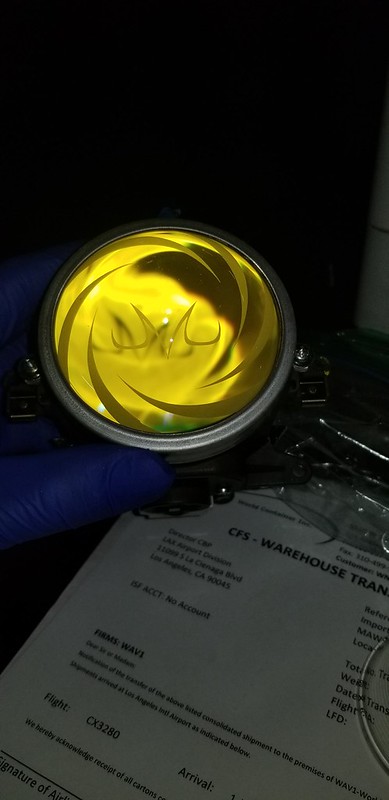

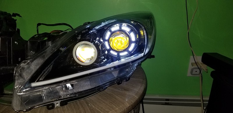

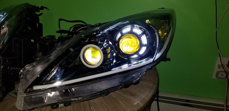

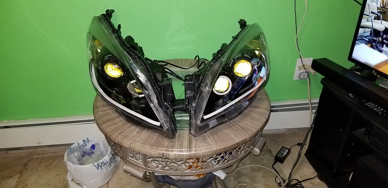

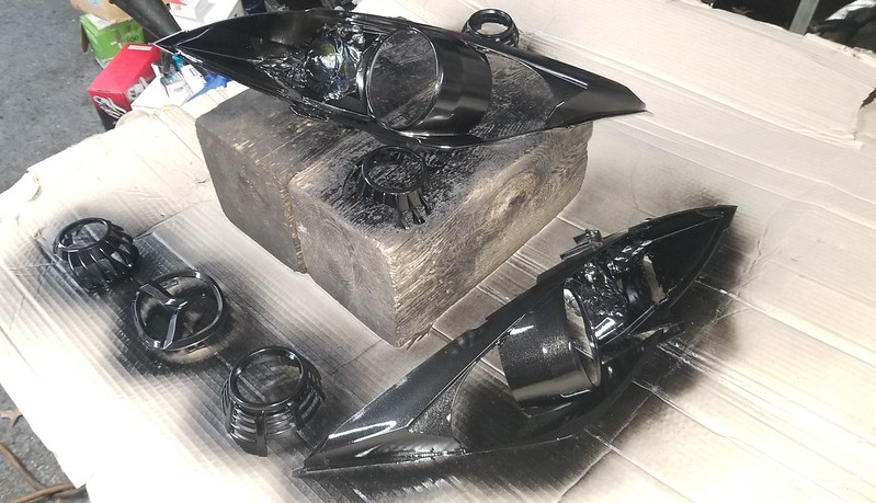

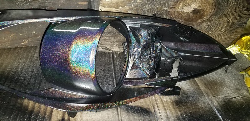

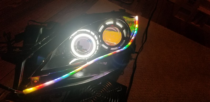

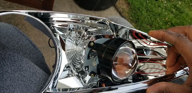

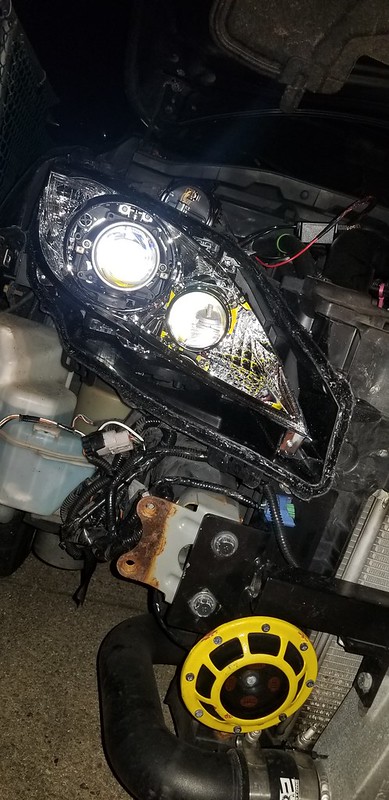

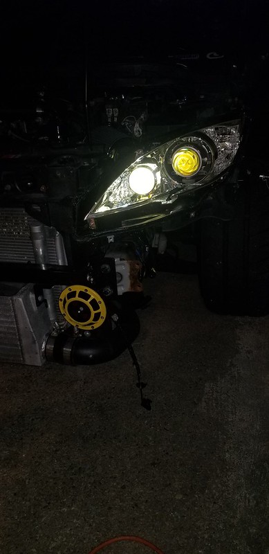

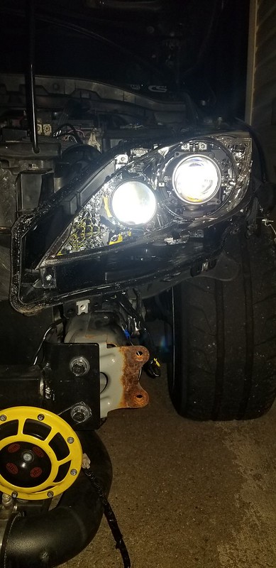

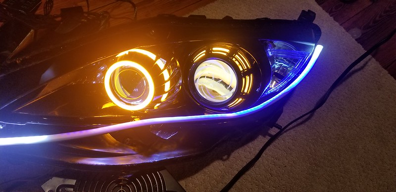

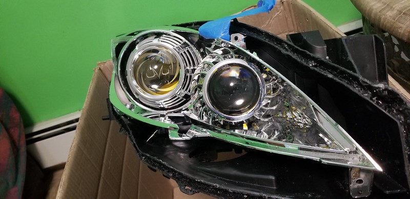

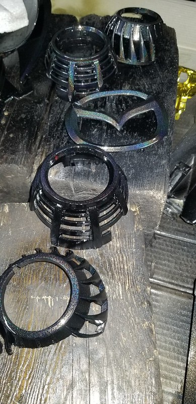

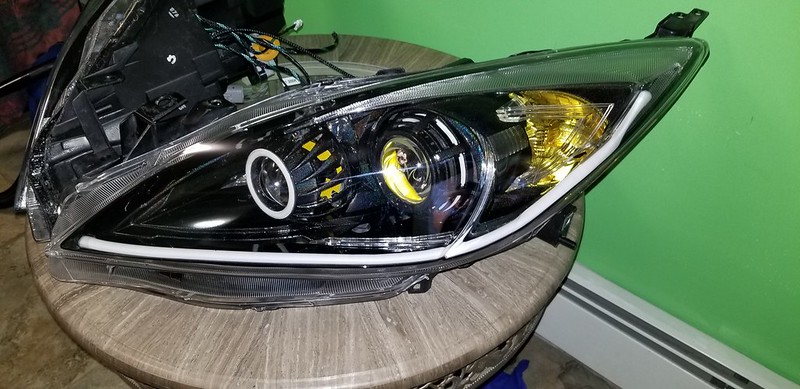

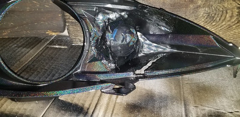

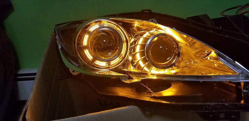

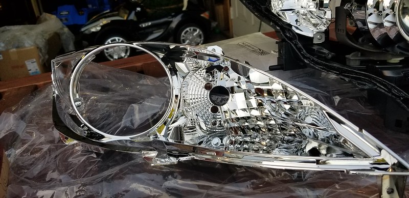

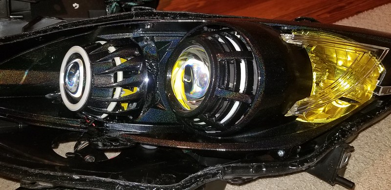

On to more pictures! So i opened the projector again and performed what is called the Passive Demon eye mod. basically you spray a specific portion of the inside of a projector with a color paint of your choosing, and in the day time at the right angle, it gives off the reflective property of that color through the lens!! i chose yellow!!
20190605_151551 by stephen martindale, on Flickr
20190605_151555 by stephen martindale, on Flickr
20190605_151520 by stephen martindale, on Flickr
20190605_151523 by stephen martindale, on Flickr
20190605_151514 by stephen martindale, on Flickr
20190605_151557 by stephen martindale, on Flickr

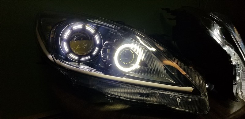

And i did a little bit more tweaking to the projector lens for a sharper cut off, still needs a bit more work.
20190605_233417 by stephen martindale, on Flickr

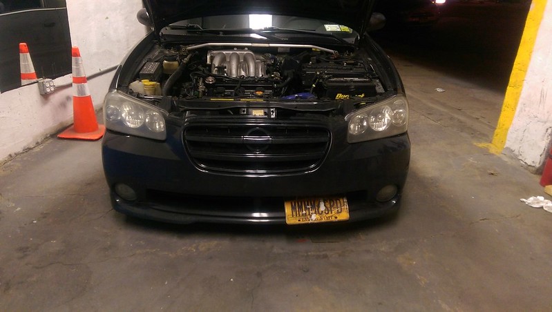

Its hard to say, typically a job like this could take me a couple days to maybe even 2 weekends or so. But as i said before i work 7 days a week and 2 jobs so my time is so limited, its insane!!! like i wanna work on the lights tonight but something else came up. Either tomorrow or sunday im going to attempt to cut and fit the other projector in the DRL.
If the lights come out the way i want and all goes well, i MIGHT provide the service.

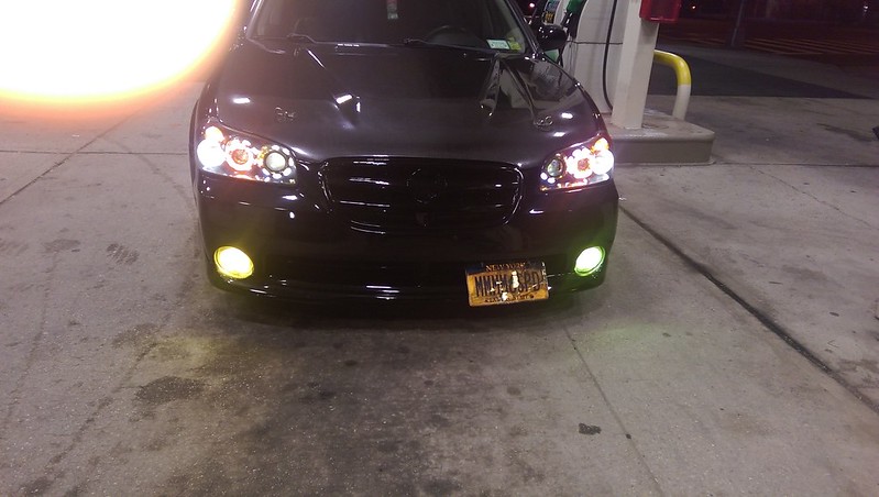

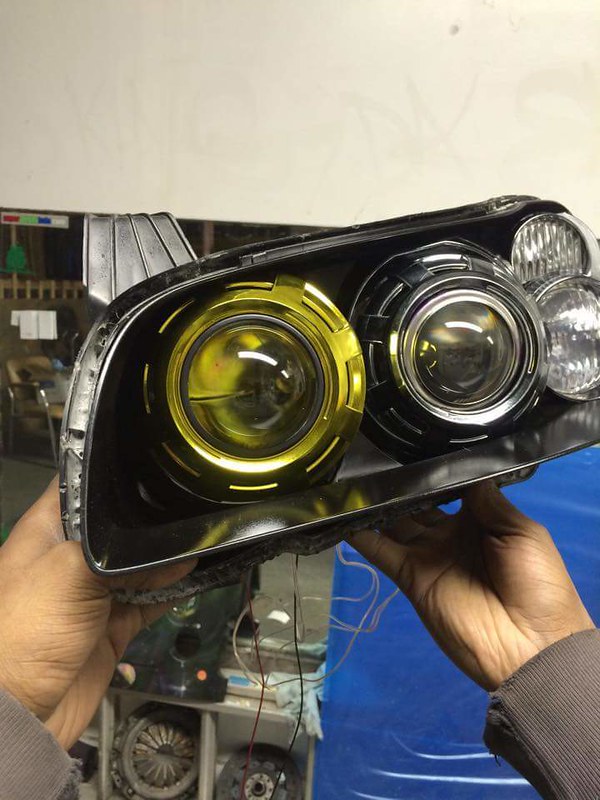

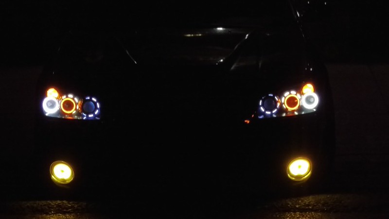

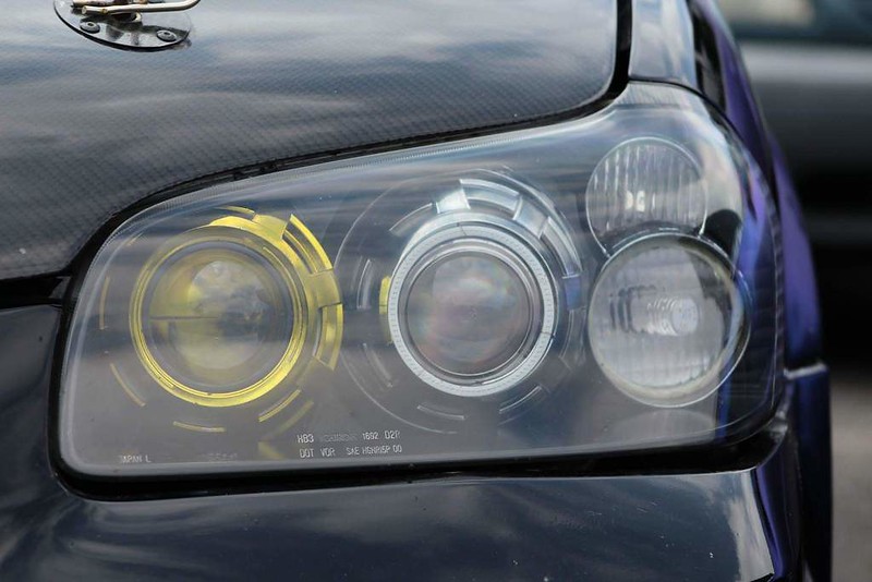

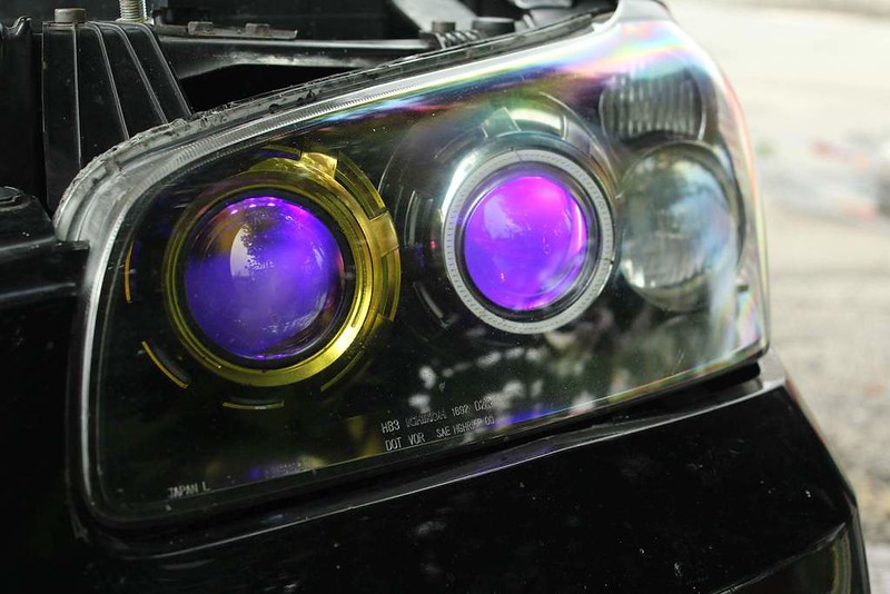

Heres my lights on my old car i did, these took me a month to do, between working 6 days a week at my full time job lol but a buddy of mine helped out.
In reference to how the lights look unmodified:
IMAG4811 by stephen martindale, on Flickr
After:
FB_IMG_1428373102935 by stephen martindale, on Flickr
IMAG0262_1 by stephen martindale, on Flickr
IMAG0264 by stephen martindale, on Flickr
IMAG6383 by stephen martindale, on Flickr
received_10207115304184817 by stephen martindale, on Flickr
received_10207115301904760 by stephen martindale, on Flickr
received_bWVzc2FnZV9ibG9iX2F0dGFjaG1lbnQ6MTA3OTY4O Tk1NTM5MTE3NQ_1 by stephen martindale, on Flickr
MY phone crashed earlier in the year, or i would have posted more of my work.
This is the first time ive done mazda lights so im making my way around them, opening them was a total pain cause i really didnt know where all the hidden screws were but after i found them all opening was easy, so idk ill see. If these come out great, and my time frees up i might offer a limited round of services.

Given that it's a Maxima, those lights really did a number on the car....
Ha thanks man, that was my old baby, that car was no slouch.
It had high compression pistons, 11.1 Wiseco, BC stage 2 cams, ported and polished heads, valves and springs done, 4" intake, 3 exhaust, 3 inch custom y pipe, 560cc GTR injectors, 320 aem pump, 350z haltech with custom PNP harness, the list was endless. that car was like 340+whp 333Ft lbs Tq. that thing was a monster. Low beam projectors were Lexus non AFS projectors, custom tuned, high beams were mini H1 projectors.

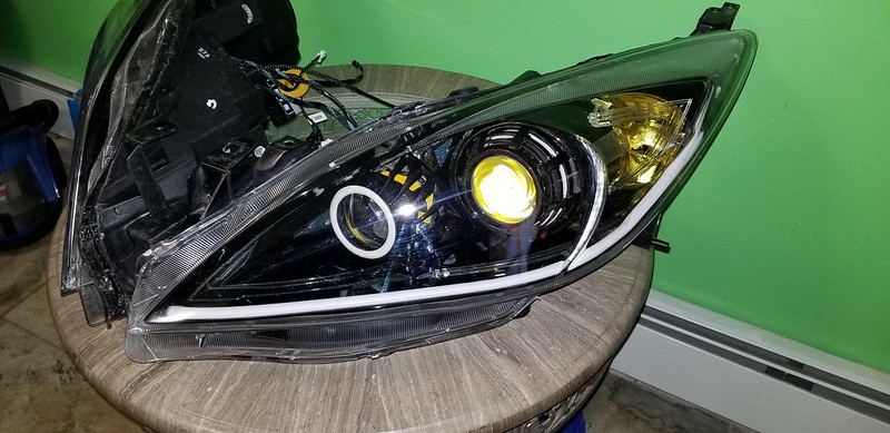

Hello Fellas, back again with a few more updates.
Got a weekend off out of my 7 day work week, and spent a few hours in the garage.
Basically what i did this weekend, is cut up the DRL section to mock fit the mini H1 projector. I also removed the oem stock projector and swapped in the Modded stock projector with trimmed cutoff shield and clear lens for more light, but ill let all the pictures do the talking.
Clintb3astwood is offline   Reply With Quote
 Old 07-08-2019, 10:12 AM   #18
Clintb3astwood's Avatar
Join Date: Dec 2017
Location: NYC/ Long island
Posts: 45   (View Stats)
Rep Power: 32
Clintb3astwood is a glorious beacon of lightClintb3astwood is a glorious beacon of lightClintb3astwood is a glorious beacon of lightClintb3astwood is a glorious beacon of lightClintb3astwood is a glorious beacon of light
Thanks: 11
Thanked 10 Times in 8 Posts
20190707_193537 by stephen martindale, on Flickr
20190707_193541 by stephen martindale, on Flickr
Getting an idea of fitment
20190707_193820 by stephen martindale, on Flickr
cutting begins
20190707_201104 by stephen martindale, on Flickr
20190707_201107 by stephen martindale, on Flickr
HOusing must be trimmed as well,
20190707_233610 by stephen martindale, on Flickr
Swapped modded projector in and test fitted G37-R shroud.
20190708_004755 by stephen martindale, on Flickr
20190708_004813_resized by stephen martindale, on Flickr
20190708_004816_resized by stephen martindale, on Flickr
20190708_005027_resized by stephen martindale, on Flickr
20190708_005032_resized by stephen martindale, on Flickr
20190708_005126_resized by stephen martindale, on Flickr
These are just rough drafts for now of how it should look.
At some point ill start on the driver side light and send updates, next step is to paint inside the H1 projectors yellow, mod the driver side projector, then aim and mount the H1 projectors to make sure they are aligned with the oem projector beam..
End goal is to run all four projectors as low beams, stay tuned!

Hi fellas, its been quite some time since i have had any updates.
But i made some big progress last night. I added the Mini H1 projectors into the DRL section of my tech package headlights and mounted them.
Next step will be cutting the shrouds to fit over the projectors.
20190811_211056 by stephen martindale, on Flickr
20190910_210115 by stephen martindale, on Flickr
20190910_210911 by stephen martindale, on Flickr
20190910_210916 by stephen martindale, on Flickr
20190910_210923 by stephen martindale, on Flickr
20190910_210929 by stephen martindale, on Flickr
20190910_211418 by stephen martindale, on Flickr
20190910_211519 by stephen martindale, on Flickr
20190910_223210 by stephen martindale, on Flickr
i will have more photos tomorrow.

Output shots, once i get more work done and complete the setup ill get better pics.
20190910_223232_resized by stephen martindale, on Flickr
20190910_223913_resized by stephen martindale, on Flickr
The yellow glow is the passive demon eye mod i did, doing its thing =D
20190910_223927_resized by stephen martindale, on Flickr
20190910_223930_resized by stephen martindale, on Flickr
20190910_231236_resized by stephen martindale, on Flickr
20190910_231246_resized by stephen martindale, on Flickr
Hopefully ill have more updates soon!

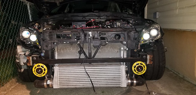

Picture heavy Updates inbound
20190930_114846 by stephen martindale, on Flickr
20190930_114850 by stephen martindale, on Flickr
20190930_114859 by stephen martindale, on Flickr
20190930_114904 by stephen martindale, on Flickr
20190930_115016 by stephen martindale, on Flickr
20190930_115023 by stephen martindale, on Flickr
20190930_130533 by stephen martindale, on Flickr
20190930_130538 by stephen martindale, on Flickr
20190930_130545 by stephen martindale, on Flickr

Switch back amber function
20190930_130628 by stephen martindale, on Flickr
20190930_130632 by stephen martindale, on Flickr
20190930_130635 by stephen martindale, on Flickr

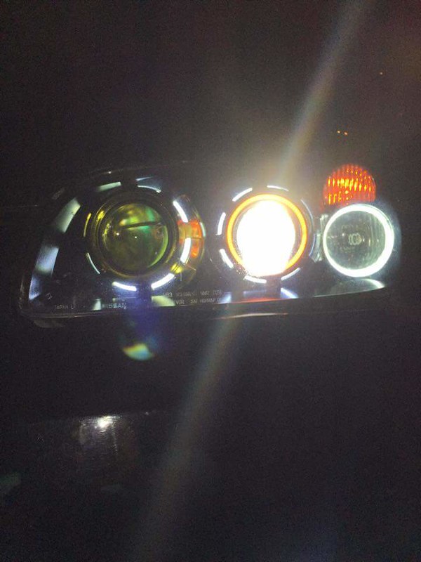

White halos with TRS demon eyes a Glow
20190930_224117 by stephen martindale, on Flickr
20190930_224120 by stephen martindale, on Flickr
20190930_224125 by stephen martindale, on Flickr
20190930_224127 by stephen martindale, on Flickr
20190930_224151 by stephen martindale, on Flickr
20190930_224154 by stephen martindale, on Flickr
20190930_224157 by stephen martindale, on Flickr
20190930_224336 by stephen martindale, on Flickr
20190930_224352 by stephen martindale, on Flickr
20190930_224406 by stephen martindale, on Flickr
20190930_224422 by stephen martindale, on Flickr
Hopefully the next update will be all demon eyes installed, chrome stripped and ready for paint. This is just a rough draft, ignore the imperfections, they will be repaired with quick steel, sanded smoothed, and prepped for paint as well.

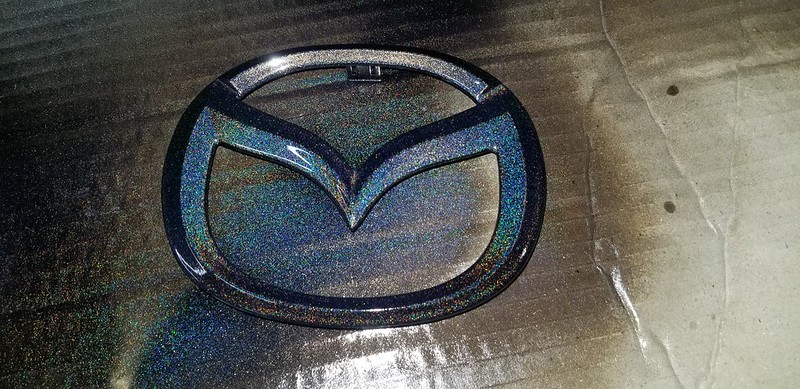

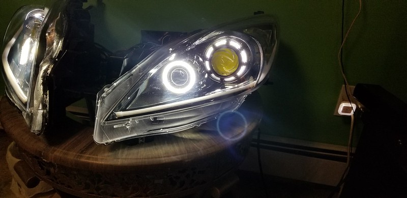

Sooooo a month an some days later, i have another update of the work ive done on these lights.
Excited to say im 90% complete, just assembling lights and running wires after prep work and painting. ill let the work speak for itself, picture and video heavy!!
I did clear clear primer followed by 1K Black metallic flake paint, followed by colorshfit clear coat and a final 2K clear Coat.
20191110_171000_resized by stephen martindale, on Flickr
20191110_171008_resized by stephen martindale, on Flickr
20191110_171042_resized by stephen martindale, on Flickr
20191110_195550_resized by stephen martindale, on Flickr
20191110_195554 by stephen martindale, on Flickr
20191110_195600 by stephen martindale, on Flickr
20191110_195603 by stephen martindale, on Flickr
Dupicolor metalcast yellow for the turn signal housings with a splash of color shift clear
20191110_195606 by stephen martindale, on Flickr
20191110_195622 by stephen martindale, on Flickr
20191110_210209 by stephen martindale, on Flickr
20191110_210217 by stephen martindale, on Flickr
Dont mind the cutting and ugliness, it had to be done to fit the halo that will sit behind this the projector shroud. JB quik and paint camo'd it a bit.
20191110_210225 by stephen martindale, on Flickr
20191110_210228 by stephen martindale, on Flickr
20191112_011902 by stephen martindale, on Flickr
20191112_012717 by stephen martindale, on Flickr
20191112_012726 by stephen martindale, on Flickr
20191112_012733 by stephen martindale, on Flickr
20191112_012740 by stephen martindale, on Flickr
20191112_012746 by stephen martindale, on Flickr
Demon eye test
20191112_015110 by stephen martindale, on Flickr
20191112_015125 by stephen martindale, on Flickr
20191112_020117 by stephen martindale, on Flickr

Color chasing Led strip test with Turn signal Orange.
20191112_020921 by stephen martindale, on Flickr
20191112_020923 by stephen martindale, on Flickr
20191112_020924 by stephen martindale, on Flickr
20191112_020926 by stephen martindale, on Flickr
20191112_020953 by stephen martindale, on Flickr
20191112_020957 by stephen martindale, on Flickr

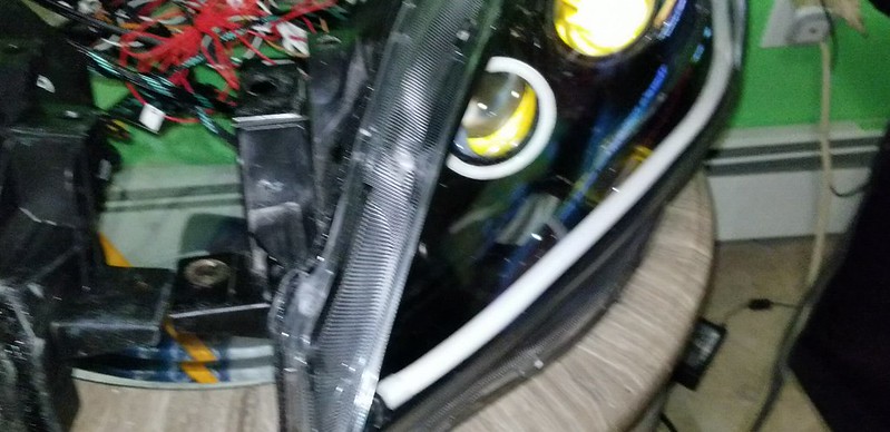

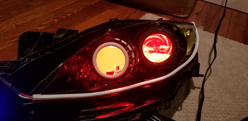

Alright Ladies and gents, i added the color chasing strips and partially put the lenses on to see how they look "closed". ill let the pics speak for themselves!
Wires in the back have been ran, just need to seal things up in the back, close headlights and swap headlight harnesses and hids on to these lights then i can install on the car, 99% done!
20191120_025310_resized by stephen martindale, on Flickr
20191120_025315_resized by stephen martindale, on Flickr
20191120_025319_resized by stephen martindale, on Flickr
20191120_025326_resized by stephen martindale, on Flickr
20191120_025330_resized by stephen martindale, on Flickr
Yellow Passive demon eye mod inside.
20191120_025511_resized by stephen martindale, on Flickr
20191120_025521_resized by stephen martindale, on Flickr
Low Beam Halo Test,
20191120_030212_resized by stephen martindale, on Flickr
20191120_030215_resized by stephen martindale, on Flickr
20191120_030228_resized by stephen martindale, on Flickr
20191120_030234_resized by stephen martindale, on Flickr
Low beam turn signal switchback function test.
20191120_030421_resized by stephen martindale, on Flickr
20191120_030424_resized by stephen martindale, on Flickr
20191120_030433_resized by stephen martindale, on Flickr
20191120_030436_resized by stephen martindale, on Flickr
All Halos tested, the halos in the rear on the second set of projectors in the rear had to be removed, the wouldnt fit with the shroud on, so im just running one up front and the other in the low beam section.
20191120_030638_resized by stephen martindale, on Flickr
20191120_030642_resized by stephen martindale, on Flickr
20191120_030648_resized by stephen martindale, on Flickr
20191120_030652_resized by stephen martindale, on Flickr
20191120_030759_resized by stephen martindale, on Flickr
20191120_030803_resized by stephen martindale, on Flickr
20191120_030811_resized by stephen martindale, on Flickr
20191120_030815_resized by stephen martindale, on Flickr
Halos AND Strips on
20191120_031458_resized by stephen martindale, on Flickr
20191120_031503_resized by stephen martindale, on Flickr
20191120_031509_resized by stephen martindale, on Flickr
20191120_031516_resized by stephen martindale, on Flickr
20191120_031548_resized by stephen martindale, on Flickr
20191120_031602_resized by stephen martindale, on Flickr
VIDEOS BELOW, Click on them!
Switch back amber Led strip intro, the strips can be customized to switch back in many different functions and speeds etc, this is just one of a few examples in the video.
20191120_031850 (1) by stephen martindale, on Flickr
Brightness test
20191120_135952_14027502399908 by stephen martindale, on Flickr
Color Chasing test, hundreds of different combos and settings for these strips! ITs being controlled by the Ghozt lighting module and an app on my phone by Ghozt lighting
20191120_140133_14128159163463 by stephen martindale, on Flickr
20191120_140153_14148852558195 by stephen martindale, on Flickr
Hope you all enjoyed this build, last update will be them sealed up and on the car, hopefully before the end of the month! Comments are welcome!
MATTBSBL likes this.
Last edited by Clintb3astwood; 11-20-2019 at 03:11 PM. Reason: Link File errors, was making corrections.
