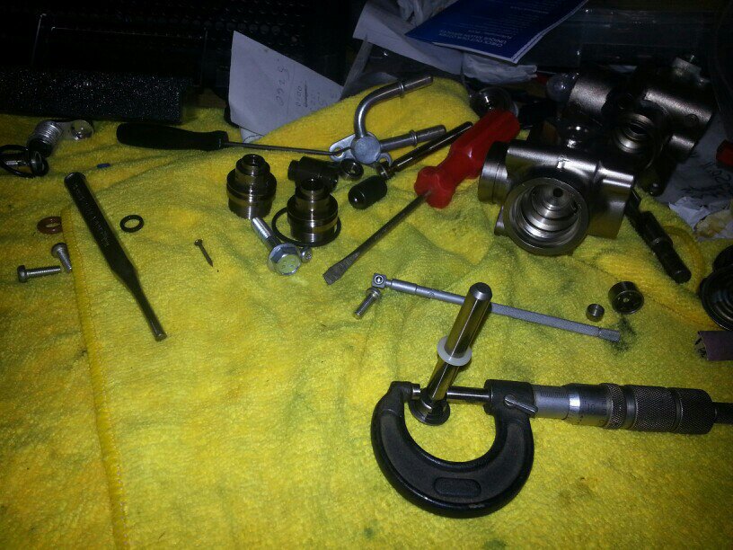

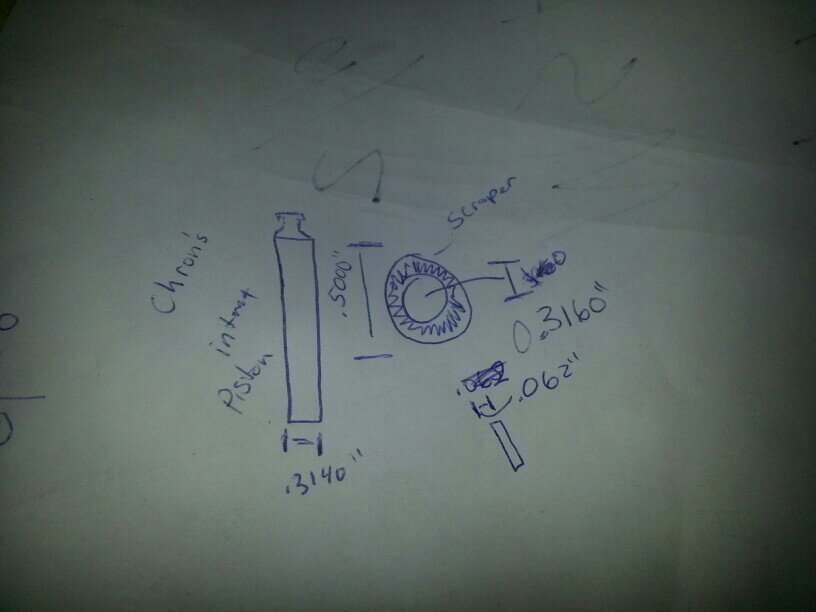

Well it is officially time for the next phase in our seemingly ever-going E85 project. This thread is going to focus mainly on hardware solutions.
Here are the possible hardware fixes I have been contemplating. Please feel free to suggest ideas; I will add them to the list if I feel that they are a plausible solution that I am willing to attempt.
1.)Affix a spring directly to the Solenoid needle and to the push button assembly
2.)Mill out our metal fastener in the HPFP and install an oil scraper and PTFE shaft seals
3.)Mill Spill valve Collar and install a PTFE Washer
4.)Route the bleed off Fuel back to tank for cooler operation

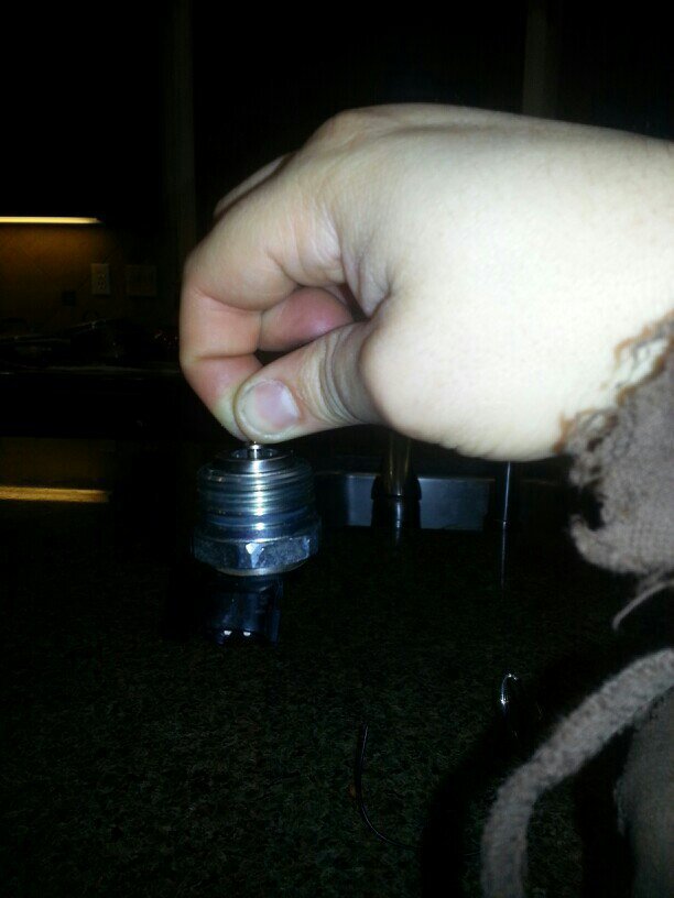

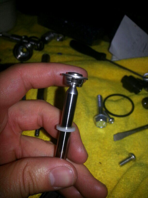

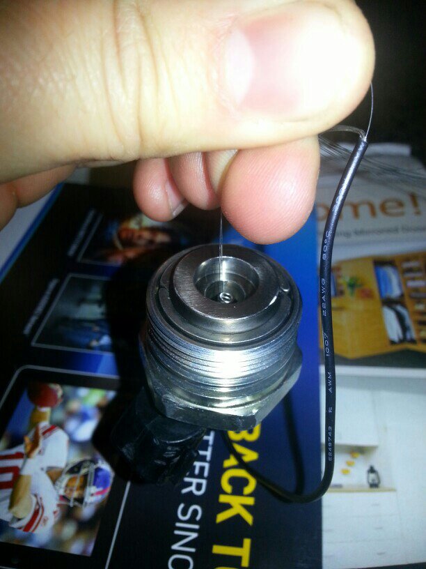

Here is some pictures of the springs being crimped to the Solenoid and to the push button needle
Theoretically speaking...
As the solenoid energizes it will have enough power to pull the needle up, and when it is not energized it will push it back down regardless of gummy residue.
I installed this modified SV assembly in my pump last week and it holds pressure fine. I have had 178 Miles of sticky free operation thus far. and I am feeling pretty good about this simple yet affective Modification.
Thoughts or Comments?

For #1 , again I don't personally think you really need to affix the spring to the top part of the solenoid, just the spring to the needle should suffice; the magnetic force should yank that fucker right up anyways.
As for the button, the spill valve spring mod should be plenty, considering it's probably damn close to 10x the force of the stock spring.
Otherwise, fingers are crossed.
Yes I agree, I will start modding another spill valve with the same mod, except I will not be attaching the spring to the solenoid. I will also be securing the spring to the needle in a more permanent manor. But I want to run another 200miles or until it sticks before changing the spill valve out.

Here is a peek of progress towards the scraper project. This is the oil scraper I am thinking about using to scrape the oil off the piston. I am using the same design I used when I sealed my RC car shocks. O-rings on both sides, scraper in the middle.
