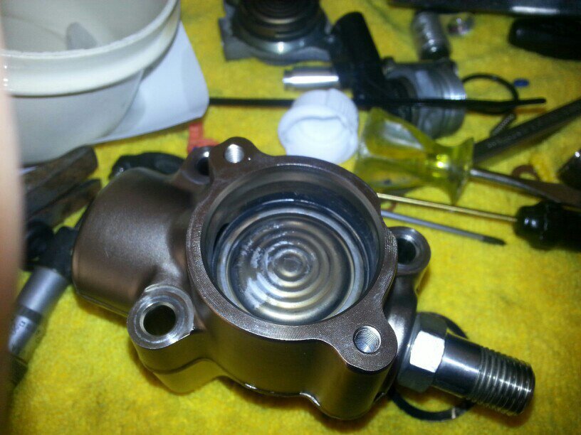

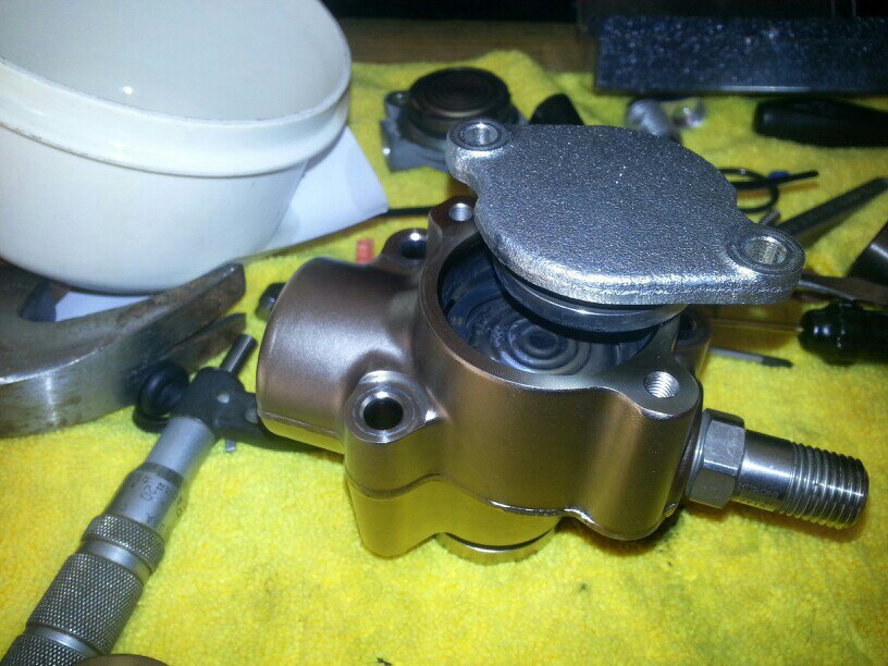

 Old 02-22-2014, 05:59 PM   #77
littleloogy's Avatar
Location: Ripon, CA
Posts: 4,005   (View Stats)
Rep Power: 2958
Thanks: 4,390

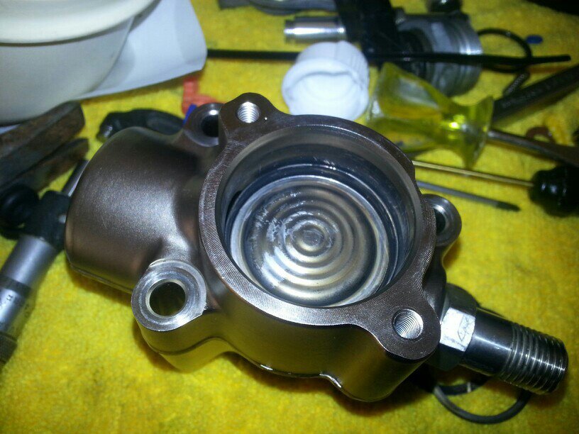

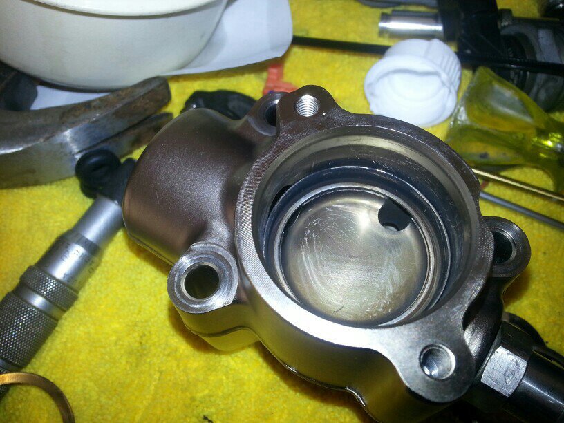

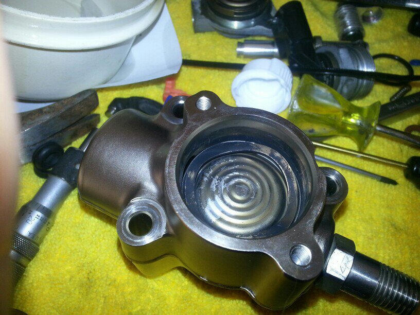

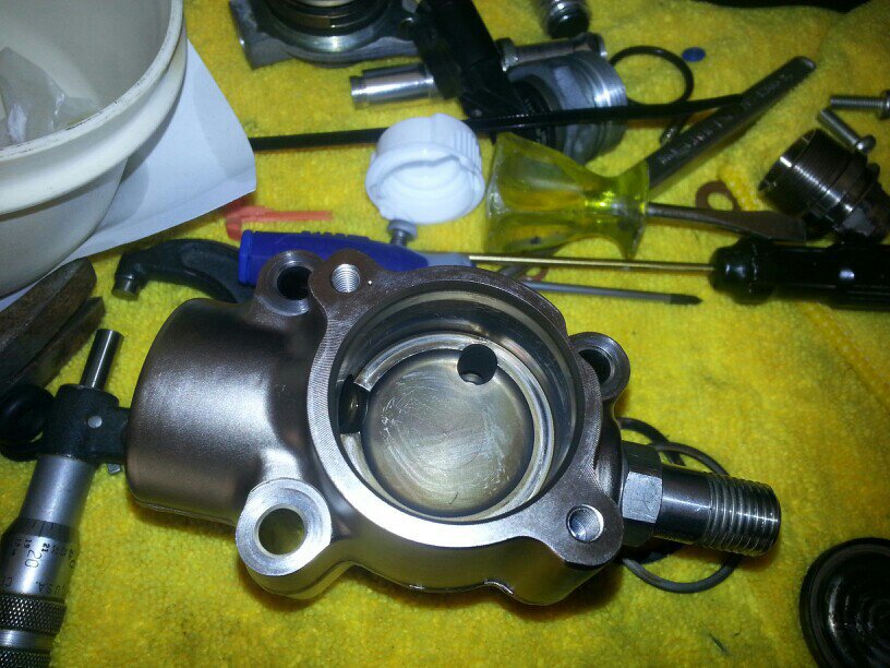

Anyone care to lecture me on the baffle design on our hp pumps? I was wondering if anyone has fucked with it. Do we even need it? I am thinking about ditching it and letting the fuel free flow in the chamber.
I would image that someone has tried this in an attempt to increase flow. I have yet to come across anything of this sort on MSF.
Without baffle (no fuel restrictions)
And here are the pieces being assembled.
Constantin (02-22-2014)
 Old 02-22-2014, 06:20 PM   #78
Enki's Avatar
Posts: 7,541   (View Stats)
Rep Power: 9902
Enki has disabled reputation
Thanks: 7,218
Removing the baffle will result in pressure fluctuations. I'd recommend against removing it as it won't result in more flow at all; these pumps are positive displacement, and if memory serves, the baffle section is before the spill valve and helps to dampen pressure waves sent BACK to the ITFP by the internals; removing this might actually result in premature failure of the ITFP regulator.
As a side note, I don't even take that section apart anymore, since there's nothing that can really get stuck IMO.
Constantin (02-22-2014), El_Diablo (02-23-2014), littleloogy (02-22-2014), mazdafreak (02-22-2014)

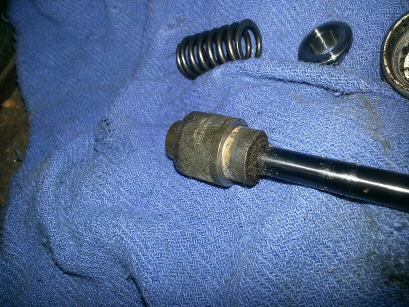

At about 480 miles black death accrued, I struggled for nearly 20 miles to maintain pressure. I could hear my cam follower clashing against the piston in the pump, finally got in my garage and parked it. Woke up early Saturday morning and pulled the pump. The piston was literally seized, separating the plunger was not easy.
I cleaned the internals with kerosene, and reinstalled the pump. I have had 550 some odd miles on the modified top needle valve without it needing cleaning.
I have confirmed that with the oil I am running, I can go about 50 miles before black death starts to develop in my pump. I am using this as my base to see if modifications are working or not. I am placing another parts order. My current goal now is to attempt to lower the HPFP temps, to keep the fuel from boiling in the first place. I will do some testing throughout the week and post up progress.

Just out of curiosity, you aren't oiling the internals/pump when you put it back together are you?
