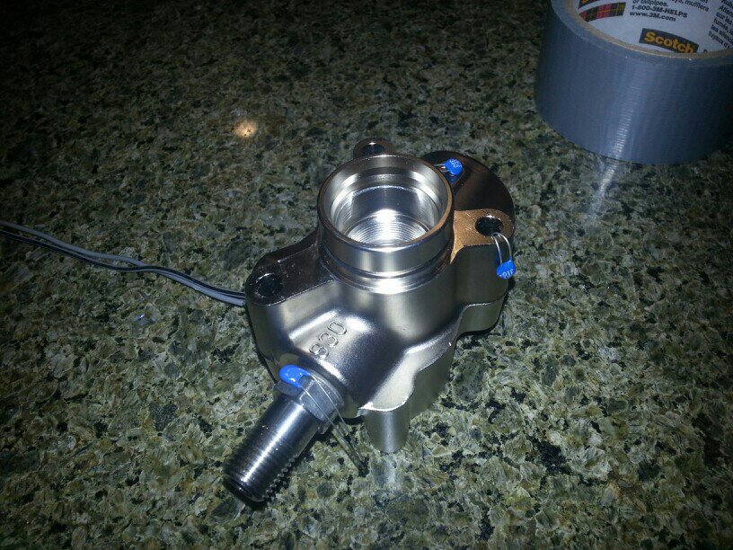

Just out of curiosity, you aren't oiling the internals/pump when you put it back together are you?
No, I am using solvents. Doing so would be no good.

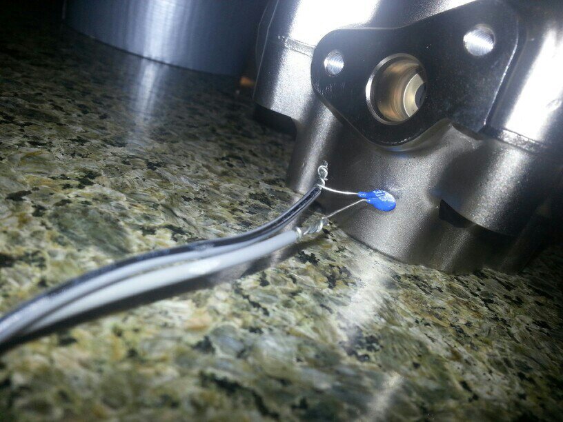

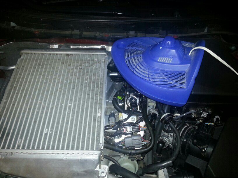

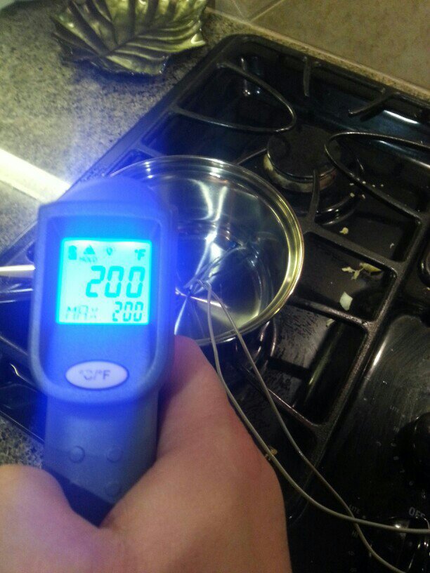

Here is my plan:
Get some thermistors and place them around the pump kind of like so...
I will run some cat5 cable from the thermistors to my cab. I will be monitoring temps with my ohm meters. Here is a couple of pics while I calibrated the thermistors.
I'll start placing the components tomorrow night, and I will be using thermal compound to ensure that nearby temps will not affect my readings.
Sent while cleaning my spill valve again...

Every night when I get home I have been putting a fan on my pump. Along with my secret fuel additive (I will share my findings after my tank is empty or when my car blows up) with 50 miles my spill valve looks cleaner then when I started.
The additive has started to eat at the goo that i left on the bottom next to the button valve.
