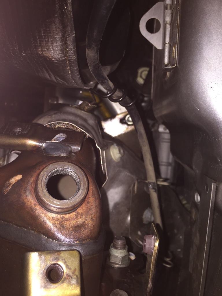

Holy shit... Fuck .

 Old 05-20-2015, 09:09 PM   #52
How the fuck does that even happen?

That's just what mine looked like when I took it out this weekend. I had to re-tap the hole and buy a new o2 sensor. Hope you have better luck!

Holy shit... Fuck .
How's it look on the DP?
Edit: That's a really clean looking o2 sensor. lol
I am so fucking pissed. This is some bull shit. I'll just JB weld it back in there. Fuck it.

They have helicoil thread repair kits for oxygen sensors...I don't know how well they work.
Edit: Probably better of buying a cheap DP

Looking at downpipes a now, but I really wanted to keep it stock looking. Funny story, the downpipe came right out...
100% corn on a K04 baby! EGT > 2000.
but really that sucks.
but really that could be due to high EGTs. Might account for the cleanliness of the O2 sensor as well.

Dont let that shit spark! Caused issues in @kbz0129;s car for weeks! @Captain KR;
Sent from my iPhone 6
unless you can cut/weld (which wouldnt surprise me), bring the o2 bung 30ish degrees counter clockwise. Should give you enough room to play
Worst case scenario he can just bring the DP to an exhaust shop and get a new bung welded on for a few bucks. Cheaper than a new DP. Or helicoil it

If I can clean up the threads with my tap then Ill buy a new O2 sensor. If not @Easter Bunny; called it. Lots of JB

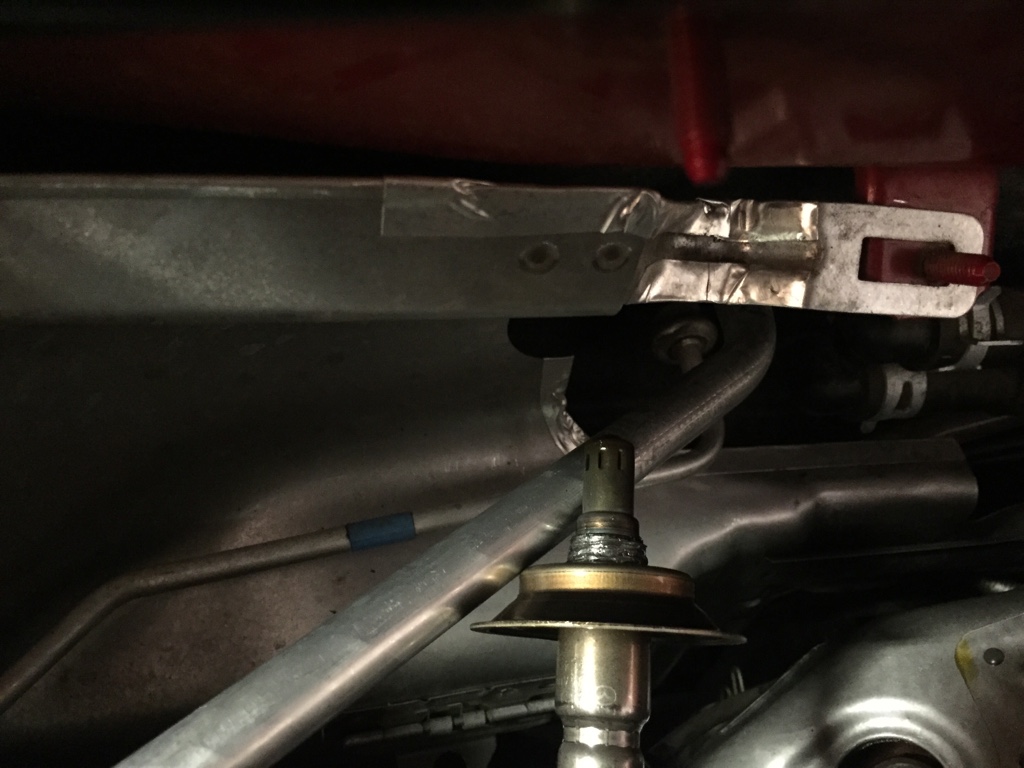

I will tap tonight. It looks to me that the O2 sensor lost most of its threads in the downpipe. I will pick up a new O2 sensor on the way home from work. And some anti-seize. Even if I can clean the threads up on the sensor, I did get a lot of PB blaster on the probe itself, so I should get a new one anyway.
Hit a brick wall my friend.
Get a 90* small pick and you should be able to get some of the threads clean with that. Harbor freight has a cheap little set of 4 picks with orange handles for like 2$, work for what you need.
