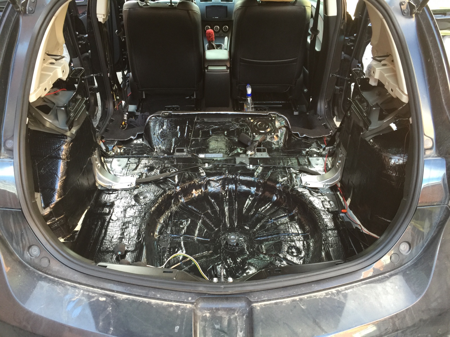

Then, as yet another add-on to this project, I figured that since every seat will be out of my car at some point, I'll put some sound insulation down to stave off some of the highway noise (Yeah, yeah, I know, added weight, shoulda bought a Prius, blah, blah).

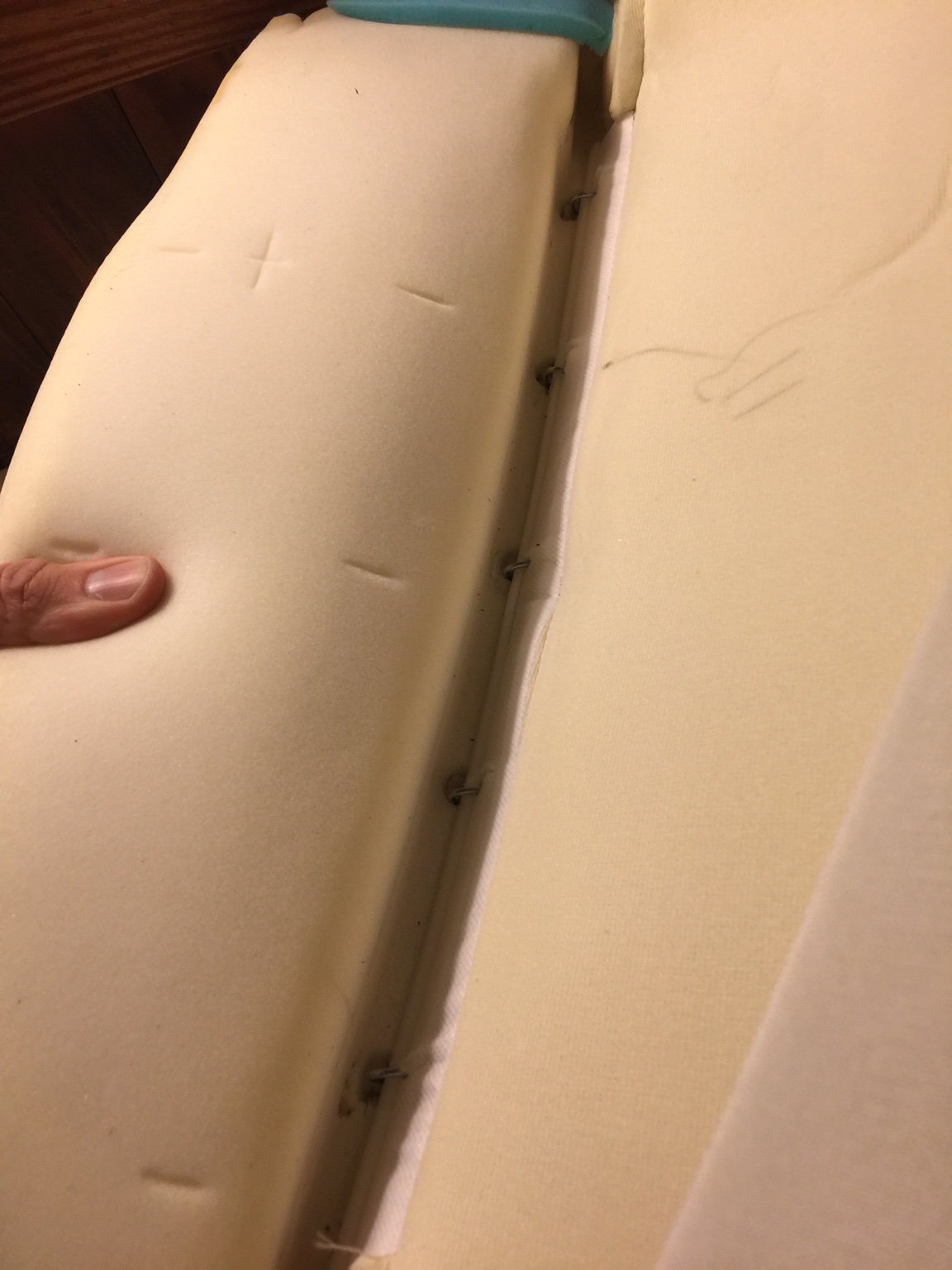

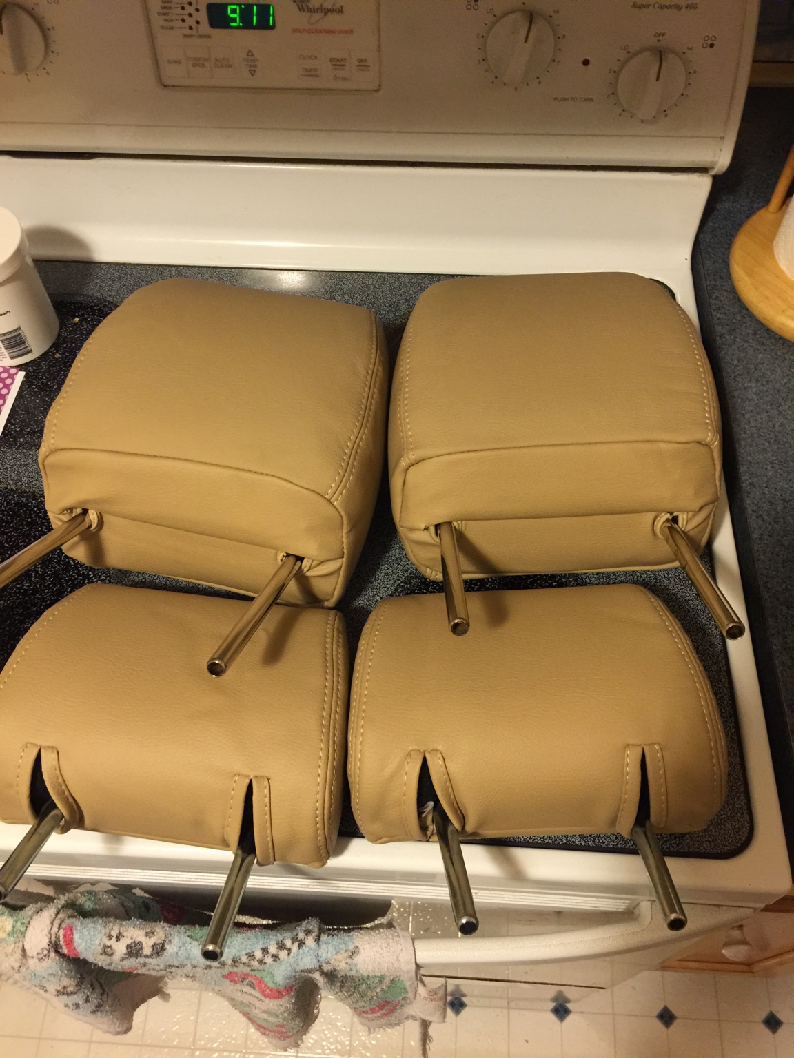

So I set off on this journey and did the headrests first:

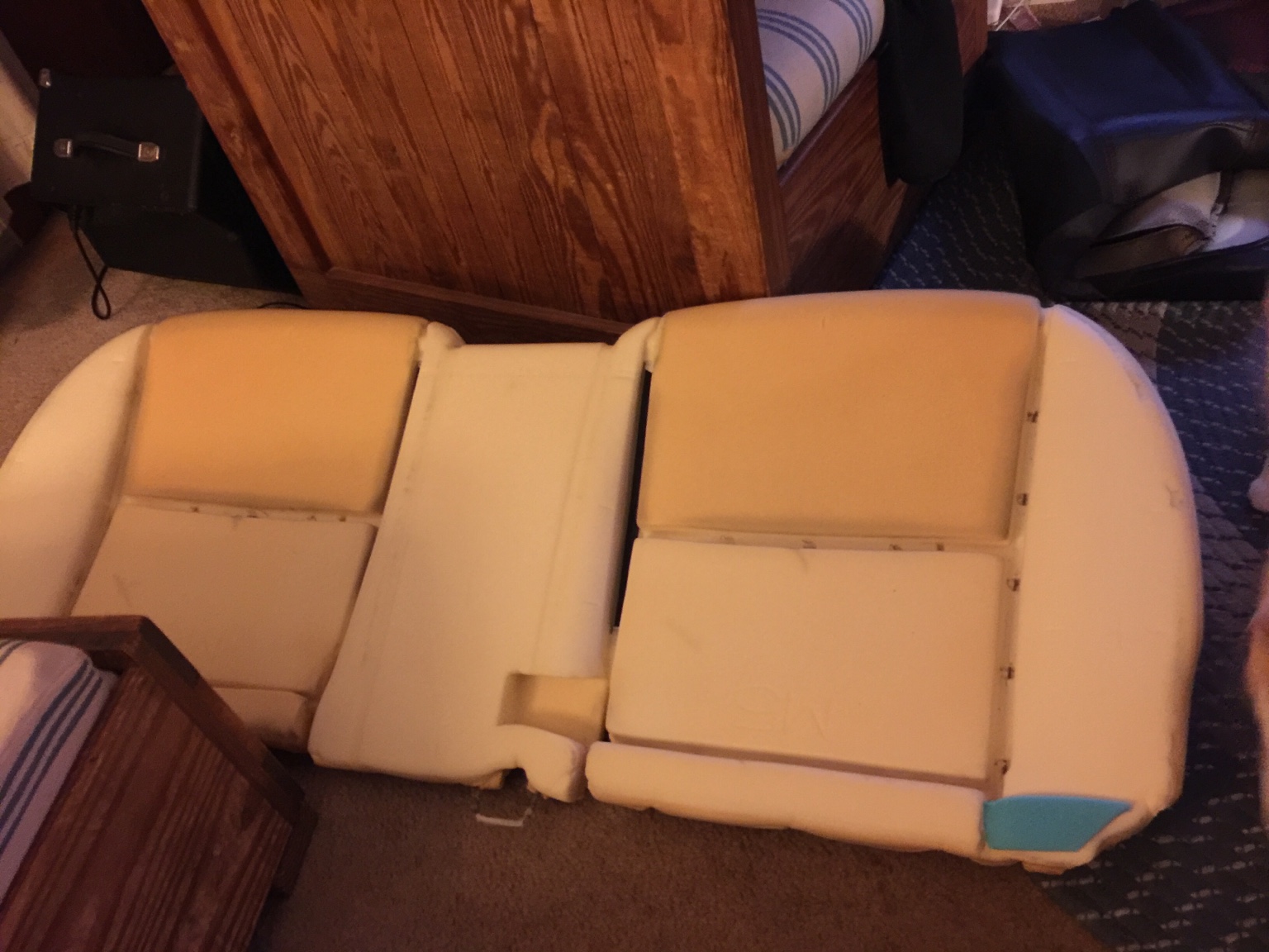

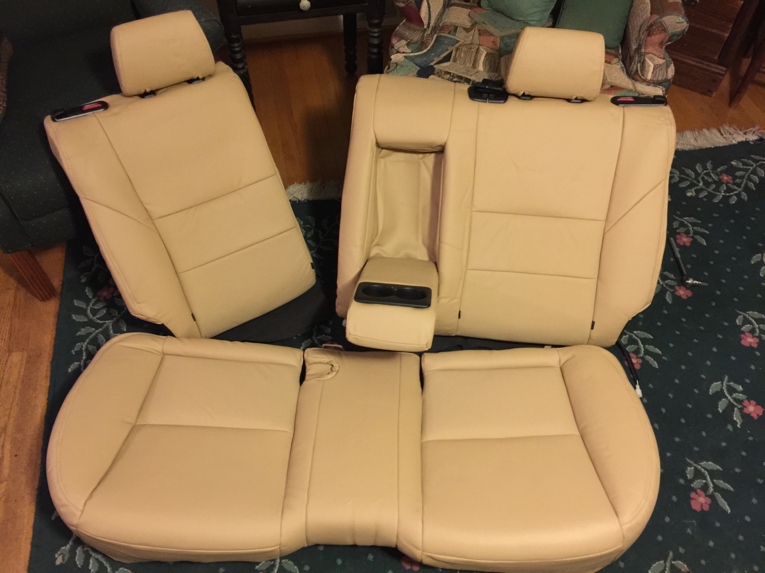

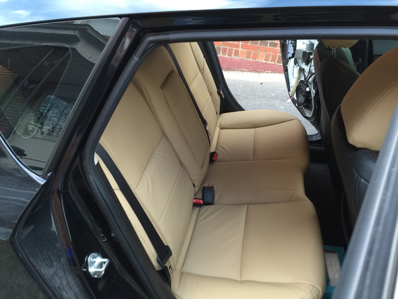

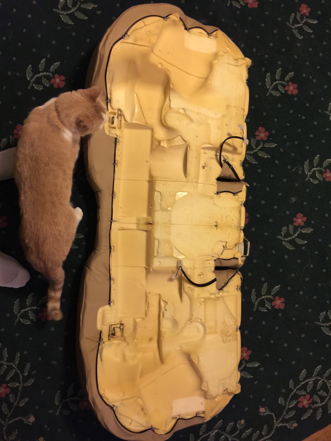

Then I did the bench in the back:
And then the seat backs too:

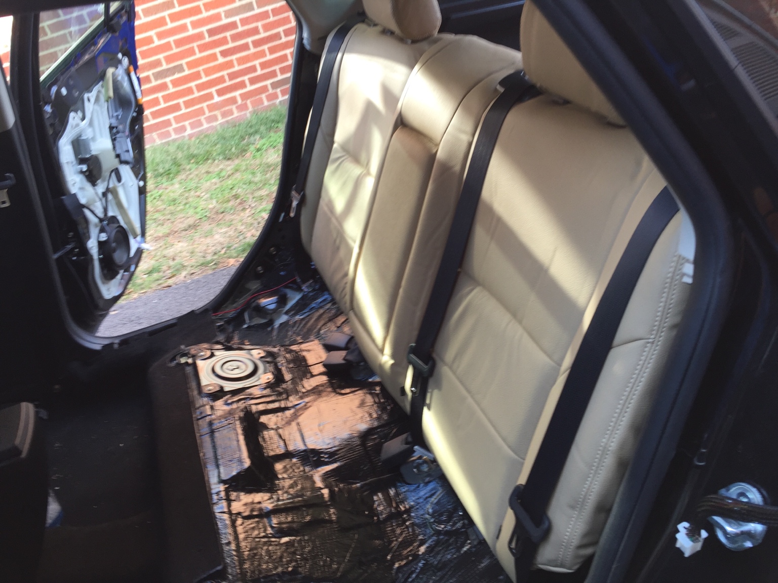

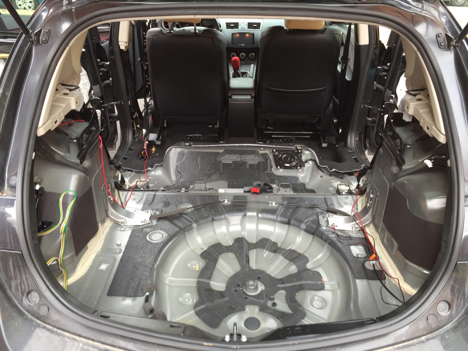

Once the rear seats were done, I stripped everything and installed the sound proofing:
Next, I installed the seat back, seat cushion, and then finally the door panels:

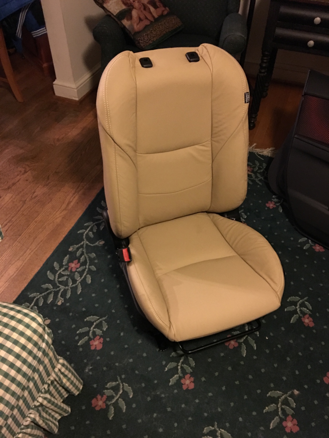

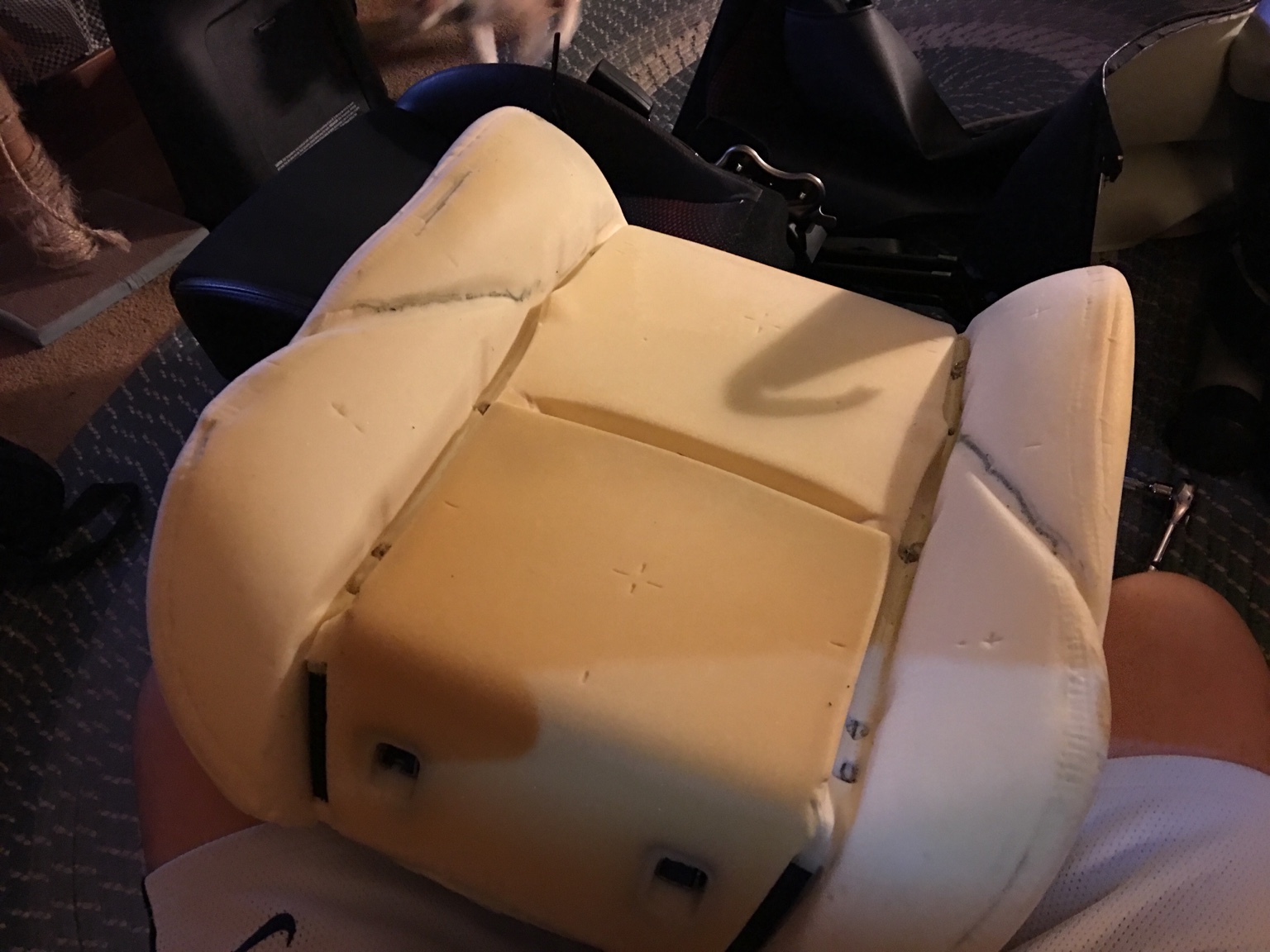

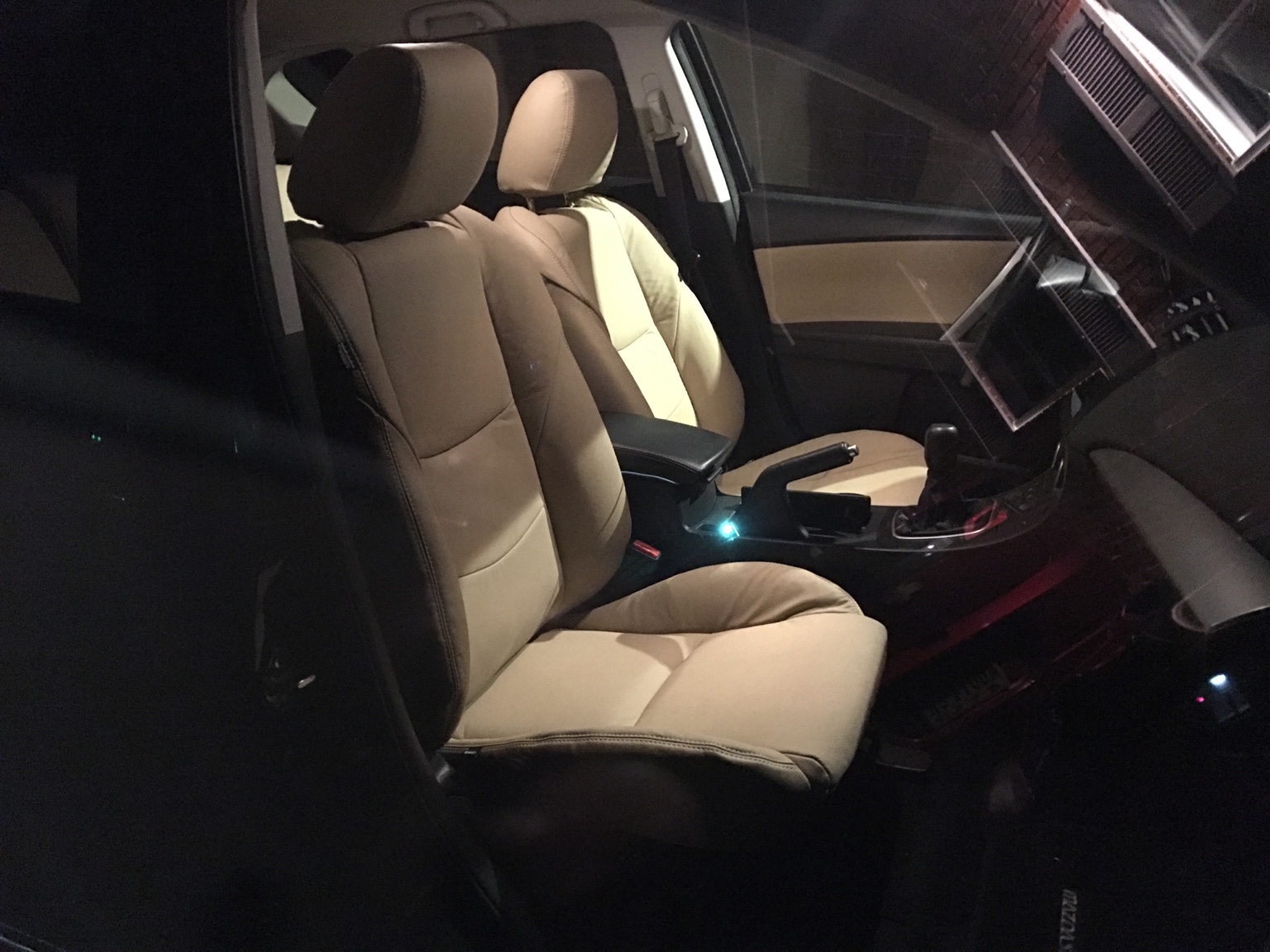

Then I started on the front seats:
My carpet probably got the most thorough cleaning it will ever have.
I then installed the sound proofing in the front, but didn't take any pictures since I was in a hurry.

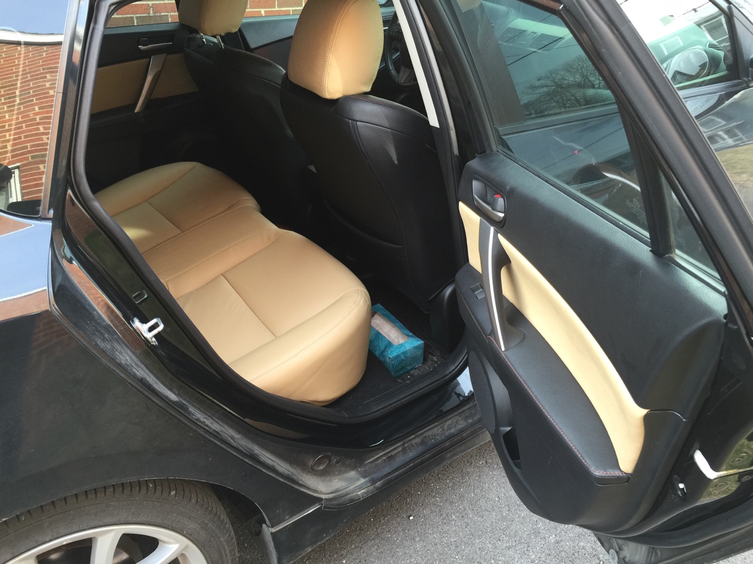

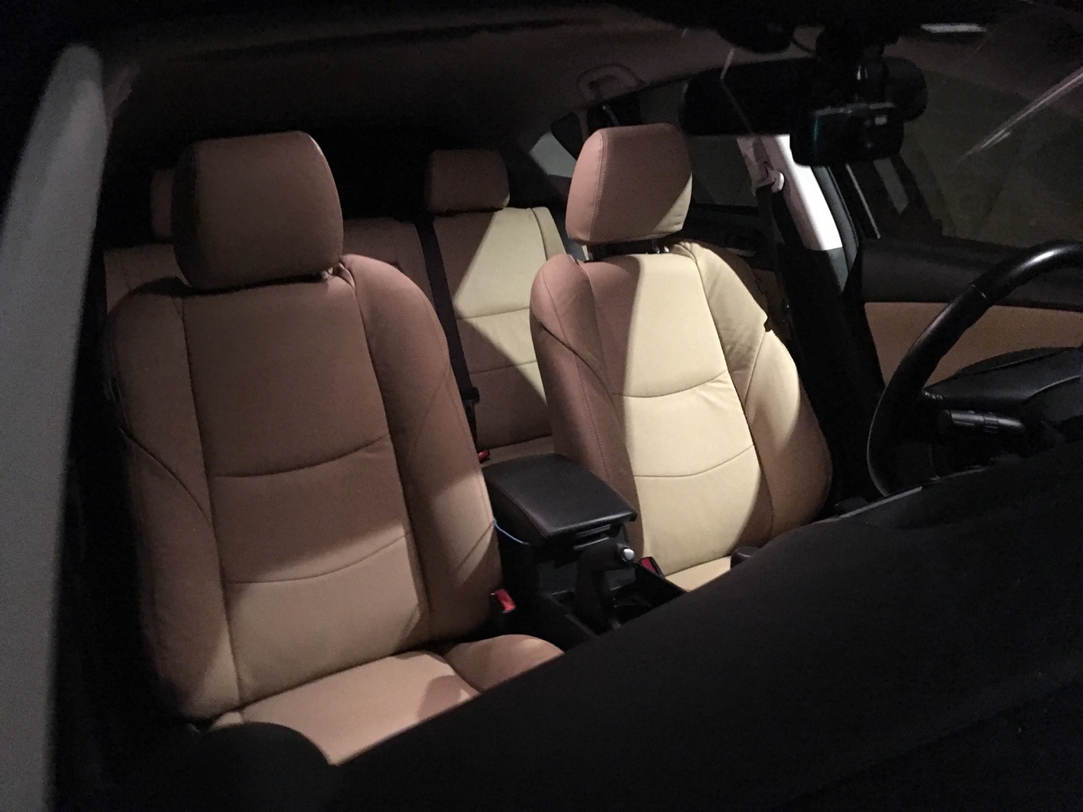

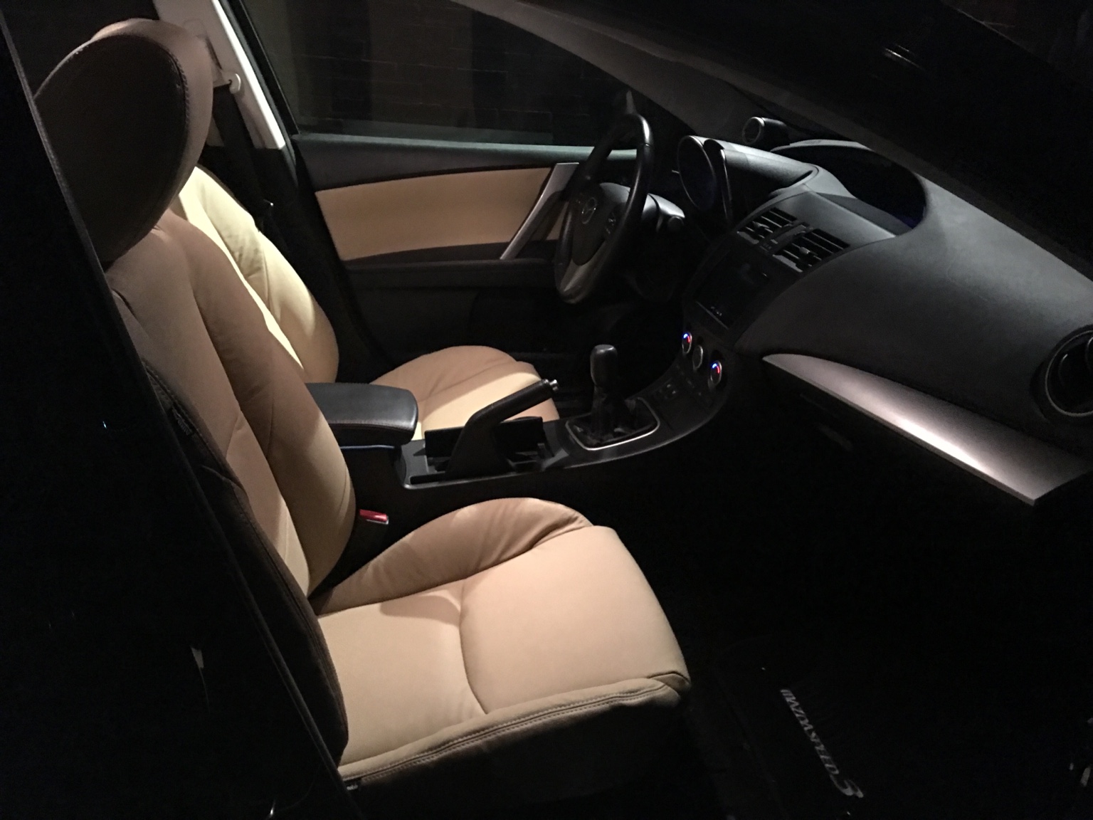

And finally, the finished product:
Sorry for the night shot on the last ones, it took me all day on Saturday to complete the front so I wasn't too focused on photos. I'll upload some higher quality ones after it gets another wash.
All in all, very bad pleased with install. At first, I was pretty apprehensive about the color, but once I got it on the back seat, I was all for it. The heated seats are really, really nice too since I wired them in with OEM switches.
The sound proofing make a HUGE difference too. I wasn't expecting much but it really is a noticeable difference. I usually cruise on the interstate with my volume at 22 but since the install, it sits at 14 and is just as loud.
All in all, with 2 seats of heated seat pads/switches, 60sq/ft of sound proofing, the leather kit, and tools cost around $350.
Considering I've seen people on here paying upwards of $1,000 for similar kits without the sound proofing or heated seats, I'm okay with it.
