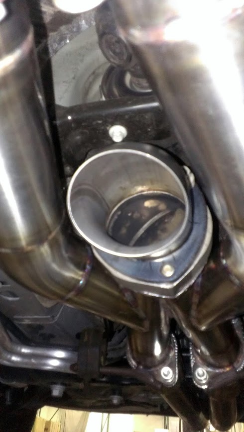

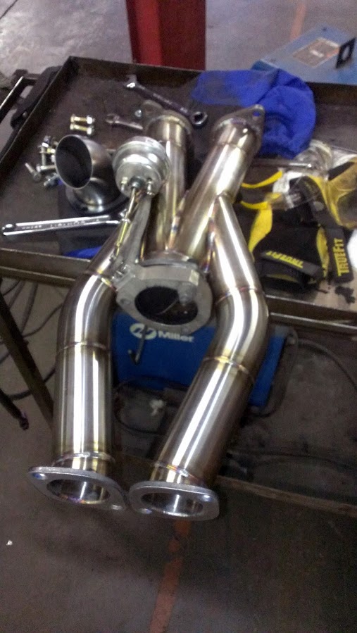

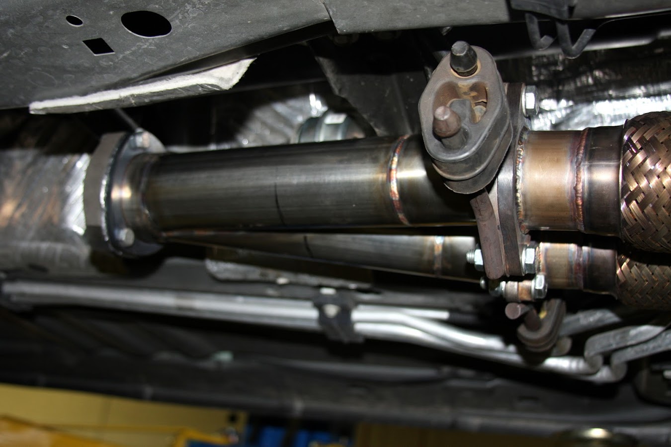

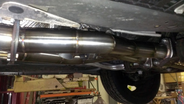

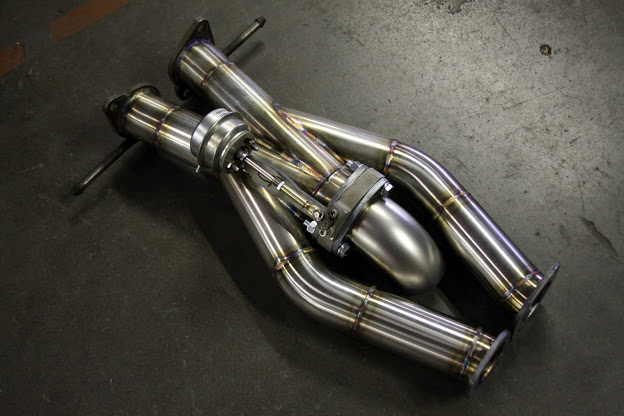

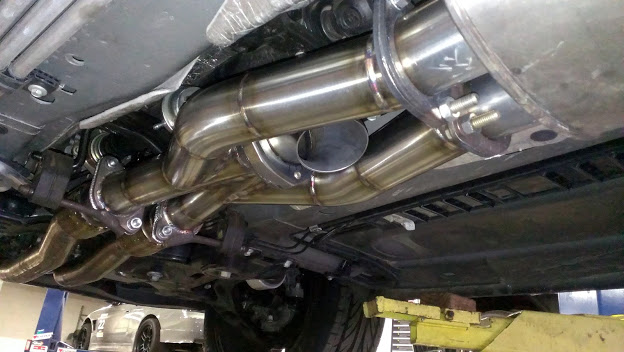

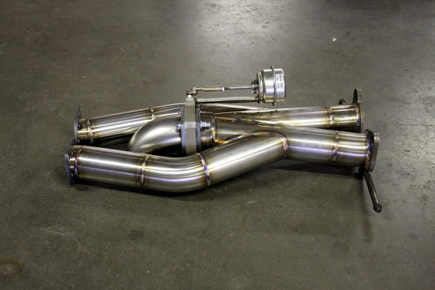

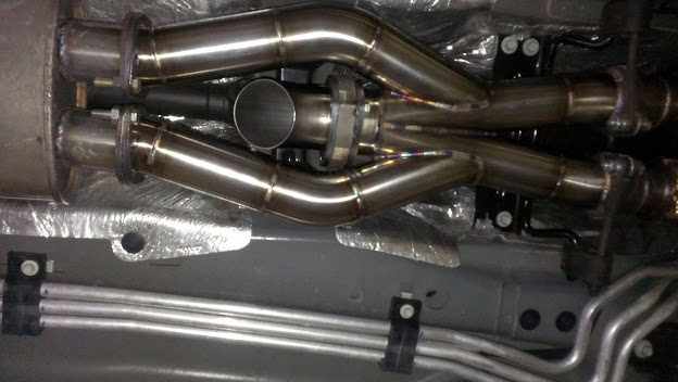

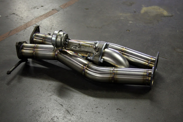

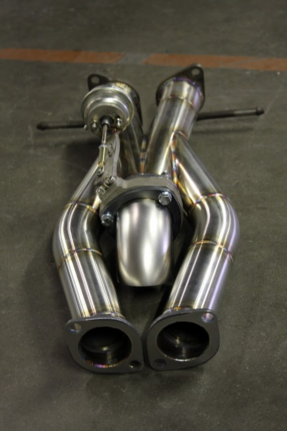

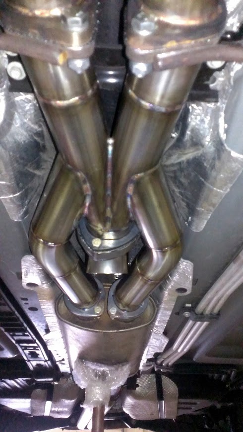

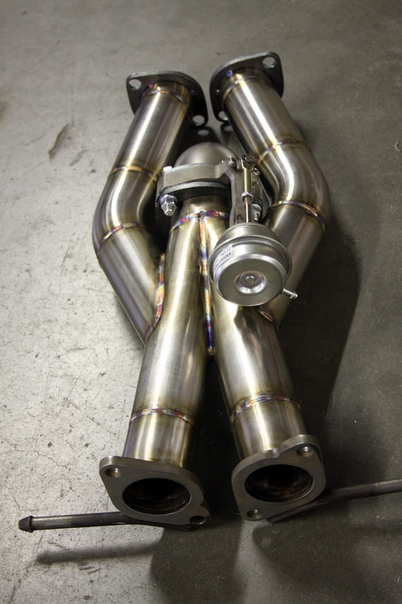

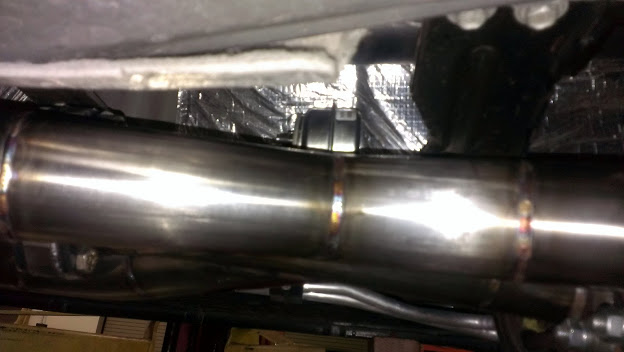

Default Had my cutout redone, super sexy metal work inside....
This is a Sound and Performance boost activated cutout seen here:
http://www.spracingonline.com/store/...ctivated_/3673
When over 6psi the cutout opens up - here's my video on it working on my stock downpipes with a bad H pipe install and on 91 octane tune at around 12psi. I haven't had a chance to test it yet with the new 23 psi tune. Previously this cutout picked up .2 and 2 MPH for me in the 1/4 mile in back to back testing. I like this versus a loud exhaust so I can have a quiet exhaust 99% of the time and loud when I want it.

You were right about the sexy!

This thing is tits!!!!

Damn that is some nice work. Who made it?

That is a proper cutout... Wastegate is a great way to adjust
Joey at Black Market Racing
https://www.facebook.com/BlackMarketRacing Local shop that does welding, tuning, dynos, installs etc.
