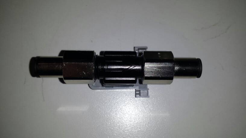

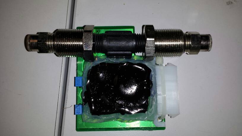

Ok here's the snow safeinjection guts. It is the good old gems ft-210 sensor although it and the guts are all well potted and it appears snow opted for the better material housing than aem.

Knew it. I believe it's the wheel/seals that swells so I am not sure why they are claiming 100% meth compatibility. The potting protects the electronics but it's not what fails as water will do the same to electronics.
Unless I am reading this wrong the sensor comes in a form that is meth/eth compat?
You're right, looks to be the case. Wonder if AEM simply doesn't use the methanol compatible version.

 Old 10-16-2014, 07:19 PM   #56
dale_gribble's Avatar
Posts: 4,720   (View Stats)
Rep Power: 5431
Thanks: 2,552
Aem shiny. Snow dull.
MINI H1 6.0 - CAR LED TAILS

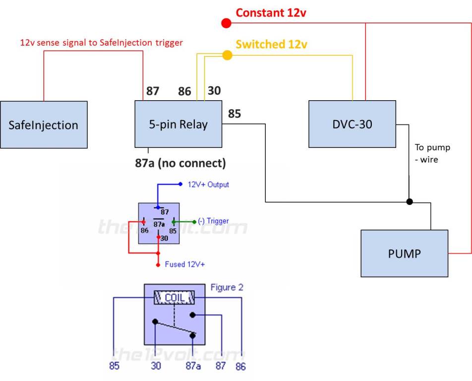

Hey @Lex; I could use your help here.
So, in the Devil's Own System, the pump gets a constant 12V and the DVC-30 closes the ground to the pump to energize the pump.
The Snow SafeInjection system input trigger requires a +12V input.
I used a relay that should use the DVC-30 ground switch to close the relay coil and provide the 12v signal to the SafeInjection.
Problem is, the relay latches as soon as I connect power to the car even though the power should be isolated. It seems like the relay is somehow getting energized by the 12V constant through the pump wire?
Any ideas? this is a diagram. I can't figure it out.

Hey Lex, don't sweat it. I found guys from the Evo forums with the exact same issue, and they cleverly (and simply) solved it with a pressure switch.
It's very simple, I'll hook up a vacuum line to it and +12v line, and when pressure gets to 15psi, it closes the switch and sends 12v to the SafeInjection trigger input. I used a Honeywell 76052. It's adjustable between 14 psi, 15 psi, 18 psi, 20 psi, 22 psi, & 23 psi (factory set at 15psi).
In a way I kind of like this better also, because now it makes the SafeInjection completely standalone and independent from the meth controller.

@dale_gribble; This is a good solution.
Just so everyone knows why he had to use a pressure switch:
1. The SafeInjection from Snow uses a 12V signal to tell it that the pump is spraying in order to diagnose a failure. Otherwise it wouldn't know how to diagnose a low flow condition. It would always say "low flow" when the pump is off. So we have to tell it when the pump is spraying.
2. The Snow controller varies the voltage on the positive line going to the pump. At full spray the positive wire will read battery voltage and at lower spray volumes it will read less than this. This is how the Snow controller varies the amount of WMI delivered on stage2 kits. The Snow controller uses what is called a high side driver.
3. The DO controller varies the ground signal to the pump instead and keeps the 12V constant at battery voltage all the time. They use a low side driver.
So the DO controller can't tell the Snow SafeInjection when the pump is spraying. In order to address this problem, a pressure/Hobbs switch is used. Once this switch sees X psi (set it close to full spray pressure for the controller) it switches 12V to the SafeInjection and now the SafeInjection can detect the low flow condition only when the pump is working.

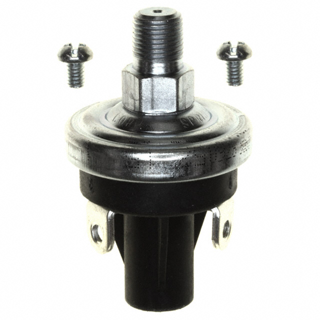

Ok guys, good news, the pressure switch worked PERFECTLY and the Devil's Own DVC-30 and the Snow Safe Injection are playing together. I just hooked the switch up, and the SafeInjection kicked into gear and the flow sensor and gauge are kicking (reading 250-280ml/min = 4-4.5gph which is pretty much dead on with how I have DVC-30 set). I tested the failsafe and it did trigger the Guardian Angel as expected.
I am running the SafeInjection on the output of the check valve, and I am trying to decide if I should have the failsafe before or after the check valve.
I left the pressure switch factory set at 15psi, because that's a good place for it to be. Now I just need to dial in the SafeInjection delay/min flow pots.
The pressure switch is Honeywell PN MFG Part No:76052-00000150-01
Mouser, Digikey and others have them in stock.
76052-00000150-01 Honeywell / Hobbs | Mouser

I just finished my meth install using the snow progressive controller, the AEM failsafe, and the GA. I had problems with the AEM gauge. Broken on receipt. Sent to AEM for repair and since it appears to be working. I haven't encountered any issues with the flow gauge at this time. I preferred the AEM since it does have both high and low flow alarms. But the fact that it was broken when i received it didnt give me a warm and fuzzy. it was a diode in the gauge that failed not the flow sensor.
@Lex I took a look at your diagram. This will cover you for one fail scenario but not both. I ended up utilizing a relay to revert the low flow ground output to a power source and linked both the blue (low flow ground) and yellow (high flow power) wires to the GA. So i'm now covered on both ends. I also added a audible alarm in case for some reason I'm not watching the gauge.
If you guys have questions I might be able to help.

@Lex Upon further testing of my setup, I would like to retract my previous post. Your diagram is correct. AEM's manual is not. Reading the manual, AEM suggests that the blue wire be used for a low flow alarm scenario where ground is required and the yellow wire for a high flow alarm scenario where power is required. I found that if the sensor picks up either alarm scenario it will provide ground and power via those two wires at the same time. Therefore in the event your sensor triggers an alarm use EITHER the yellow or the blue wire depending on what you want to occur for your setup. For the AEM WMI failsafe and Guardian Angel combination the yellow wire is the only one you will need.

@Lex Upon further testing of my setup, I would like to retract my previous post. Your diagram is correct. AEM's manual is not. Reading the manual, AEM suggests that the blue wire be used for a low flow alarm scenario where ground is required and the yellow wire for a high flow alarm scenario where power is required. I found that if the sensor picks up either alarm scenario it will provide ground and power via those two wires at the same time. Therefore in the event your sensor triggers an alarm use EITHER the yellow or the blue wire depending on that you what to occur for your setup. For the AEM WMI failsafe and Guardian Angel combination the yellow wire is the only one you will need.
AEM just wants to make sure their system can trigger a device either with a high signal or a low signal.

Ok update on my end, the snow failsafe started working intermittently and now won't read at all even though bats drop as expected and meth is definitely still flowing. All meth/vacuum/electric connections are fine and the snow failsafe is kicking in since it isn't measuring flow.
I am RMA 'ing the 2 aem setups and the snow setup tomorrow. We'll see what comes back.
FML...
I'm thinking about just running the DO status leds to big dummy lights on the dash and calling it good.

So, I already disconnected the SafeInjection failsafe from GA because I got SO SICK of the SI triggering the GA when it didn't read flow. So, I just watched it today driving in, and sometimes it would read a number for a second but most of the time not at all even though BATs were diving into the 50s-60s through an entire 3rd/4th pull.
If I hook it up when the car is off and I trigger a steady flow, it reads fine. When I use it on the car in real world, it sucks. I have done everything possible to mitigate any setup issues. Everything is working like it should but the flow sensor. It just can't seem to get a decent consistent read at all and it reads inconsistenly just like the AEM sensor (when it read at all). If I had to guess, I think the flow sensors can deal with flow ok, but they don't like transients (i.e. rapid ramp up/ramp down)
So, even when it worked good, it didn't work for that long so it's back to sucktown.
