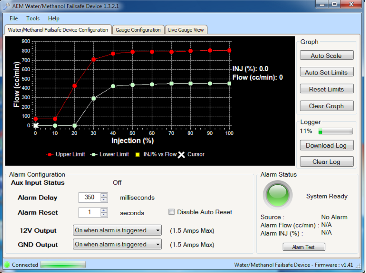

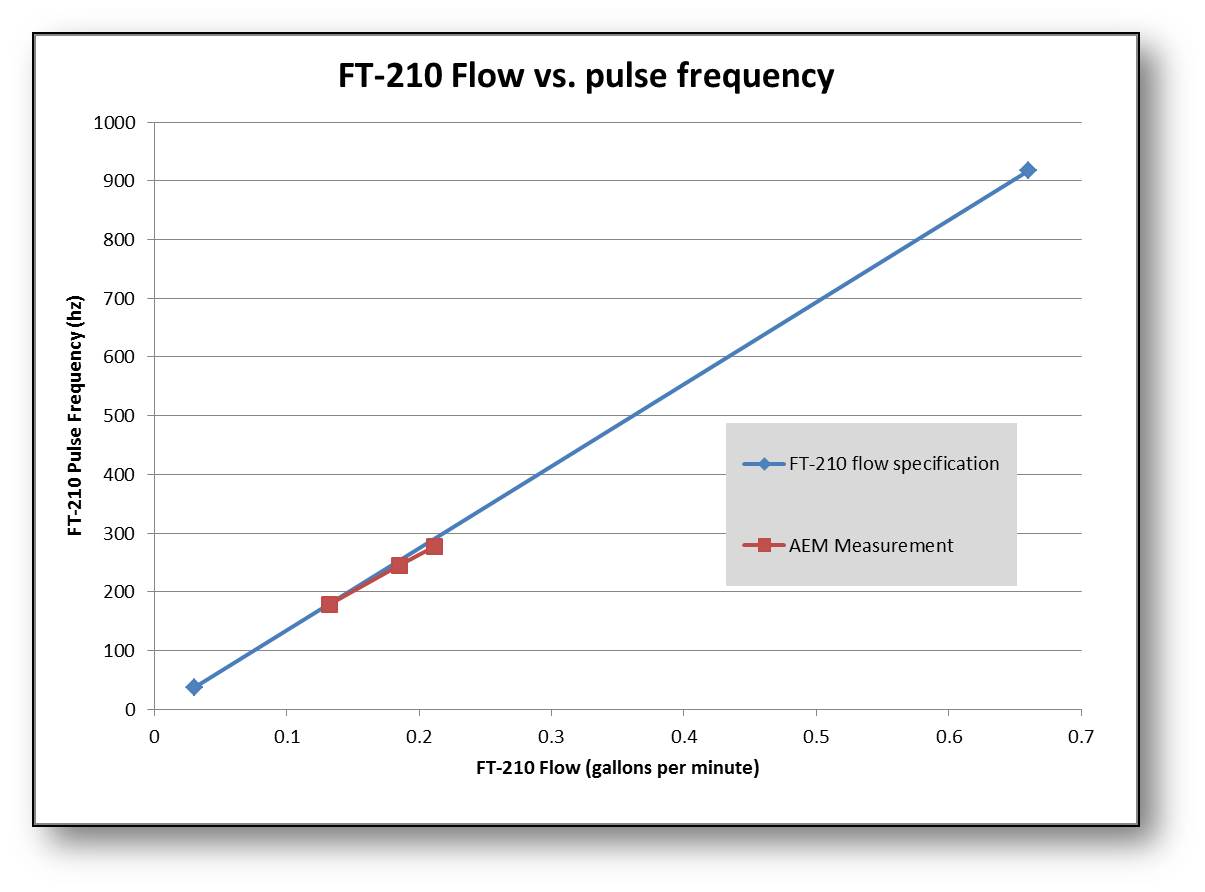

I just got an update from AEM on my RMA of the two flow sensors/gauges I sent them. Both flow sensors tested bad.
I spoke with SNOW on the SAFEINJECTION and they swear up and down the intermittent behavior from the flow sensor is bad wiring or a loose connector. They have had reports of intermittent connectors causing this behavior. Given that they use a non rugged computer style commercial 5 pin connector, maybe they are on to something. They sent me a new and tested connector to try. I don't get why they POT the entire body of the unit and then use a crappy loose connector.
So, results to post soon. I am going to test the AEMs when they come in.

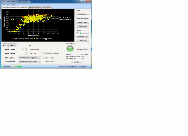

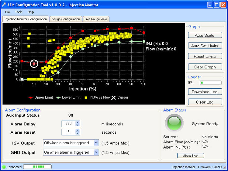

I've been following this thread closely as you and I seem to be on the same upgrade path with the same car.
I've encountered a variety of issues with my meth install. The latest I blamed on the AEM failsafe. Very similar symptoms. First issue: the gauge read wildiy 700cc on a 441cc nozzle. Then it dropped to 250cc and then nothing. Through troubleshooting I found that the high flow read was due to air remaining in the system ( System was not fully primed). The low flow issues I encountered were the result of blockage to the sensor impeller. Initially, I was not running a tank tap filter or in line filter. When i looked in my tank, I had a bunch of shit in here (small bugs, particles etc.). Funnel i used sat around in the garage awhile so I blamed that. Filtered the meth mix with a coffee filter, flushed the tank and installed both a tank tap and in line filter between the tank and the pump. I removed the flow sensor and blew into it just using my mouth and was able to get the impeller spinning again. Saw the same high flow results as before but that disappeared once the air from the system abated. The gauge is now reading plausible numbers however now I'm seeing a lower than expected flow rate ~390cc vs maximum (nozzle limiting) flow rate of 441 cc.
Current setup is as follows:
Snow Performance progressive controller running in boost mode/AEM failsafe/Guardian Angel
trunk installed tank -> Devil's Own filtered tank tap ->AEM inline filter->Cooling Mist pump->AEM flow sensor->Devil's Own solenoid->Devil's Own DO7 nozzle (using a snow performance CV integrated holder)
My current troubleshooting objective is to determine whether I'm seeing normal, parasitic loss due to the filters, flow sensor, and CV i have installed in-line or a partial blockage in one of the components in the system. A 12% flow loss may be reasonable but i want to make sure. Plan to pull everything apart inspect and clean. I also called AEM and got an RMA #. I'm having them bench test the gauge and flow sensor since I already encountered one issue with the gauge already and then had this flow issue.
Frankly, after my initial issue with a bad gauge, then the erratic flow, I don't trust the failsafe either. If this thing is going to be blocked for any reason, I cant see trusting it for high or low flow scenarios. But right now I'm still optimistic that i'll be able to get it to work.

Here's an update on my failsafe saga-
SNOW failsafe. It appears as though the SNOW failsafe is working better with the replacement harness they sent me. It does occasionally not show a reading and trigger a false positive. I suspect this may be used to the pressure switch trigger I am using though; there might be some hysteresis in the pressure switch trigger pressure and sometimes it doesn't trigger the SNOW. When the SNOW reads now, it doesn't bounce around and it holds a steady 500ml/min reading under full spray. I am thinking about seeing if I can get a +12V trigger using one of the DO controller LEDs (i.e. flow LED). Maybe I'll get lucky and they don't do any DC-DC stepdown for their LEDs. I still need to build confidence in this system, but it seems to be ok for now.
I did get the AEM units back. I decided to try the failsafe again and see how it does. On the plus side, the first AEM unit/sensor I tried triggers flow every single time. Every single time. On the downside, it doesn't measure flow right. I saw it briefly measure correct flow last night for about 30 seconds (fluid movement to peak ~500cc/min), otherwise it jumps around between 700-750ml/min very abruptly. So, on one side, I can use it for an indicator and failsafe as it is, but it doesn't meter for shit so I really couldn't set the upper/lower failsafe limits very well. I might swap in the other spare AEM parts I have (flow sensor and/or gauge) and try to isolate where the shitty metering is coming from.
I guess it's a step in the right direction. The SNOW appears to be working save some intermittent issue with the trigger and the AEM is detecting flow although the metering is shit.

Ok, big update here.
I decided to take a flow sensor and AEM failsafe and test them on a bench to get to the bottom of this. First, I plotted the curve of the FT-210 flow gauge (which is linear). This is pulse rate (hz) vs. flow from Gem's website.
I used an o-scope to measure the pulse rate and plotted on the flow sensor's curve. You can see the red line plotted on the blue line. The reported flow from the sensor matches the failsafe gauge reading. I repeated this with two flow sensors and results were consistent.
Because the results were consistent across both flow sensors and the flow gauge matched the sensor readings, I think I feel better about the AEM metering flow right. So, why then am I seeing ~700cc/min when the D07 is rated to ~440cc/min? It's elementary as I found out (and feel stupid about).

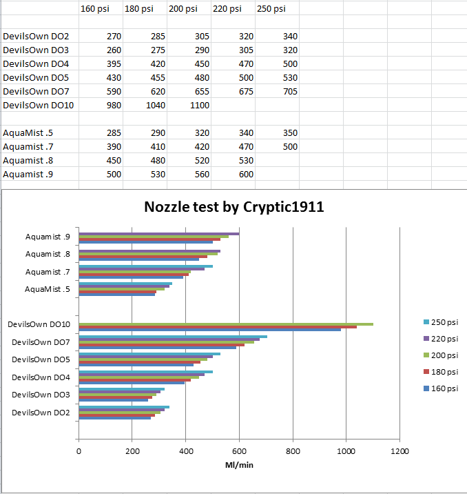

Devil's Own (SNOW too) rate their nozzles at somewhere between 60-100psi (I read snow is 60psi and Devil's Own is 100psi). All of their pumps are factory set at 200psi. What these means is, the nozzles flow a significant amount more at 200psi than they do at 100psi. So, when you read that a D07 flows 7 gallons/hour (441cc/min), that's at ~100psi. In reality, the D07 flows much more at 200psi pump pressure (650-700cc/min).
This cool guy on a vw forum flow checked a bunch of nozzles at various pump pressures. Here you can see he measured the D07 at ~655cc/min @ 200psi.
Has anyone ever done a WM nozzle flow benchmark? - Page 4 - VW GTI MKVI Forum / VW Golf R Forum / VW Golf MKVI Forum / VW GTI Forum - Golfmk6.com
What does this mean? I think the repaired AEM failsafe has been metering right all along.
Believe it or not, the repaired AEM setup has now been running consistently for about a week and hasn't missed a single trigger or had a weird flow event. What I suspected was a flow metering issue was in fact shitty marketing on the part of the nozzle manufacturer.

Hey, those are my nozzles. I only thought he had posted on the vortex. The DO numbers are for their new nozzles, not the older micro-droplet nozzles. The Aquamist nozzles were new to several years old.
Dust is offline   Reply With Quote
 Old 12-03-2014, 04:30 PM   #111
I believe all manufacturers rate their nozzles at 100psi.
Also AFAIK most pumps have a settable internal pressure bypass and this sets the maximum pressure they run at.

Look who finally got his shit together! After months, I was able to finally get the whole AEM setup going and actually build a failsafe flow curve! I am not going to hook up the failsafe just yet, but it's almost done!
Here's the flow plot after about 3 4th gear pulls. Not super tight, but a curve nevertheless. I clicked the automatic curve function to build the initial curve.
aaaaand, the curve is officially built.

It's a big range for the error (50% of total flow). How does it end up reading a flow of 400cc and 800cc at the same Injection % (is that pump duty?). Does it start sampling the flow a little early perhaps when you first get into boost and the system hasn't built up pressure? Does increasing a delay (perhaps alarm delay) help tighten the curve at all?
This is AEMs curve on their website. I don't think it is super tight. yes, that is pump duty cycle. The failsafe triggers on the controller pump signal line. I suspect the variation has to do with 2 things:
1. The pulsing behavior of the pump itself. If the pump was continuous flow, I am sure the curve would be much tighter as the sensor is spec'd to hold +/-3%.
2. It would definitely benefit from some averaging as well. I don't think the AEM does any averaging/exponential averaging, so it samples and reports, samples and reports, etc in whatever duration it's controller samples the incoming pulses from the flow sensor.
MINI H1 6.0 - CAR LED TAILS
