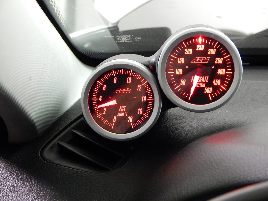

This is the exact setup I did. If you look carefully, you can see the Guardian Angel LED indicator between the gauges.
The cool thing is that the AEM failsafe has a USB cable and Windows based program that allows you to trigger the failsafe condition through the gauge. This means you can test the whole failsafe end to end after install and not just in the heat of battle.

Having said that, my newly installed kit isn't working. Meth is spraying fine but flow guage isn't reporting anything.
I double and triple checked all connections and fittings, flow sensor direction, 0 install issues.

UPDATE: THE AEM flow gauge is a total piece of shit. It isn't rated for temps over 100F and I have already broken 2 of the flow sensors due to heat. AEM recommends that the flow sensor be in the passenger compartment or trunk (LOL) or basically completely away from any heat.
I don't know where on a car you can guarantee ambient below 100F. For the reason, I cannot recommend AEM flow or failsafe gauges because their flow sensor is garbage.

Ok guys here is the AEM flow sensor. It's the thing in the lower left hand sensor.
It only took me a little while searching to find their flow sensor supplier, it's gemsensors.com and the part number is FT-210.
Website: FT-210 Series TurboFlow; Turbine Electronic Flow Sensors
Now, what first comes to mind is they have an 'Instruction Bulletin' it's here. Of note is the following: "The system needs to be filtered to 50 microns prior to the sensor, and pulses/water hammer effects should be minimized to prevent unit damage."
http://www.gemssensors.com/~/media/G...ns/FT-210.ashx
Well shit, of course AEM doesn't include a filter (which isn't a bad idea anyways), but the part that gets me is the 'pulses/hammer effect'. My DVC-30 pulses the pump. The higher duty cycle (more pulses), the higher the flow and vice versa. If you've ever had a meth pump pumping into a water bucket, you can see the pulsing/hammer effect on full display. I assume that all controllers pulse the pump. So, I suspect the pulsing meth pump is what is damaging the flow sensors instead of temperature.
So, AEM is basically is selling a kit with a piece of shit flow sensor.
BTW, my AEM EGT sensor is also bouncing around when temps go over 1400F unless I accelerate very slow. Sometimes it doesn't do this but 90% of time it does. I have been over things 10 times, and if you know my work I am pretty careful with things.
I am in full AEM hate mode right now.
EDIT: Keywords for anyone ever searching MSF or even google for this POS kit so they find this: AEM Water/Methanol Failsafe Gauge, 30-3020

I have one more thing going on here that might be a manufacturing error on the AEM system.
I happened to order an AEM WMI flow kit before I decided I wanted the failsafe. So I had that on my desk here. it is essentially the same thing- same board, same flow sensor, same cable, etc. I started probing the brand new flow gauge and measured the following on the flow sensor pins (when the unit was powered on)-
Pin 1 - 5v
Pin 2 - GND
Pin 3 - 4.681v
Resistance pin 1 to 3 (supposed to have pullup resistor): 30kohm
Calculated I (load on 5v for pullup)= 170mA
Now, here's the same readings on the failsafe
Pin 1 - 4.95v
Pin 2 - GND
Pin 3 - 4.95v
Resistance pin 1 to 3 (supposed to have pullup resistor): 10kohm
Calculated I (load on 5v for pullup) = 500mA
Now it's starting to make some sense. I think the resistor in the failsafe is actually too high for the flow meter NPN collector to sink to 0v. The flow sensor guide states that the unit requires max 20mA current to sink the output to 0v. The pullup resistor needs to be just low enough so the collector can sink to 0v when sunk to ground but high enough to pull right back up. The 500mA of the failsafe is definitely too high for the flow sensor to overcome.
EDIT: Update. When I put the flow sensor on the new flow gauge, the supply voltage remains at 5V. When I put the flow sensor on the failsafe gauge, the supply voltage drops to a volt. Makes perfect sense. There's too much load on the power supply. I am going to swap the 10k resistor to a 30k resistor on the failsafe and see what happens.
Pin 1 - 5v
Pin 2 - GND
Pin 3 - 4.681v
Pin 1 - 4.95v
Pin 2 - GND
Pin 3 - 4.95v
Now it's starting to make some sense. I think the resistor in the failsafe is actually putting too much of a load on the 5v supply and this is impacting the flow sensor's capability to operate. I am not an EE, but I reckon the 5V supply can't support any more than a watt and 1/2 of that is being pulled out via the resistor meaning less power to the flow sensor to operate properly.
This doesn't seem to be going anywhere. I swapped gauges and still 0 reading with either flow sensor. I am back to the flow sensor as the culprit. It seems like the pullup resistor may be matched to a flow sensor based on variation of the flow sensor- kind of like a calibration. It's just a hunch though. The 30kohm resistor is allowing the flow sensor output to sink to 0 volts but I can't make the flow sensor move to see if it pulses on the output. I don't really have a way to test flow on the bench here.

Naaa, tried. I am officially closing book on AEM failsafe and moving on. I am going to mail flow sensors + gauges back to AEM, get refurbished/repaired and sell on fleabay.
