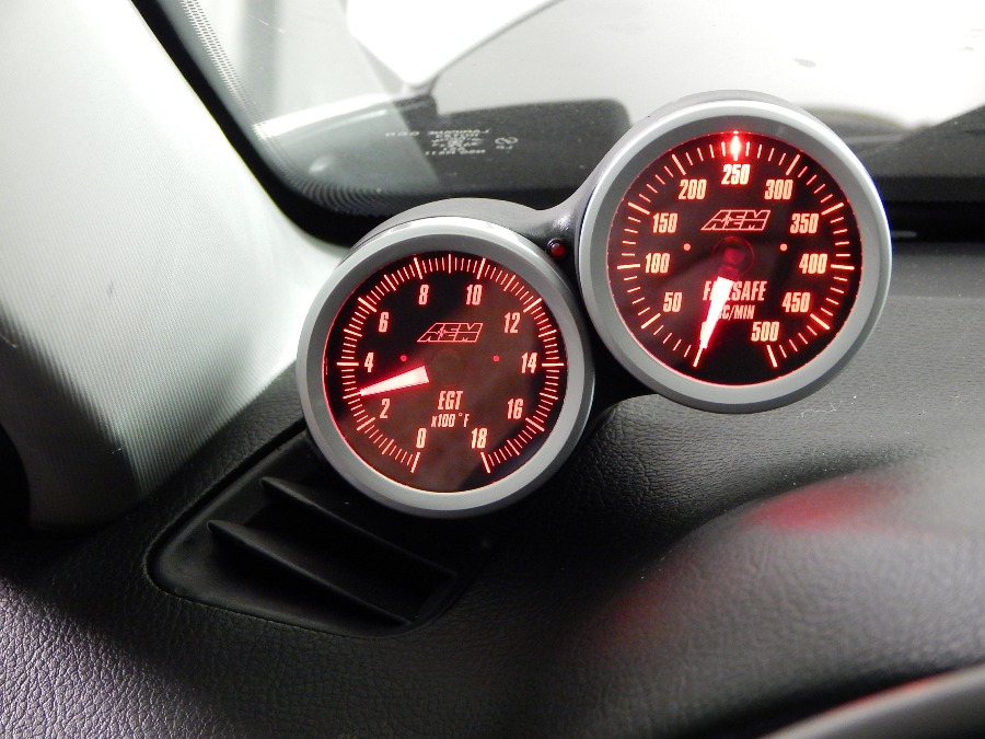

Ok guys here is the AEM flow sensor. It's the thing in the lower left hand sensor.
It only took me a little while searching to find their flow sensor supplier, it's gemsensors.com and the part number is FT-210.
Website: FT-210 Series TurboFlow; Turbine Electronic Flow Sensors
Now, what first comes to mind is they have an 'Instruction Bulletin' it's here. Of note is the following: "The system needs to be filtered to 50 microns prior to the sensor, and pulses/water hammer effects should be minimized to prevent unit damage."
http://www.gemssensors.com/~/media/G...ns/FT-210.ashx
Well shit, of course AEM doesn't include a filter (which isn't a bad idea anyways), but the part that gets me is the 'pulses/hammer effect'. My DVC-30 pulses the pump. The higher duty cycle (more pulses), the higher the flow and vice versa. If you've ever had a meth pump pumping into a water bucket, you can see the pulsing/hammer effect on full display. I assume that all controllers pulse the pump. So, I suspect the pulsing meth pump is what is damaging the flow sensors instead of temperature.
So, AEM is basically is selling a kit with a piece of shit flow sensor.
BTW, my AEM EGT sensor is also bouncing around when temps go over 1400F unless I accelerate very slow. Sometimes it doesn't do this but 90% of time it does. I have been over things 10 times, and if you know my work I am pretty careful with things.
I am in full AEM hate mode right now.
EDIT: Keywords for anyone ever searching MSF or even google for this POS kit so they find this: AEM Water/Methanol Failsafe Gauge, 30-3020
