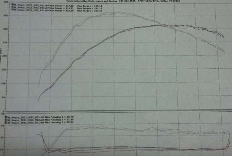

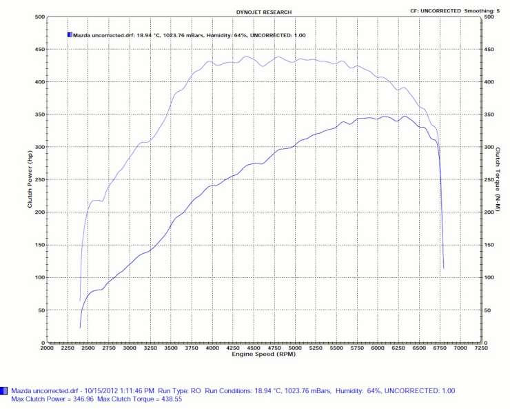

Another thing to keep in mind when looking at a vdyno plot - does the curve look realistic? I see a lot of Vdyno plots with a hump or bump in the middle of the power curve bumping the peak numbers. However, often this is caused by a bump in the road and is not representative of the car's power.
To get an idea of what the average DISI K04 power curve looks like - look at dyno sheet as show below. Notice the smooth shape of the curve with peak torque being reached early and falling off in the upper RPM.
When a bigger turbo comes into play or the engine has been reworked for flow, the torque curve is flatter and is usually shifted to the right. However notice again the smooth shape of the curve:
