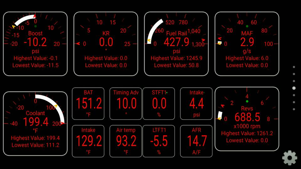

Hey guys I need help, which one of this two JBR 3" Wide Path maf cal is designed for the Full aluminum intake ?
This is the intake I have, which I stalled yesterday. I used the first one into a 93 Stage 1 map, and after 40+ miles the car is running lean with LFT around 20.
I am trying to get the afr and fuel trims to become some what normal so I can get a Maf cal done.

I have the same intake and used the top maf cal(tru) and was within 4% without making any changes. If your ft's are off that bad I'd say go check for leaks, somethings not tight.
Well...if you look at the MAF g/s values in those two tables you highlighted, you'll note that the one with the 3.0"ID has nearly 500g/s at the top end, while the other one is closer to 430g/s. That's a difference of about 14-16%.
If you are running lean, you should probably run the table with the higher values in it, as the ECU is attempting to add a bunch of fuel to the mixture because the WBO2 has determined that too much air is in the mixture. Ergo, you need to tell the ECU that it's getting more air than it currently thinks it is. That is, for each MAF voltage value, the g/s should be registering as something greater than it currently does.
f15ms6 (07-07-2016)

Great thank for the answer, now that I know thats the correct one I need go find the leak..

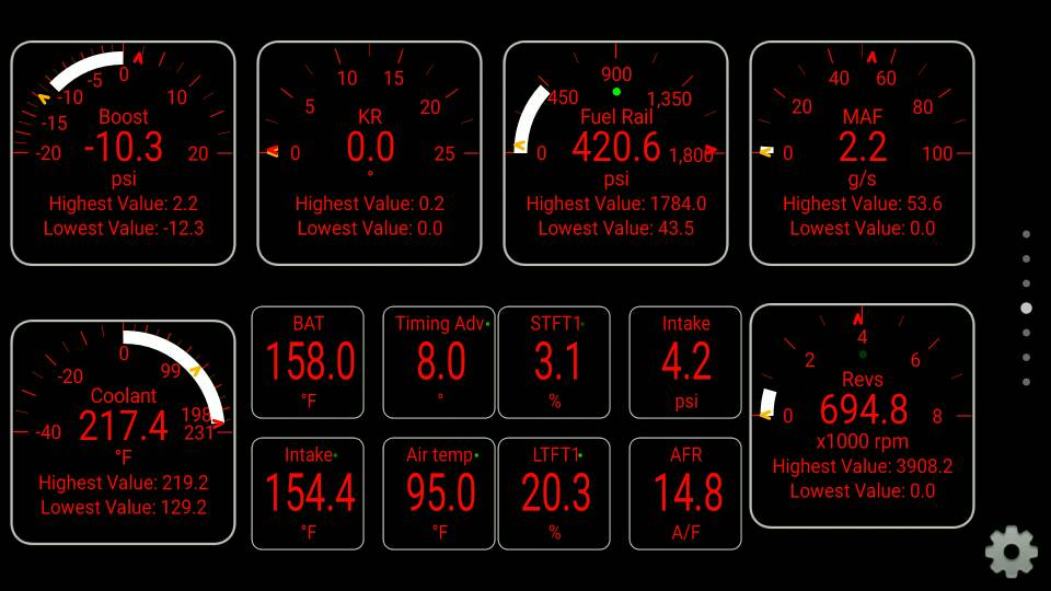

I am using the first one which is the one with the value of 497. This is how how the numbers look.. This is at idle while driving some times the AFR stays a 14.7 but it fluctuates all over 13-15-20

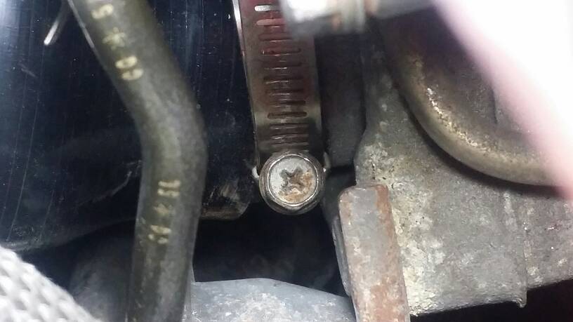

I will check for leaks, once I get a chance. But now that you mention purge valve, I will take a look to make sure everything is connected properly.. The car started running a little lean or rich a few days with my previous intake and I thought it was due to a cracked recirc tube and thats why I decided to just install the whole new intake yesterday.
Since I got the Lean code last night might just follow this and make sure the things in the list are good.. But to keep things simple I am going to first check for a vac leak.

Thank you guys, I figured it out! The problem was that the coupler that goes to the Turbo inlet wasn't seating properly.. I end up having to remove it and added the coupler from the stock tip into the jbr intake to -turbo coupler and it worked.
