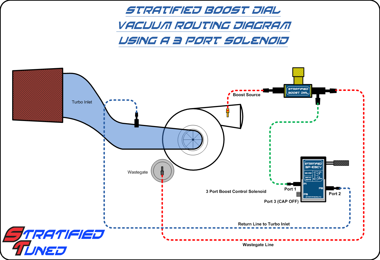

I've started testing my hybrid MBC/EBCS/Stratified Boost Dial approach. http://www.mazdaspeedforum.org/forum/foru...7/#post1928386

Where should I be getting the boost source from on a k04 with stock EBCS?
Sent while losing to TheFlash

The manifold OR the compressor housing. Be aware that the compressor housing has a restrictor built in.
At the moment I have it coming from the BPV line. I have the knob a quarter turn away from being maxed out and I'm still getting WGDC at 100% in the upper RPM's. I'm tapering to 17lbs at redline so I don't think I'm asking too much of the turbo. I'm waiting on a bigger intake and then I will be getting in touch with you for a tune. I would like to have this sorted out before that though.

Are you spiking during spool? What happens if you go further into the + region? Be careful if you go fully to + your WG will see no boost and you will overboost for sure. Port up a log.
I do have a spike and have been working with the WG duty cycle down low to combat that. In the latest revision I have a small spike to 23, I am targeting 22. I have some more work to do because I now have a dip after the spike. I think that log I had the dial a half turn from max, I now have it a quarter turn and will try to get some logs tomorrow. I do have a 3bar MAP sensor so I know what I'm hitting when I do over boost. Here is the most recent log.

Based on your log you may be able to get more boost up top. Target to get 22 psi spool at around 45wgdc and you will need to lower both the wgdc and lec coarse table to start. Turn the dial up as you control your spool to avoid spikes. Also keep in mind that more boost up top may not mean more power.

I've just ordered one of these boost dials and now I'm wondering how to configure my (boost based) software correctly.
Up to now I ran a GS ebcs in 3 port mode with a maximum required wgdc of 63-70 (depending on the temps/weather) in order to reach my desired target boost level of 22 psi, so over all I have a wgdc range from ~55-70 at wot.
Of course I also adujsted boost dynamics and load correction tables (besides some others) to meet the requirements.
Now I have a few questions about the correct start settings of the boost dial, in order to get the best "boost window":
- I intend to start with the blue ring, or shall I start with the red one?
- Do I have to reduce any values (wgdc/bd) or can I just leave everything as it is for the first try / test runs?
- How is the further processing? Which components (boost dial, wgdc, bd, boost targets...) have to be adjusted, what is the recommended order and step size for these adjustments to come to a solution without spending too much time? Is it sufficient to adjust only the boost dial little by little or will I also have to experiment a lot with all contributing (software) parameters?
- What is the actual aim - to reach the same wgdc level (and stable boost) as before?
In principle it should be possible to reach the same boost targets using different boost dial windows (but significant different wdgc levels), so what is the "best" setup?
Mods: BNR S4, 3" Ray cb, CP-E catted dp, CS 3" intake, CP-E tmic, D06-wmi, itv22/NGK IX plugs, Forge bov, hpfp-upgrade, JBR ebcs, 3 bar map sensor, egr block off kit, ACT 6 pad clutch with SL flywheel, Wiseco oem compression pistons, Manley H-Beam connecting rods, reworked head, CP-E SafeSeal injector seals, no E85, Cosworth thermostat

I would start with the boost dial in the position that it is currently.
The aim is to get maximum desired boost in the upper RPM around the 90% wgdc point in warm weather.
During spool you should also not be getting spikes.
Take a look at the example tables posted in the first page here and the instructions document.
Thank's Lex, I just wasn't sure if I should try to keep wgdc quite low (using a red or even golden boost dial setup) or to target something around 90% (using a "softer" setting) in order to achieve my boost targets. You know, there are always several ways to reach the same target state.
So I will probably have to increase my wgdc table significantly. Nevertheless, the main goal will be to have a stable, non oscillating/non spiking boost curve.

After a few weeks of waiting (especially for the German customs) I finally got my boost dial and now I have an installation question:
The 3rd ("middle") port of my GS is not connected to the wastegate, but to the boost source.
So, shall I "deactivate" the port which is now connected to the wastegate or the port "3" in your diagram, which (in my case) goes to the boost source? Actually I would plug the boost dial in the current connection line from the GS to the boost source and connect the tool to the wastegate, leaving the intake line as it is.
I'm a little bit confused...
So, shall I "deactivate" the port which is now connected to the wastegate or the port "3" in your diagram, which (in my case) goes to the boost source? Actually I would plug the boost dial in between the current connection line from the GS to the boost source and connect the tool to the wastegate, leaving the intake line as it is.
Check out our 3 port setup diagram:
http://www.stratifiedauto.com/images...203%20Port.png

I already studied this diagram - there is also a Grimmspeed example in this thread where the installation seems to be different from mine, too.
The basic question is: should I change/adjust my connections so that they are equal to the ones in your diagram or shall I leave everything as it is (because it works and cannot be totally wrong) and just put the boost dial in the boost source connection line and connect it to the wastegate afterwards, deactivating my current wg port? In principle this is what your diagram shows, although you are using other ebcs ports/port numbers.

This evening I wanted to test the boost dial, and...this was the "funniest" test drive ever!
Although I adjusted the boost dial to the red setting (at least for my last run), commanding up to 22 psi at wot (wgdc 60-80), I just reached ~14 psi maximum boost pressure!
Since there are no boost leaks, I was obviously wrong and have to correct my port settings...
But, can anyone explain why (in my case) in 3 port mode the port connections were ok and everything worked fine, but when switching to 2 port mode, I have to change them - probably to the ones on the boost dial diagram?!?
Although I adjusted the boost dial to the red setting (at least for my last run), commanding up to 22 psi at wot (wgdc 60-80), I just reached 15-16 psi maximum boost pressure!
The connections should be as per the diagram whether it's a GS solenoid or a Stratified one. The port numbers are the same. Basically the 3 port is setup in "2 port mode" and it bleeds boost pressure away from the WG actuator line.
EmPeEs6 (07-24-2013)

Finally I've found the reason for my confusion:
If you have a look at the "official" GS installation guide: https://www.grimmspeed.com/install_g...MazdaSpeed.pdf
you can see that the connections for the GS running in 2 port mode are totally different from those for the 3 port mode!
In any case, the boost dial diagram shows the correct settings, which I will test tomorrow ;-)
BTW: The diagram from SarcasticOne on page 3 of this thread shows the correct settings for a GS using the boost dial.
This is why I made those diagrams, to remove any confusion. The port numbers for our solenoid, COBB, GS, are all the same so just follow our diagram and the same port numbers if you have a different solenoid.
