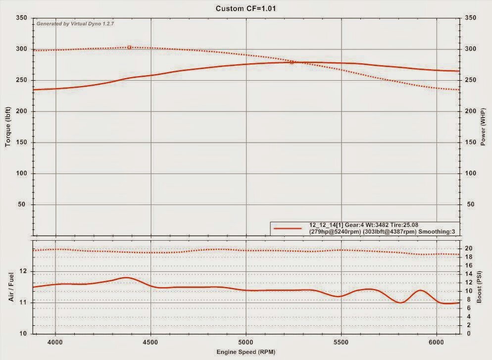

Well finally got a chance to do a log with the S-OTS+ E85 stage 2 tune and attempted a 3rd gear v-dyno graph. This is just a quick 3-4 run. I didn't run out 3rd as this was my first log ever and wanted to make sure it looked okay. It was about 30-35 degrees out at night. I'm not sure if it is running a little lean or if that is just the E85, thoughts?
Relevant mods are cp-e HPFP, FMIC, nano intake, TIP, and dual catback. Also have ATP catted downpipe and synapse synchronic BOV in recirc.

It is running a little lean under WOT but there is no knock. Reply to the e-mail you received the map from with this log and I will have a look.
