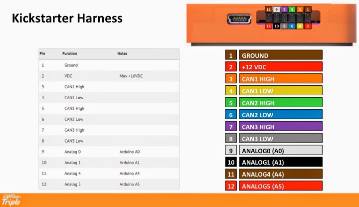

The wires we will be tapping into and their corresponding functions are listed below:
Above Image Credit - Derek @ www.canb.us
Fuse panel location
1. (POWER) Red will connect to the fuse panel on the driver side with the Add-A-Circuit. There are two spots you can wire this in. If you do not have one, you can wrap the wire around one of the ends of the fuse and put the fuse back in.
2. (GROUND) Black will ground to the chassis via the bolt inside the same fuse panel. I have used a ring connector to make it easier to remove and re-attach the wire if need be. It also works just as well to strip a good chunk of shielding from the wire, wrap it around the bolt and tighten it back down.
3. (Analog 0 & 1) These two wires are in the large bundle behind the instrument panel. They are Brown and Sky Blue (both with two grey stripes). Brown will connect to the White wire in our ribbon cable, and Sky Blue will connect to the Black wire in the ribbon cable.
4. (CAN 2) Also behind the instrument panel, but this time in the bundle of wires that plugs into the gauge cluster, the White and Red wires (both with 1 stripe this time) will connect to CAN2 on our CBT. White will connect to the Green wire and Red will connect to the Blue.
5. (CAN 1 & CAN 3) This is where we are physically separating the CAN network. Cut the Grey and Green twisted pair (they are literally twisted together) in half.
-On the left side of our cut, we are going to wire the Grey wire to the Yellow one in our ribbon cable, and the Green wire will connect to Orange.
-On the right side of our cut, we are going to wire the Grey wire to the Purple one in our ribbon cable, and the Green wire will connect to Grey.
