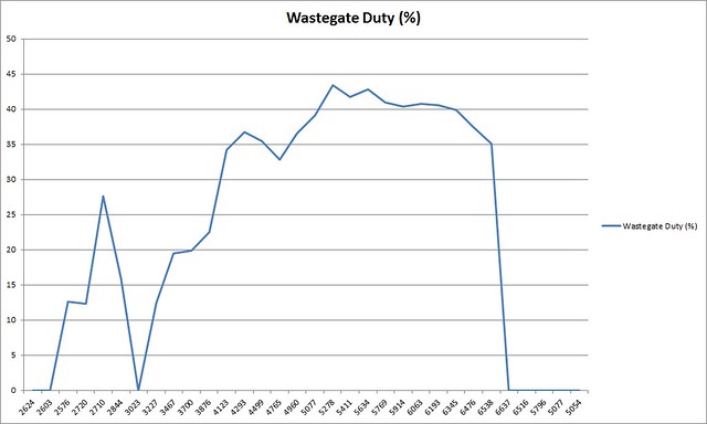

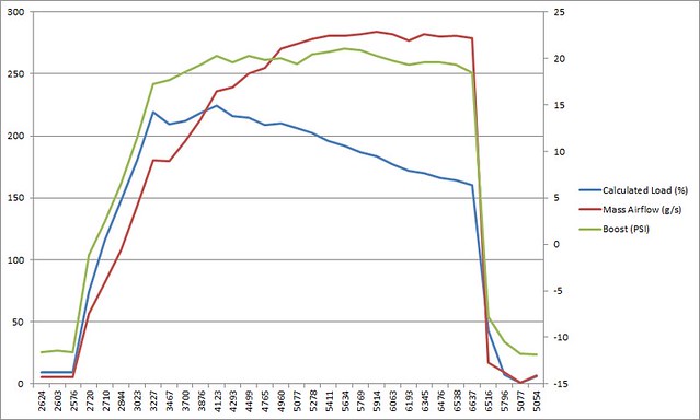

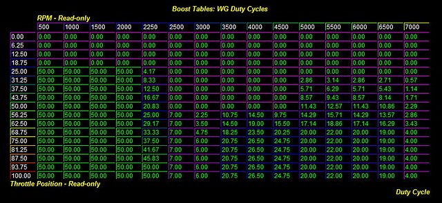

This is my last post in the my WGA/EBCS thread from Feb...as weather continues to warm, I continue to make minor changes to my WGDC...so the WGDC table is slightly different from my current:
It has been too cold to log for awhile, so eventho it was -8*C tonight, I had to go get some...
The last table from the post above gave my a bit of spikes into the 21.x @ 4000rpm...so I played with it a bit...and here's the table:
and here are the results...as close to what I'd like on the street as possible...there's still room for more tweaks...but I'm happy for now.
the is all under boost based tuning with 1.08.
EDIT. I swear I must've forgotten what this thread is all about...lol...

Here are the results of a semi-tuned grimmspeed ebcs. This fucker is a bitch to tune! I have tried Christian's suggestion of very small BD parameters, but I can not hit target boost with them. This is the only way I can hit target boost (see BD). Also, either way, I have some pretty noticeable boost oscillation... to the point where I am convinced I am getting mad KR (which is pulling timing and adding fuel), but it turns out KR is at 0, but boost is vacillating. I need help! Once I get this tune dialed in, I can dyno and be done with this fucking ko4!
The only other problem that I am having is that I am getting some boost spikes up to 22psi! They are very quick, and disappear within 1 to 2 cells of data (and they never produce any KR).
Anyway, on the plus side, I can hit higher psi with less WGDC throughout the power band, and over 19psi past 6k without 100%!
My mods (that matter) are fmic/ram air, pump, catted dp, ap (with ots tune that has only had fuel, boost, wgdc and bd adjusted) and of course, the ebcs.
Oh, and FOBIO, think you could post up a couple logs and maps of your wgdc, bd and boost targets? It would REALLY help me.

Could you post your wgdc and bd table? I want to see how your getting there. I'm guessing your boost is more steady than mine?
