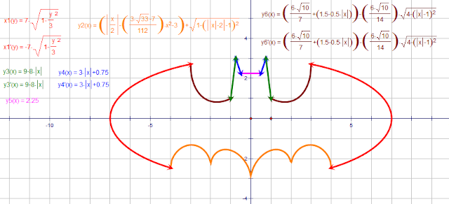

Partial to the Batman curve myself...
Batman Curve -- from Wolfram MathWorld
