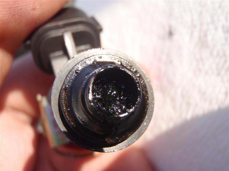

Here is the EvoE thread on injector gunk after running E-85:
Injector Gunk after 2 months of E85 - Evo Empire Forum
Here is one from EvoM on injector gunk after running E-85:
3 tanks of E85 and look at my ID2000's! unreal! - evolutionm.net
John is offline
 Old 05-11-2011, 11:19 AM   #44
I am not convinced that is gunk from the tank. It is more likely a reaction E85 is having with vapors or fluids in the vehicle. Almost looks like oil sludge.

So all this gunk build up is from running 100% E85. If one were to run less than 50% will it still be a problem or would it just be significantly less of a problem?
Reason I ask is because I'm getting some E85 tomorrow and intend on letting Dustin take a crack at tuning it (at 30-45%). I may even have dyno results tomorrow if I can squeeze in after my friend who is dynoing his 100% e85 cobalt ss/tc...
Well, we don't have a definitive answer on what the gunk actually is. @driver311 has been testing the waters with E85 mixes and hasn't mentioned any problem like this (his thread is a great read if you haven't checked it out). I ran a 50% ethanol mix for a while without issues. It could be happening more slowly with less ethanol, but I'm not sure that I would count on it not happenning, at all.

Calvin, excellent information, thank you. Very sorry to hear about the blown engine. It's also too bad that E85 testing hasn't continued on your end. I am seeing positive results, despite the spill valve solenoid. I believe a fuel filter is in order for anyone considering doing this.
It looks like I will be able to run an in-line filter in the soft line immediately before the CDFP. It's a 5/16" line, and I think I can splice into it, directly. If not, the ends (with the blue ring lock) can be reused in another hose, I believe. Finding a filter that fits the bill has been a little difficult, as many filters are not advertised as E85/alcohol compatible. The ones that I do find are often for carb'd, low pressure applications. I'm going to call Summit tomorrow morning and get their recommendation.
The spill valve that I cleaned and re-installed lasted for ~170 miles without a filter, this time. That's significantly more than the 30-35 miles, before. The solenoid takes about five minutes to swap, so it's not a big deal right now. It looked much, much better this time around. There weren't any deposits, like before. Just a very light residue.
I have most of the MAF curve nailed down. I have been focused on the "driving" range and the upper end of the calibration. The idle range is still a bit rich, though. I will post my last known good gas calibration and the new E85 calibration, once I am satisfied with it. It should be revealing and may help out others looking to do this.
Before I did any WOT testing, I significantly lowered my entire WGDC table so I wouldn't run any more boost than the wastegate spring allowed. I did this due to the high injector duty cycle that I mentioned in my first post. I also didn't really know what kind of loads to target, so I just raised the load targets to 4.00 over the entire range. This worked well, as I was able to see the actual load values at low boost. This method then allowed me to find the minimum WGDC required to raise the boost pressure over the entire RPM range. [This isn't the only way to go about it, but it worked for me.]
So the wastegate still wanted to work a little bit, even though I lowered the targets. These are all 2800-6100rpm runs in 4th gear. Don't mind the AFR's in this graph, I was still working on them at this point. This is what the load and boost curves looks like brake boosting into 4th gear:
If you can't read the text at the bottom, load is the tallest curve (scaled by x10), boost pressure is the next one down, AFR is the mostly straight line, and WGDC (scaled to 1/10) is the line at the bottom (mostly 0). The peak load, in every run seen here, is right at 4,500rpm. This is about where peak torque occurs, so it makes sense to me.
In these same runs, I was logging injector duty cycle, but not injector pulsewidth. I have found that 100% injector duty cycle doesn't really mean 100%, and we can go beyond 100%. I posed this question on the Cobb forums, but haven't received a reply, yet. What does 100% mean for us? Thus far, I have seen 103.xx% injector duty cycle, but the injector pulsewidth doesn't flatline, and I am still achieving target AFR's. This is what injector duty cycle looks like:

So that's where everything is at, right now. With Calvin's note, above, I think it is best that I drive as little as possible until I get the filter in place. The semester is finally over, so I don't have to drive to class any more. I don't drive to work, so the car can just chill out for a couple of days.
As for how the car feels: it is easily pulling just as hard as it was on 93 octane in the same type of weather. Mind you, this is at less boost and only 1* additional timing as compared to the 93 tune, as the turbo was completely maxed when I was running it on 93. I think there is huge potential here.

Did the motor run after you ran the E85? If so, chances are that "gunk" was also coating your injectors and perhaps caused it to stick open.
As for duty cycle, I believe COBB calculates 100% duty cycle as injector firing the entire intake and compression stroke before the spark event. I am VERY curious where the injection event moves past 100%. Does it move past the spark event? Or does it move into the end of the exhaust?
I think injector sizing is going to be the biggest issue running straight E85 once the gunk issue is sorted out (What happens when you mix oil and E85 BTW?)

I changed my oil today, so I had an empty gallon jug of Rotella T6. I threw in an E85 sample I pulled to check for contaminants, so I'll take a look at this tomorrow.

Alright guys, I've learned some things today. Another theory for the black gunk is electrolysis. When I was searching for fuel filter options, I came across this thread on a mustang forum: Fuel Filter E85? - Page 2 - SVTPerformance
The above thread is great for two reasons: The electrolysis theory, and that I might just need to ground out the pump body to rid the system of any excess voltage. And the second reason: the fuel filter that is highlighted in the thread is a stock ford part, with seemingly identical hose barbs that we find in our cars. The guy was running it with straight E85 with no ill effect. Here's a picture of one of the filters:
What I think this means is that I can purchase another one of the intermediate soft lines that goes from the firewall to the CDFP, and mount the filter somewhere in that region. I called one of my Mustang crazy friends, and he says the stock 03-04 cobra filters are supporting over 400whp and 100psi of fuel pressure with a kenne bell boost-a-pump. A viable option, right now, and one that I can put in place this week.

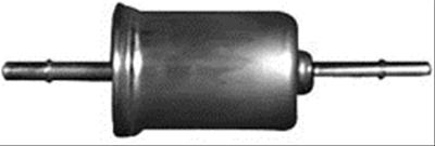

We have a winner for the fuel filter:
The hose barbs are almost identical, just about 1/8" shorter on the cobra filter. I'll order the line tomorrow, from Mazda Motorsports. In the meantime, I'll have to figure out where to mount the filter. It's a little bigger than I expected, but I think I can tuck it right next to the firewall between the battery box and a heat shield down there.
While I was out messing with this in my garage, I went ahead and wired a direct ground from the CDFP's bottom bolt to the negative terminal on the battery. Once the filter is in, we'll be able to pinpoint the issue even further. I pulled the CDFP and cleaned the spill valve and pump internals, so we can see any change. The internals were pulled ~200 miles ago the last time, and they didn't look as bad this time around. I'm still hopeful about this working out.
I poured the ethanol/oil mix into a glass jar while I was out. It is milky, not anything like what we saw on the internals. When I pulled the sample, it looked clear and nothing settled out after leaving it for a few hours. BUT, that does not mean it doesn't contain anything. I'll let this mixture sit, just in case it does precipitate.

Alright, I talked to one of the guys at Fuel Injector Cleaning Service : Cleaning Fuel Injectors : InjectorRX.com. He was especially helpful after I told him I was converting to E85. He was emphatic about the need for some type of filter in a direct injection system. He said he has seen countless direct injection pumps damaged by the dislodged dirt in fuel systems. He suggested a 40-60 micron filter, and that a finer filter may create drag on the system. He mentioned that cavitation in a direct injection pump would almost surely cause immediate failure.
He was familiar with our type of injector, as they are used in other cars. He says the problem isn't usually with them sticking open or closed, but the spray pattern being disrupted by buildup on the injector tip. He mentioned flow capacity being an issue with some pumps, and I mentioned I had a higher flowing pump due to the KMD internals. So I mentioned that I would like to run higher pressure in the system. He said these injectors (yes, the ones that our cars use) can handle up to 3,000psi, if they are in good working condition. He said the flow rate of direct injection injectors is linear with pressure.
This guy was super helpful. He spoke with a western european an accent and I didn't catch his name, unfortunately. He was telling me about direct injection systems in some European countries running anywhere from 30-40:1 AFR's and that new systems being introduced have pushed that out to 72:1 at light load (cruising loads). This is where we got into the importance of spray pattern in direct injection engines. Apparently, if it gets disrupted at all, it has a pretty significant effect on power and drivability.
With all of that said, I'm going to send my injectors out next week. I need the car this Thursday and Saturday, and I'm comfortable with that since the filter will be in place. I'll take that time to clean out the high pressure line to the fuel rail, and the fuel rail itself. After I get the injectors back (which will take about a week with regular shipping), everything should be nice and tidy.
I think I may take this time to do injector seals and the high pressure relief valve, as well.
