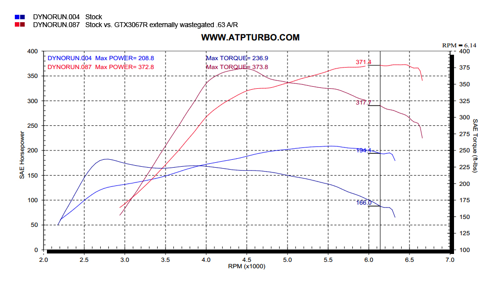

So did they or did they not reach the fueling limit?
The best dynos I've seen is an ATP turbo setup that hit 372 whp on the standard fuel system.
No idea if fuel was a limiting factor yet or not.

so a 550whp turbo is choking up at 370?
sounds like ford didn't bother to do anything in the of increasing flow anywhere from the disi, in fact it looks worse.
Tuning is probably not refined yet
I think they just slapped a COBB stage 2 tune on it. If I'm reading it right, they've since move to a different turbo for their development. This one just has the highest hp I've seen on the stock gas system.
Yep.
Not bad for 91 Octane.

Where are you getting this info from?
They post over on
Ford Focus ST Forum
Got the dyno off their site:
DYNO-DATA - 2013 FOCUS ST 2.0L TURBO : atpturbo.com
as far as I can tell, they are still fine tuning a couple of turbo options for the ST.

Horsepower is only part of the equation, rpms is the other. 370+ whp at 6500 rpms is slightly better than us, if not right on par ... i know on 93 octane alone my car would start breaking up at 100%+ IDC around those same rpms when i started turning the boost up. Not sure what the IDC looks like on this car, but i also have a hard time believing its making that power on 91 octane alone (i.e.: meth injection).

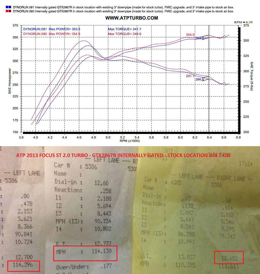

Do you have a link to the thread?
Here's one they did with the GT28 turbo, can't find one with the big boy.
Atp turbo ran 12.9 107 gt28 bolt on
and here's a slip and dyno from the GTX2867R
http://www.atpturbo.com/root/release...3focusdyno.jpg

ATP turbo has promising results so far with that car. Excited to see where this goes though! I can't stand the focus boards, everyone there is so noob and only cares about gay shit like mudguards and painted calipers.
