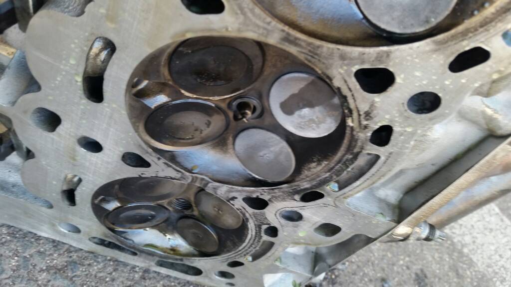

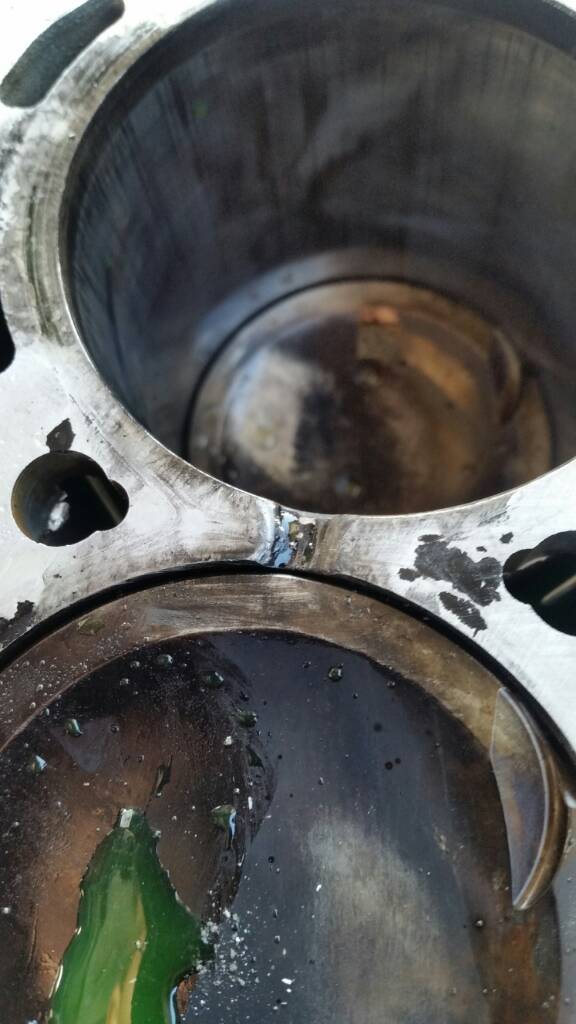

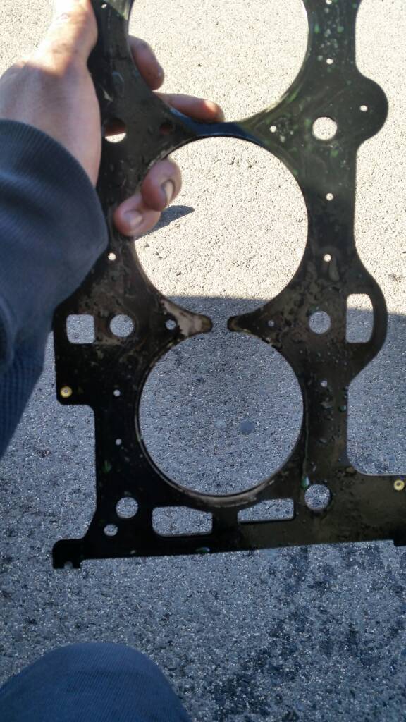

Selling/parting it out.
Pulled the head and both the block/head is burnt in between cylinder 1 and 2.
The hard line fuel feed oring cracked and when I did a pull I lost fuel pressure. Caused a super lean condition for literally 3 seconds.
Gonna throw a stock engine in and sell the car.
