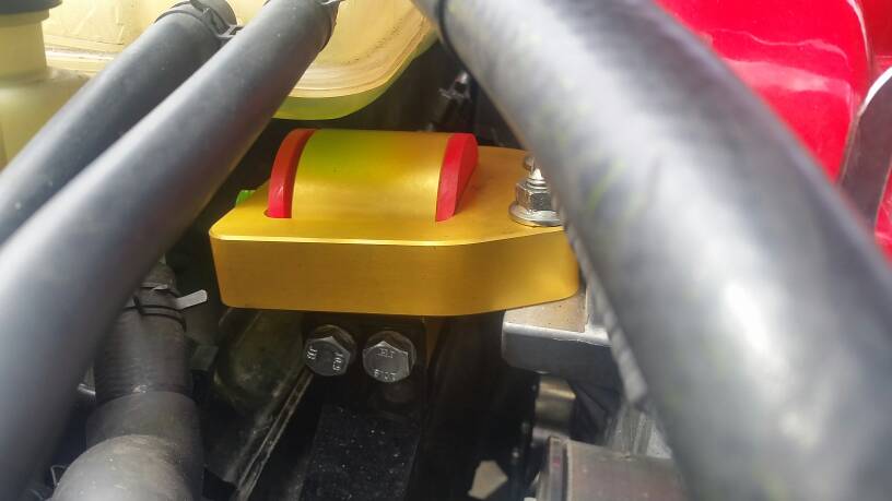

@Nano91; will be installing these tomorrow. Not sure if live pics have been posted yet but here it is.Attachment 184573
That pic doesn't do the gold justice. I'm jealous I can't run it on my car. Guess we'll just have to make more 6 parts and anodize them gold.

Mount is installed and boy o boy, this mount is the awesome!
I've read and heard that pmm give unbearable vibes, but I can barely see a difference after installing.
Let's begin, first the mount looks awesome wasn't able to pick out my colors as I was last, but matt said it's TITS I said ship it to me.
Wow will post pics later.
Gold and black looks awesome.
On my car I only had DM RMM now that one has its vibes that were rough, after installing the mount these vibes from RMM have actually gone down instead of worse
I do get small vibration on my side mirrors at 1.5k RPMS bit while driving it doesn't shake anymore, I do notice minor vib. On my rear view mirror at moments but nothing that is annoying, I can still make cars out and see pretty much clearly. That's all I have to say I have told matt a few things that might help with installing since mount seems to be slightly off when bolting down but nothing alarming real minor. Will post review just heads up for those who are wondering pics coming in over weekend weather sucks right now

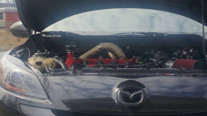

Got the DM PMM installed today, and I'm impressed. After riding in a car with the JBR trilogy, I was pretty set on just sticking with the OEM PMM, because it was an instant headache. After getting this guy in, the noise was a bit more noticeable, but the vibes didn't really increase. My rearview mirror is never clear anymore, but that might get better after it breaks in. I love the look of the piece, and it was pretty easy to install using the jack to support the motor. I currently have the CS race RMM 70d, but will be going to DM's RMM, since the reviews on the combo are great. Very happy with the piece, functionally and aesthetically. The motor is locked in and shifts are even tighter .
