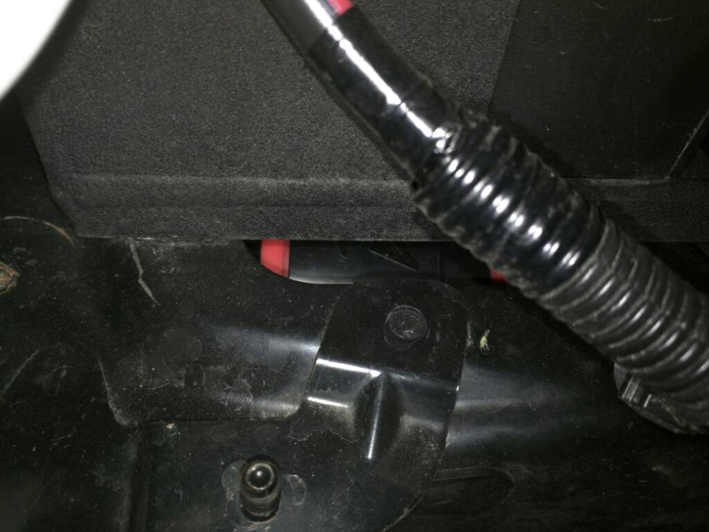

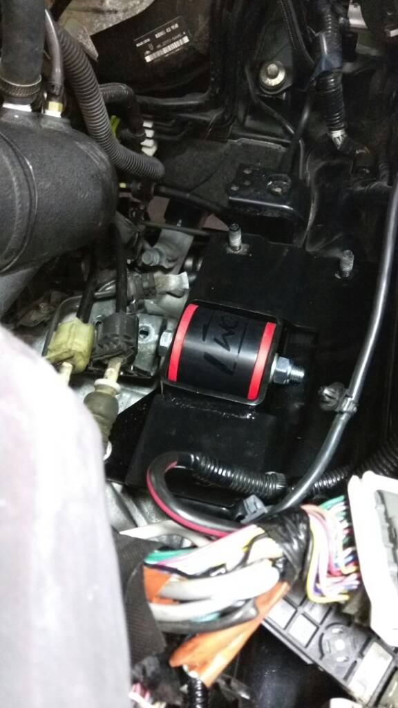

I had another manufactures 88 duro trilogy on my car initially. My mirrors were useless, hot/cold starts were rough, 3k rpms was terrible, ac was vibe was bad, there were vibes but they were solid mounts and they did the job they were supposed to do. I'm not knocking my previous mounts, but those are my observations from having them on my car for 12k miles.
The DM mounts, I swapped my rear mount initially for the DM rear mount and there was a small decrease in the vibrations. I drove with that for about 5k with my other manufacturers 88duro mounts. I was given the opportunity to jump on the testing for the DM mounts and I immediately said yes. Once we got them in my initial impression was I can use my mirrors again, hot/cold starts are great, ac vibes are still there but much less, the 3k vibe is now 2500 and I'm never there so that's great, you still get vibes but they are much less. Above 4k the car will still sing, but that is awesome. I told Matt that the only downside was I had to sell my other mounts at a discount. Not because they don't work, but because there is a better product on the market.
I've got 3k on my mounts, part of which was a 1k trip to Colorado, and I love getting in my car. The race car was getting old, but these mounts have made me fall in love again. Every manufacturer that is of any worth makes great parts for our platform, it is just that these mounts in my opinion do it much better. The only way it would be better is if they included a hot chick of your choice with each order. Whadda ya say @MATT DAMOND;

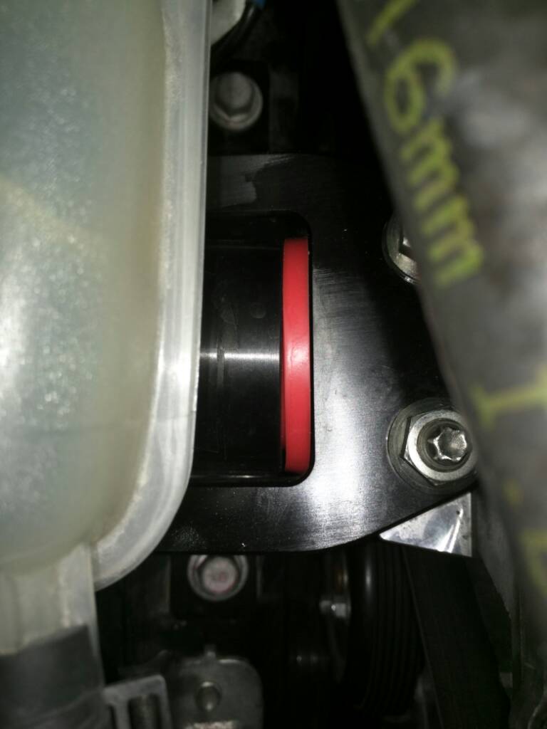

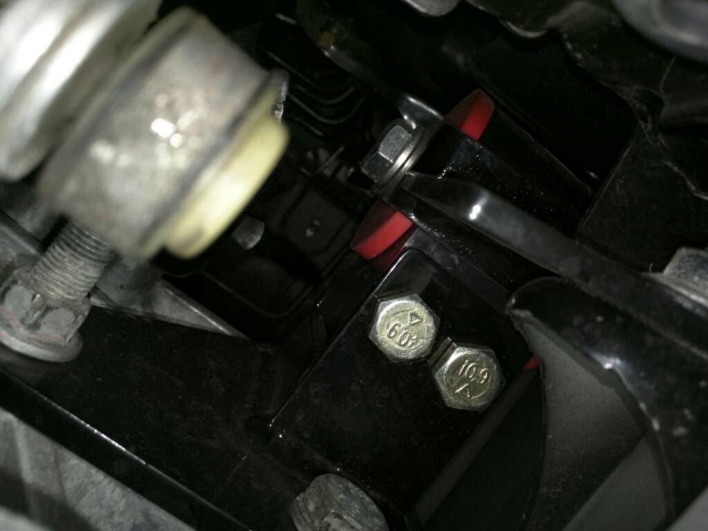

Well, these have been on test cars for a while, maybe someone can chime in with pics (and mileage) of the alpha test mounts as they currently are on the cars.

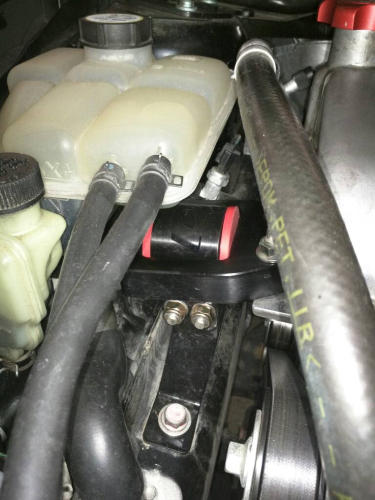

Tmm
Pmm
I've got 3k on the mounts.
tapatalk, it sucks
WetzMS3 likes this.

Around 2.5k on the TMM. Probably near 12k on the PMM. A bunch of passes on the drag strip on street tires on both.uploadfromtaptalk1438734640907.jpguploadfromtaptalk1438734686511.jpg
