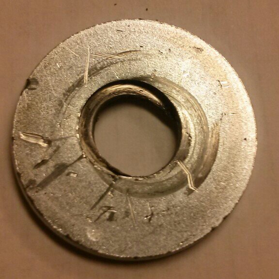

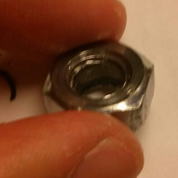

@mdl3v8, @nindoja
I think the problem I am having is that the hole in the bracket on my transmission is too large. Before anyone asks, the bushing is still in it and so is the metal sleeve. Furthermore, the sleeve has no obvious tool marks, so I don't think the previous owner drilled it out.
I can rock my car forward and back and watch the trans mount slide around in the RMM. This caused massive clunking and insane vibrations. I hope I don't need to buy a new bracket.
I will try to have pics up soon of the size difference. Also, I tried using shim stock to fix it, but it only cut down on the clunking.
Edit: I just checked, a new bracket is 30 bucks. I might buy one just to check it out.

@nindoja; @YoursTruly;
I installed my mount yesterday after reading your post about the bolt being a little small for the transmission bracket. I am coming from an OE mount, and so I played with the stock hardwares a little. For as far as I can tell, the DM mount is spec very close to OE. The stock bolt is also slightly smaller in diameter than the hole in the transmission bracket.
After assembling the motor mount (both DM and OE) to the transmission bracket off the car, both mounts wiggled a little in the transmission bracket. However, after installing this assembly in the car and torquing everything to spec, everything is solid.
I will be test driving the car a little later today and will report back with initial impression.

@nindoja; @YoursTruly;I am coming from an OE mount, and so I played with the stock hardwares a little. For as far as I can tell, the DM mount is spec very close to OE. The stock bolt is also slightly smaller in diameter than the hole in the transmission bracket.
Interesting that they are both slightly smaller. What torque specs did you use on the bolts? Same question goes to you @YoursTruly;

I woke up a little early to swap out the washer and sure enough, the provided washer was up against the bolt. (Pic 1) so, I replaced it with a washer from my JBR 70a, go to torque it down and couldn't get to the 40ft-lbs, it just spun. I guess when I was trying to torque down yesterday, with the washer hitting the shoulder, I completely stripped out the nut. (Pic2, sorry for the bad phone pic)
So, I used the JBR hex bolt as a temp and torqued to 40ft-lbs.
Off to the store this afternoon to pick up a new washer and nut.
Pic 1
Pic 2
