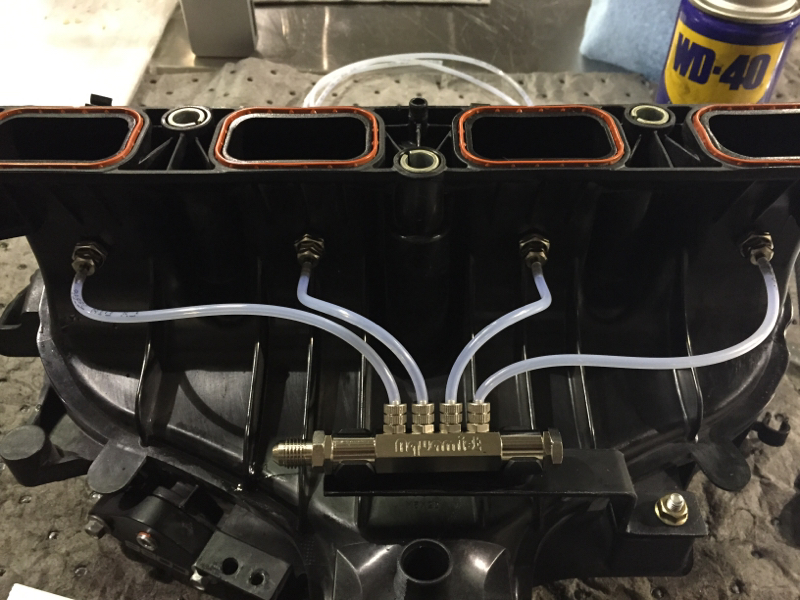

So here's a glimpse of what we've been working on, and plan on making a kit for on the MS3 and MS6 platforms.
More info and data coming thoon...

I understand the PI aspect.. But why the plastic mani from the ST?

I don't know anything about their manifolds so just a couple quick questions
They have the vtcs too? Or are the codes still going to be a thing?
How much does one of the st manis go for second hand?
Will the kits include a way of routing fmic piping or is it something you can easily grab?

No VTCS in the ST manifold. Also given the price of the manifold new ... well if it fits this is a win for the community.

IIRC in reading other forums the ST manifold flows nearly as well as a JMF and costs less than $100. Boy do I hope this becomes available soon.
Balanced flow. The ST intake manifold goes straight down with 1&4 and 2&3 runners being equal length, instead of the drastically-sharp bend that air needs to make with the stock intake on our engines.
Focus ST Intake Manifold flow bench tested:
Runner 1) 331 CFM
Runner 2) 336 CFM
Runner 3) 329 CFM
Runner 4) 337 CFM
Total) 1333 CFM
~2% flow imbalance
Mazdaspeed Intake Manifold:
Runner 1) 199
Runner 2) 235
Runner 3) 233
Runner 4) 192
Total) 859 CFM
~20% flow imbalance
Will the Focus ST plastic manifold go bang under boost?:
Realistically, probably not. It was pressure tested to 27 PSI on an ST head, which turned out to be the static float point of the stock intake valves (point at which the head leaks boost into the cylinder):
https://www.youtube.com/embed/0A00YmHuooA
Later on,it was pressure tested to 110 PSI on its own (sitting in a big bang proof enclosure) which only resulted in blowing couplers.
https://www.youtube.com/embed/_uZGSsZH7YE
Edit: Food for thought:
TL;DR: Can't argue with hard data, that plastic manifold is legit.

There are a lot of similarities between the ST and DISI ... like the throttle body bolt pattern and sizing .
Also this really opens up the ability to run under-engine intercooler piping.
There are also advantages to plastic:
- heat rejection
- weight
- cost
