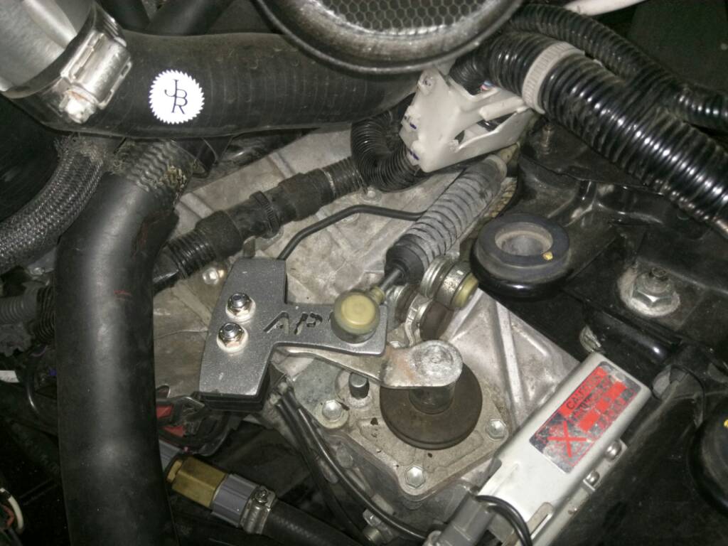

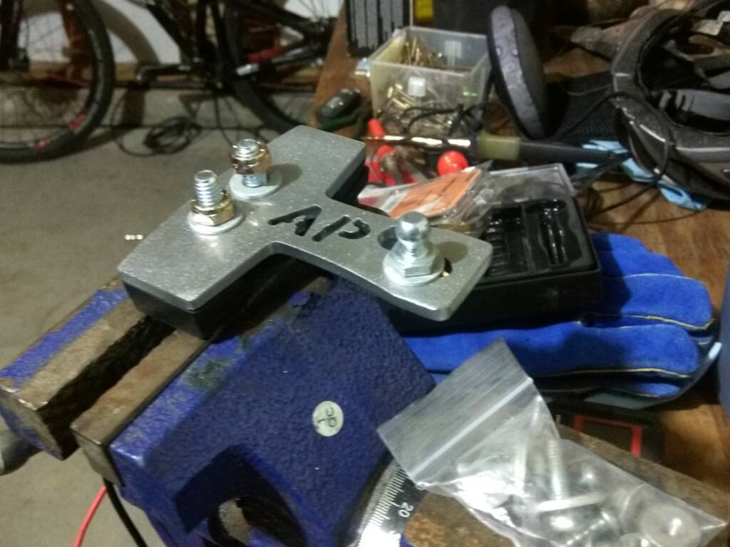

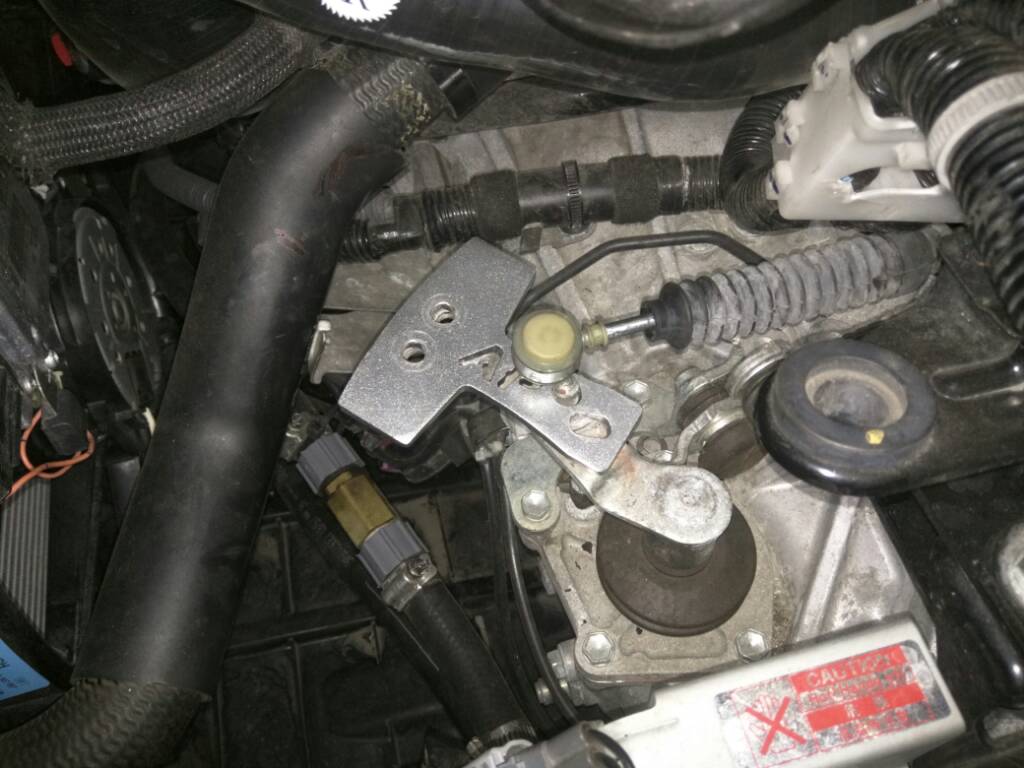

Weather has cooperated a bit today and I got a chance to install the setup. Twice actually, details....
First, initial impressions before install:
-The adjustability is cool, I like messing with things and this will give me plenty of options. I had plenty of knob/weight/plate setups on my gen1 before I finally settled.
-Unique design with the plate acting as its own weight, not sure how this affects things but it's different
-The weight setup makes things a bit more complicated with the hardware...not difficult but also not as simple as threading a bolt into a block
2 initial gripes (small ones)
-The hardware is mostly standard. I would prefer all metric to match the car for commonality. This isn't an actual issue just a personal annoyance
-The finish is already wearing a bit after just one install. Fixable in production.

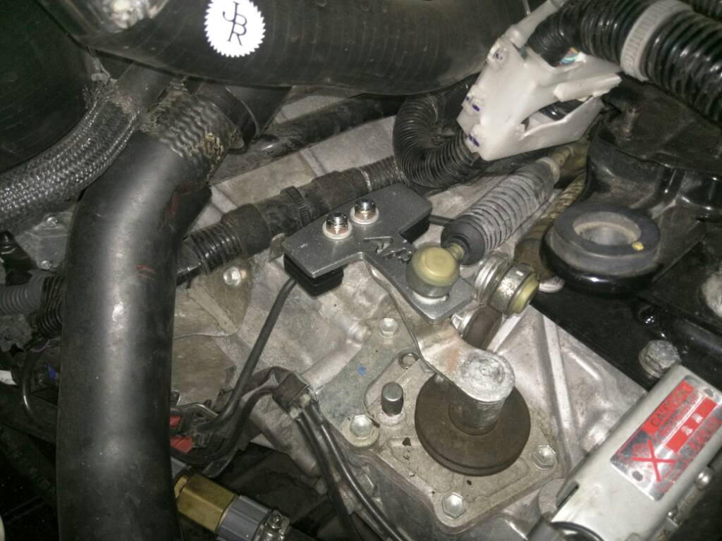

Install is straightforward just like all plates, pop off the cable, unbolt the weight, tighten new ball into place, install plate, replace cable. 5 minute job. No complaints here, went as smoothly as any.
Only current related mods are a Cobb shift knob and JBR solid bushings. I like the Cobb knob because it's delrin and stays temperature stable. The bushings so basically nothing IMO but I already had them so I swapped them in.

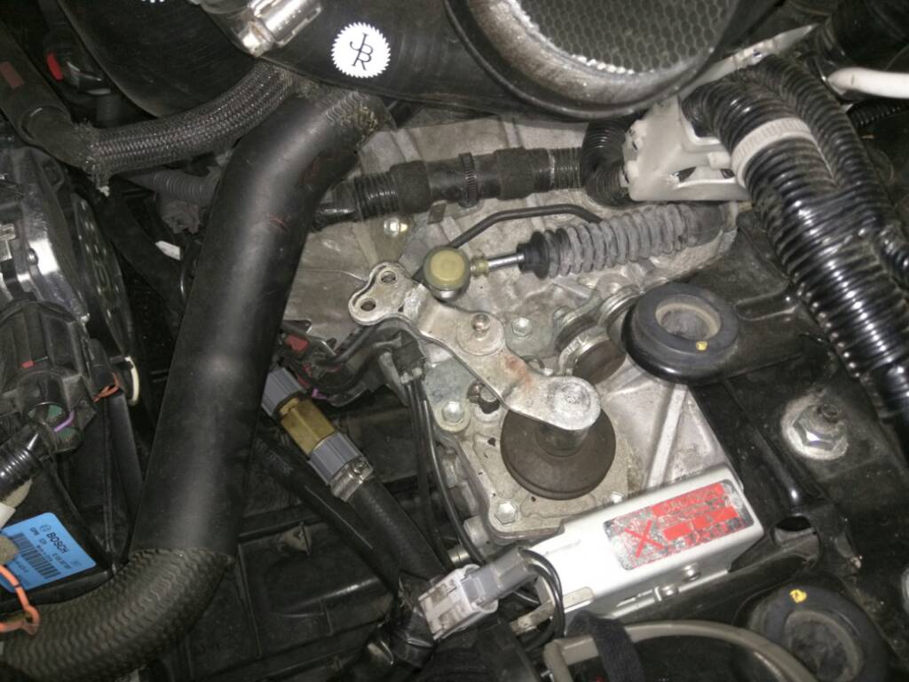

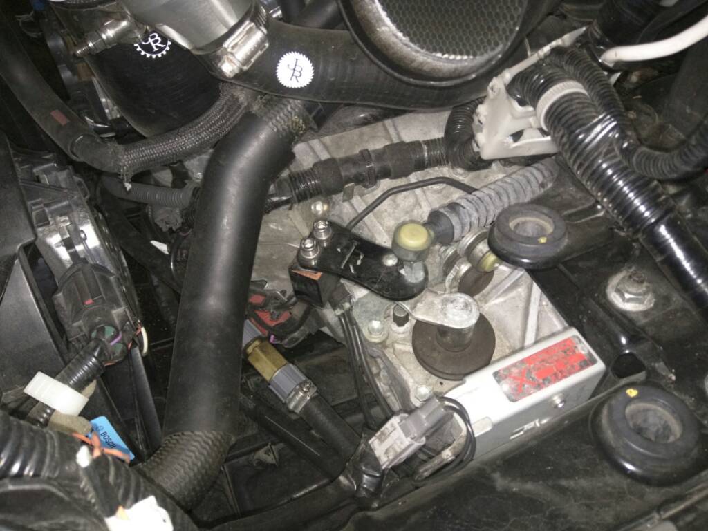

With my initial settings I tried to emulate my previous plate and weight combo, JBR plate on shortest throw with stock weight. Of everything I tried this was my favorite.
I set the plate to the shortest throw (supposedly 30% according to @Turbo_Steve with both plates. Took it for a drive.
IMO, the shortest setting was too short. Like, miata short or shorter. I always thought throws this short would be nice but the car gave little feedback that it was in gear at all. Throws also took more force than I wanted and the feeling was both stiff and notchy..not great. Half way through my drive i swapped to the stock knob and things improved, shifts still took a bit more force than I wanted but the notchiness wasn't as bad.
Went home and changed it up quickly, moved the ball to the longest setting, removed both weights, and went back to the Cobb knob. Second test drive.
This one I like. A lot. Shifts are about where they were with the JBR plate on its shortest throw setting and are notchy but not in a bad way, they feel more "aimed". Removing both weights solved the heavy feeling. Setting the throw longer definitely shortened it up from stock but feels much more confidently in gear than the shortest setting.
These impressions are after a few minutes of driving each setup. I'll do plenty more driving over the coming days and weeks and will update accordingly.

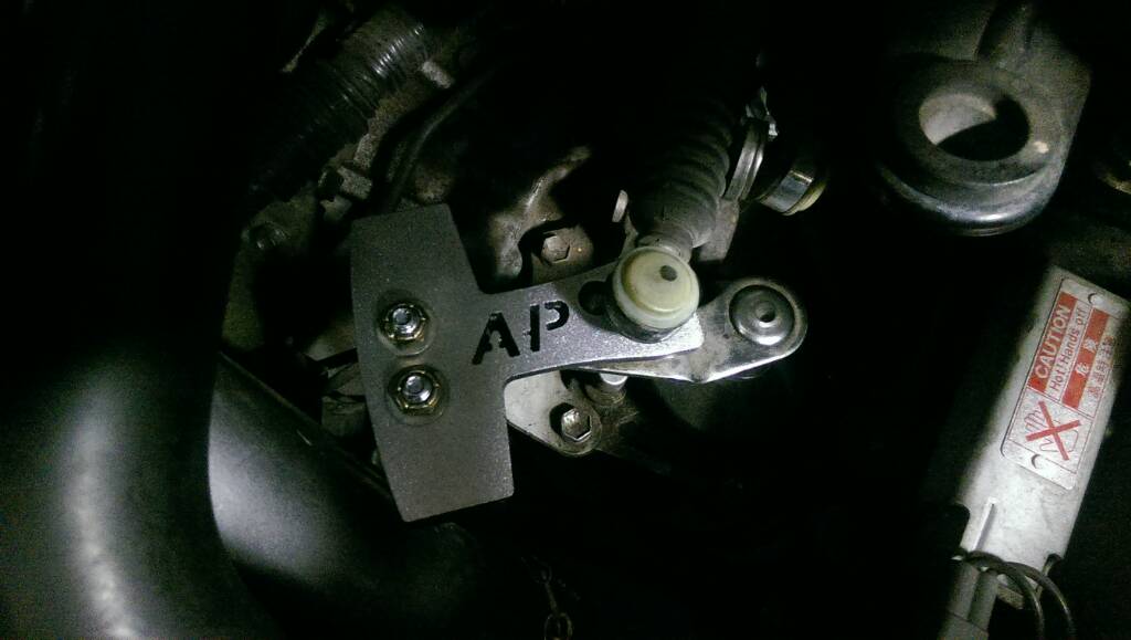

I personally love the feel with only 1 weight plate and the stock knob.
& to answer the question about the hardware being standard vs metric thread. The ball stud I use is only made in 5/16 - 18 thread. So I opted to inlcude 5/16 - 18 nuts and bolts for the plates so as to not have an issue with mixing up hardware on all three locations. I could switch out the long bolts and nuts for M8 hardware in a production version but I have not thought much about that yet.
And yes, production plates will be powder coated. The prototypes are iron oxide coated and then lacquer coated for corrosion resistance and then painted.

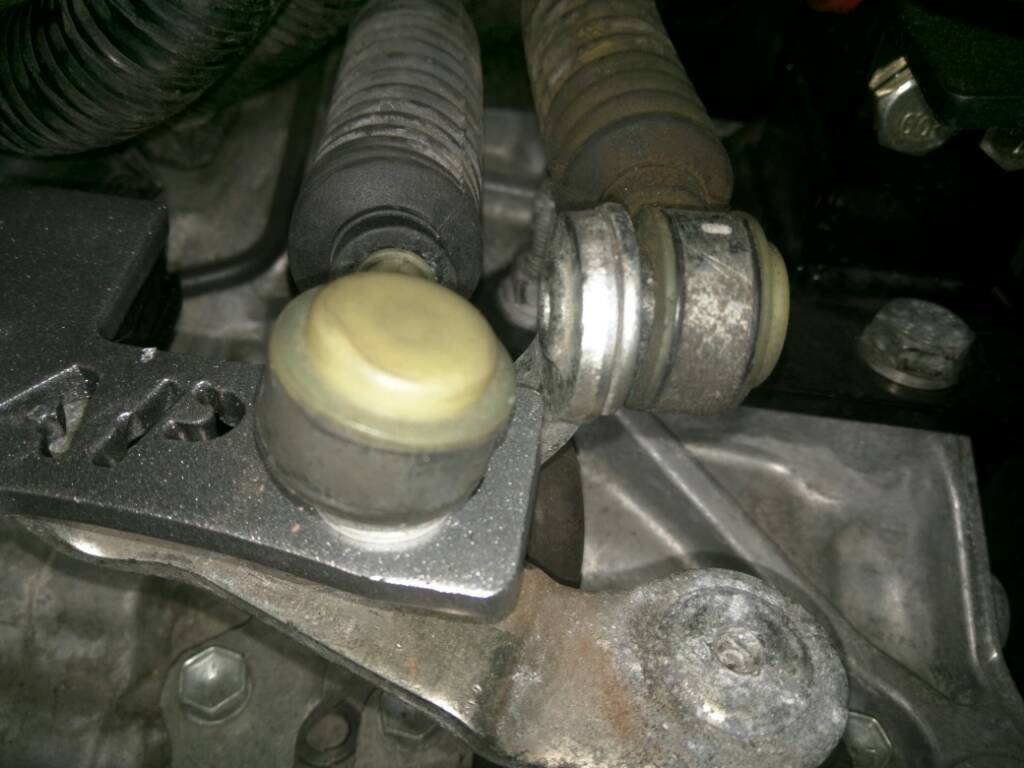

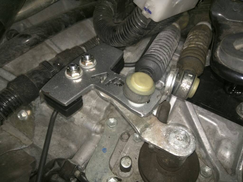

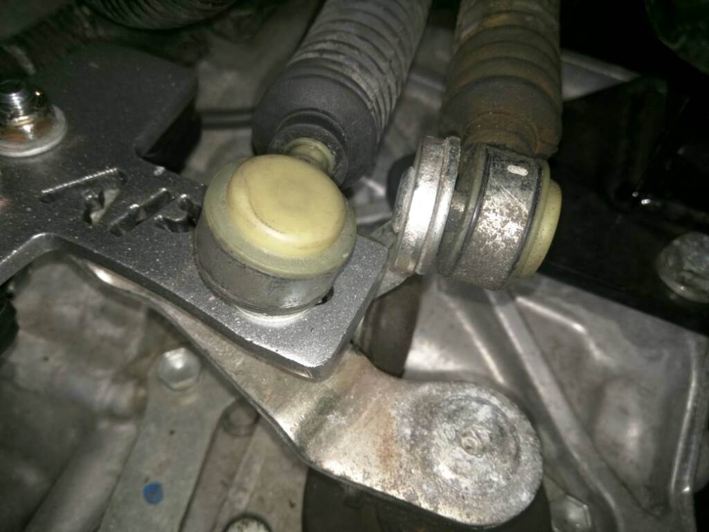

We did discover a potential flaw in the prototype as well which I already sent pm's to my testers on. I will just copy and paste the PM below in the interest of full disclosure.
"We may have already found a minor flaw in my design - Nothing to worry about, but the first tester had some issue with the plate contacting some shift linkage in his car.
The solution was to grind away the corner slightly on the top plate as pictured. I would advise grinding it before installing as shown below.
The problem was only evident when shifting into 2nd gear.
Here
My plate does not stick out as far as the jbr plate in this spot so when I was designing it and the fact that I had no issue in my car I didn't think anything of it.
1:1 Scale printout
But I will be revising the design on the plate regardless. And as a tester when a final production version is made I will send you a production plate with a nice fancy powder coat on it.

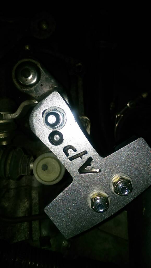

Initial thoughts - i thought it looked cool as hell and really liked the adjustable weights. I've been running a Cobb short shifter for a long time now and originally had the CP-e CAI with which the stock shifter weight made contact. i had to get the small Cobb weight as to not damage the intake any more. even after the intake was gone, i was running Cobb intercooler piping which again, limited me to the Cobb weight. This plate with shortened weights allows plenty of clearance to the IC piping.
Install - Install was as to be expected, 5 min install. first run through the gears had me very excited. the throw was much more even than the previous plate i tried. all the gears had solid engagement with the exception of 2nd.... after being sad that i wouldn't be able to test drive it immediately, i had to remove it until i got to work to grind down the corner that was interfering. after grinding the corner just a little bit, everything fell right into place and all gears were solid.
First drive - Holy crap... combined with the Cobb STS (adjusted for shortest throw)... this thing is ridiculous. the throw is incredibly short, yet doesn't feel like anything has to be forced. my normal input is all that's needed to solid shifts. gave her the good old 2-3 shift using FFS (via AP) and BAM, right in. Now, maybe i was very focused on hitting that gear, but i haven't felt a shift like that in a long time. i do a lot of drag racing and I've always held my breath for whether or not 3rd was going in. i also ran a 1/2/3 shift and, hot damn, it felt good.
Continued testing - i will continue to bang gears and try to focus less on the shift to see how it goes. will be hitting the drag strip mid October and that will be the main test. i may even try FFS without using the AP feature. I've always preferred to flat foot it without the assist of the AP.
Keep up the good work @Turbo_Steve; i think ill be enjoying this one for a while.

I'm also going to try first installing the plate un-modified to see if I have the same issue as the other tester.
Fyi I already have re-worked the design. IMO 1 car with the problem justifies the re-design.

I need to get more pictures tomorrow, ran out of daylight today. I also ran into a slight issue with mine. Because everything has been pulled out of my engine bay a few time and my harness has been replaced the shift hammer actually hits my harness. I have the harness adjusted enough for now but will need to tweak it more tomorrow.

Got the shifter plate installed tonight. On my pu it looks like the plate was very close to hitting the shift linkage. I removed the plate and ground down the corner per @Turbo_Steve; direction. This will be fixed if it goes to production. Now onto the fun stuff, the review.
Setup: JBR heavy cylindrical knob
Solid shifter bushings
DM trilogy mounts
Lucas synthetic gear oil with friction modifier
My initial impression was the car shifts much better sitting at a stop and driving than before. Much more direct and it has a notch to it that wasn't there with my jbr plate/weight. This could be due to the weight or the design, I'll adjust weight to see what difference it makes after getting some miles and I'll update. The first drive was actual very enjoyable to rip through gears, it wasn't a long drive, but it was a good drive. Once I'm able to hammer on the shifter I'll update how it fairs when shifting 2nd to 3rd. That's usually the trouble spot. I've also had times where I was not able to get into first for no reason. I'll see if that happens in the coming days. I'm probably driving 2k miles next weekend so I'll be able to get a good impression of how it goes. I'll have 2 of my fellow Nator with me and I'll see what they say when they drive. I must say so far I'm extremely happy with the limited time with it. The shifter feels much more alive.
tapatalk, it sucks

Uhg, life keeps getting in the way. I did manage to get the wire harness adjusted out of the way so that is fixed. I only did some minor grinding to the plate to give it a little extra clearance as suggested. I have yet to adjust the cables from how I had them set before and I have noticed that my shifts are slightly shorter then before and my 2-3 shit is better. I also notice I now have a lock out of 1st like I had before so a slight adjustment to the cable should fix that and make my 2-3 shift perfect.
My car is back at Mazda for a couple of days to finish fixing what the body shop screwed up, once I get it back I will finish getting pictures and do a full proper review.
What plate combo is everyone running and what position on the for the ball-stud? I have mine with one plate and the ball-stud set to the shortest position (farthest from the weight). I plan on going down to no plates when I get my car back. I also wanted to comment on the metric vs. sae, not sure if mine was different but I was able to use a 13mm on all of the hardware just fine.

I'm running mine with both weight plates. The ball stud in the 15% position (because I have the short throw shifter as well).

My only complaint is that with 1 weight plate on cold mornings the shifting is a little stiff till the car warms up, but this is a common issue with these cars anyway. I am going to switch back to 2 plates for cold weather and may even see if a 3rd plate for winter is ideal.
