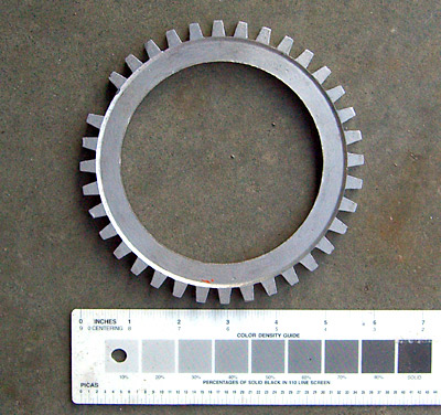

I need a part for a 1990 mx6. What I need is the crank pulley with a trigger wheel mounted to it. I would prefer it out of aluminum, but steel would be fine too.
I can send you a crank pulley to copy and the trigger wheel that will be mounted to it.
The trigger wheel will need to be adjustable; possibly with some set screws?
Depending on cost I wouldn't mind using the stock pulley. I have one with the rubber taken out (the rubber has been known to fail) that can be welded together and machined to accept the trigger wheel.
I can't private message yet because I have too low of a post count.
The pictures are not my own and I'm not sure if the size of my trigger wheel is the same as the one in the picture, but mine is just like that one.

something similar to this:
Originally Posted by gavin View Post
60-2 trigger wheel.
Not only am I allowed any crank/accessory pulley….
But also I am allowed to modify that or the stock pulley for the expressed purpose of using a crank fire ignition system…
Next the the fellow who does all of my welding projects is a machinist. I enlisted his help in doing some modifications to the Performance Probe aluminum pulley and the trigger wheel so I would have both bolted together perfectly true.
The trigger wheel was starting to rust a bit and I didn’t like that, so I had it plated along with some camber plates that had been cut for me a long while ago by Ed Vandermolen (he has the black and green FE-DOHC racecar in the Netherlands)
Assembled and finished off with stainless steel button head screws. (marvel at its bling-tasticness )
Magnetic pickup
The TEC3 likes to use the 11th tooth of the trigger wheel (from the missing teeth while the engine is at TDC) to start its count. I had to create a mount for the magnetic pickup so that it could be oriented properly to the trigger wheel tooth in question and also firmly affixed to the engine.
There are a couple bolts to the left of the crank pulley that seemed to be mounted on the same plane. That would allow me to build a mount that would orient the mag pickup in the 10-o-clock ish area of the trigger wheel. This is what I came up with.
The bracket was a fairly simple thing. I built it so I could have adjustment for tilt, height and distance away from the block (you can see the slots on the “L” bracket). Once I finalized the correct orientation I wanted, I drilled and tapped screws to pin everything into place.
I reused the existing screws as the added thickness of the mount was thin enough to still have ample thread engagement….at least on the bottom of the mount. The top had the additional thickness of the “L” bracket and I preferred to have a bit more cushion in terms of thread engagement there. I found a longer screw from a disassembled transmission and used that for the top of the mount. Heres how it all looks assembled.
The mag pickup had to be wired up. The inputs from the distributor go straight to the mazda ECU. Since the path is direct and no other component uses those circuits, they are pretty much “unassigned” pathways, so I used the distributor plug to send the necessary signals from the mag pickup to the TEC3. There are four wires in the distributor plug, I only used three since the TEC3 needed pos, neg and a shielding ground. I used the red, blue and yellow wires of the distributor and created an adaptor.
so basically….(tec3 requirement : mazda wire color : mazda pinout)
Positive + : red : pin 3H
Negative - : blue : pin 3E
Shield : yellow: pin 3F
(continued)
