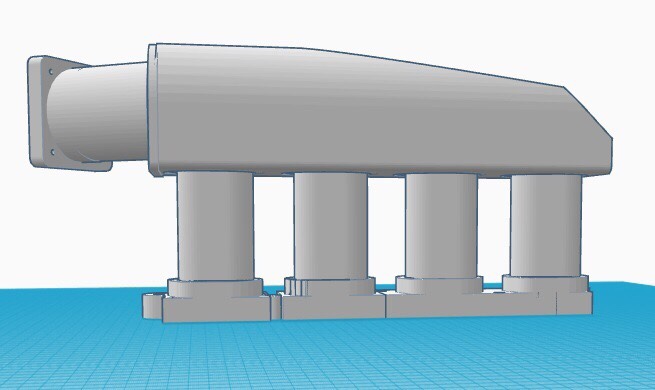

Default Turbo_Steve's Custom SHEET METAL INTAKE MANIFOLD Design / Build Thread
Over the past couple years I have pondered and played with the idea of making my own custom sheet metal intake manifold for the mazdaspeed 3/6.
I will save the blab talk and just say that after many hours of design time & a couple 3d printed prototypes I have finally come up with a design that I feel worthy of building.
A simple manifold flange featuring single port runners & set up to use off the shelf extruded tubing.
Plenty of room in the flange to add injectors.
Only parts needed to be machined are 4 velocity stacks, head flange & throttle body flange. Everything else can be sourced from Ross Machine Racing.
Be patient as this will be a while before I have a finished product. I am very near to having parts machined and ordering up everything.
Only thing to figure out yet is some minor plumbing / port placement.
Pictures of rendered components below.
Soon to come.
WHO KNOWS? A.D.D. FTW!

TMIC support? Runner alignment straight on or arched so there's no sharp kink in flow pattern?

I don't know if I'm half asleep or still high from last night, but this IM looks like an Imperial Walker.
I want one.

This has the potential to be a great manifold, if the runners follow the same angle as the head runners.

The shape of the head side ports should also match the port shape of the head.

If you are going to design one, why not a dual plenum to even up flow?
No TMIC mounting. As of right now the runners are a straight 90 degrees alignment with the plenum. I actually thought of having the runners angle towards the inlet side a few degrees for flow improvement and also to provided added clearance by the power steering pump on the genwon & Speed 6. It would be just a matter of cutting the tubing on an angle as I have left enough clearance in my velocity stack & head flange. I will have to wait till I get all the parts in my hand to see how fitment is.
Soon to come.
I agree but from a design aspect / keeping costs down so far this is the best option I have come up with.
I think that comparing this design to the oem manifold, having the runners come in straight is still better than having them curve up like the oem mani.
The major improvement is the relocated throttle body & the tapered plenum. Also I think the runners I have selected being larger than oem, but smaller than JMF should allow this manifold to perform very well up to 7,000 rpms but still promote more mid range power.
I still am undecided about overall runner length right now as well.

The majority of the manifold wouldn't need to change.
Just making the flange a wedge with the correct angle would do the trick.

Glad to see you are moving forward with this. I really looked at doing it last year when we talked about it, but I just haven't found the time/ambition. Too many other projects. Hopefully it all goes well!

Will oval velocity stacks work as efficient as circular ones? Could always have a circular stack inside the plenum with tubes that gradually switch to oval before the head. May be minimally affected however and machining costs would probably increase. Also, if our map sensor is in the plenum and these velocity stacks result in increased pressure would it result in a messed up tune? IE would we tune for 24 psi but see 25-26 actually entering the motor? As always ignore me if I am way off base
Thank you for getting the wheels turning in my mind on this.
Here is something I am playing with. I can get a 7 degree angle on the runners fairly easily. I will have to put the injector bungs further back in the runners themselves with this setup but not a big deal.
I will play around with this a bit more and may end up 3d printing a model of this just to check clearances in the car.
I would bet that a traditional round velocity stack would be an improvement over the oval design, but I am trying to make something that is simple to machine and uses off the shelf tubing, etc, etc.
As for the question about messing up the tune. The point of the velocity stacks is to provide a smooth transition from the plenum to the runner for both the intake charge and pressure waves. Ideally a smooth transition will let more air flow through the runner into the head and cylinder thus allowing your engine to flow more air and make more power.
The mas air flow sensor still works just as before and lets the ecu know how much air is going through the motor so that it can send enough fuel.

Yea after my post I thought about the sensors and turbo being pre stack and how it will adjust via the tune. Are there off the shelf oval velocity stacks like you need? I'd assume a round one would be easier to source and a tube transitioning from round to oval wouldn't be difficult to have made for cheaper than a custom velocity stack. Just throwing ideas out there. Love your ingenuity

Steve, if you want to send me any designs of this, I have access to limited flow modeling. (I have a seat of solidworks simulation, but dont use flow often) If you had multiple designs you wanted looked at I might be able to help you chose.
The stacks I designed are relatively inexpensive to manufacture. Due to other fitment issues, the off the shelf stacks are also a no go.

3d printed runner mockup.
I think the actual runner length I go with is going to be about 1" shorter overall.
