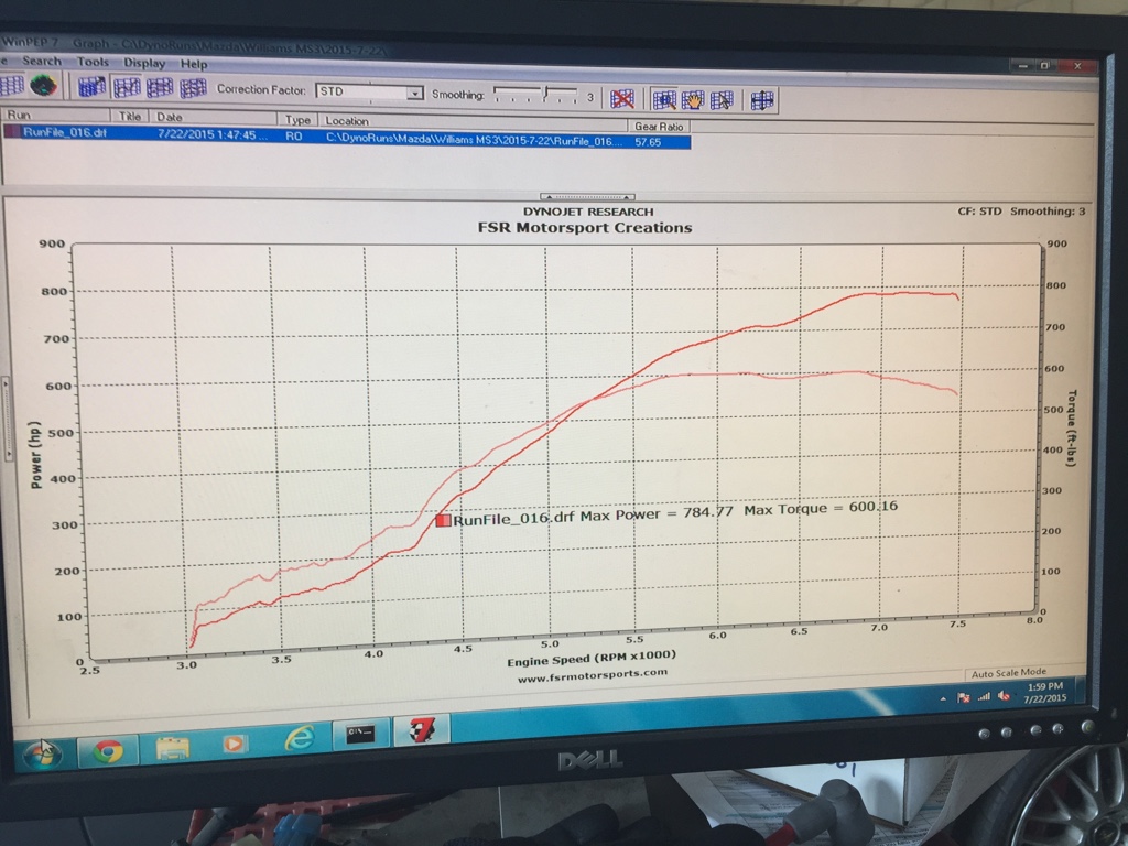

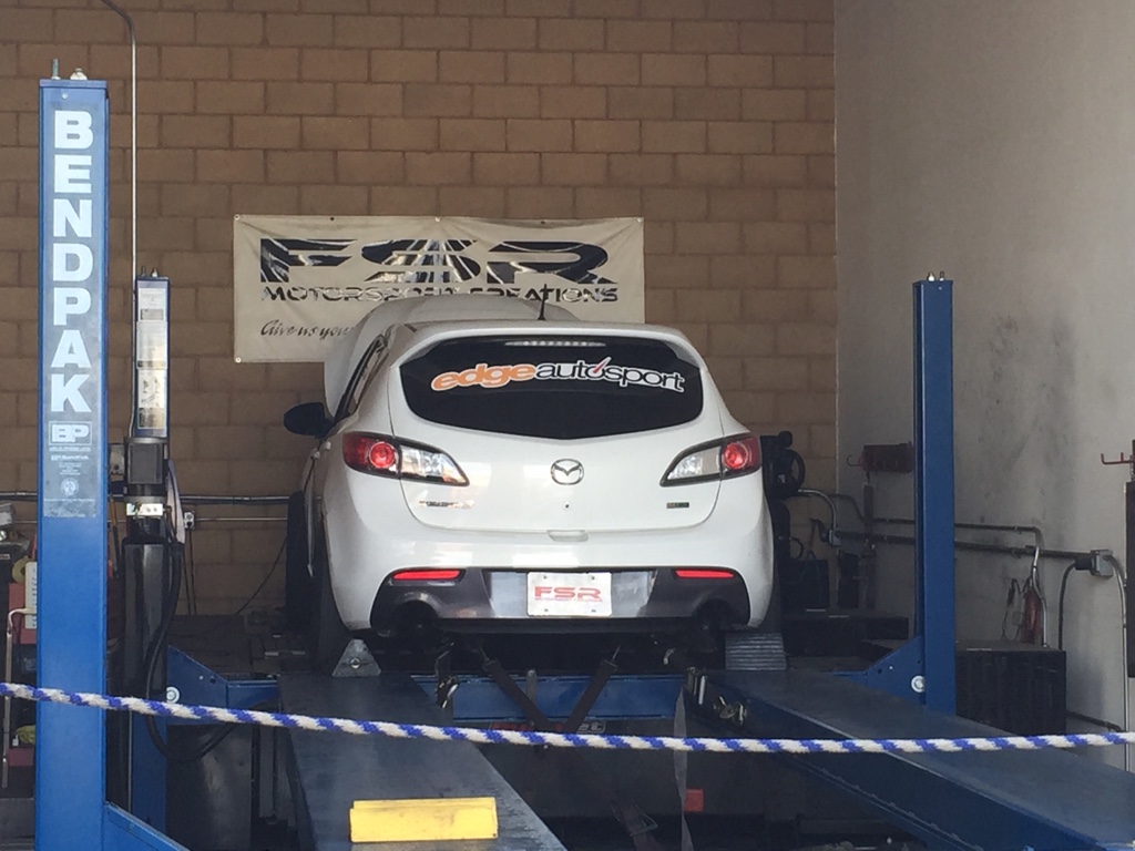

Default 784hp/600tq
Let's make this MSF official @Raider;
Yesterday we had a chance to get @LumberJack; car on the Dyno. After his fresh rebuild we made a few pulls on the street. Made sure motor was broken in (70 miles on her when we hopped on the Dyno) plugs looked mint. No smoke whatsoever, converted her to full e85 and started some tuning. We came on the Dyno with 500hp, a couple hours left with 784hp 600tq and I tried to make the tq curve as broad as possible.
Next order of business is to dial in the alignment and suspension, dial power back to make sure she hooks and then keep bringing it in until we reach the point of breaking traction.
Enjoy!

did you guys lose some traction there around 4K? if not why the plateau do ya think?
4k or 7k?
7k plateau is loss of timing control

no right between 4100-4200. did you log the run and lose/plateau some boost there for a sec? just curious.
That was a slight boost oscillation on that pull
