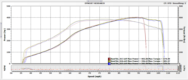

Default E85 adds 70HP/TQ
Stage 1 tune
MS CAI2
TPMS TIP
Stock turbo
EGR delete
Turbosmart BPV
CS TMIC
MS CBE
Fuel pump
OEM Downpipe
Racepipe
Map sensor
From a 91 octane Freektune map to an E85 (E22 mix) tuned map, I gained 70HP. That is all.

That's pretty amazing for those mods. Excellent

Dynojet correction factor. See what a 1.01 correction factor comes up with.
Great gains.

dynojet CF = 1.09
so with CF = 1.01 you have about 315/370

CF 1.03

CF 1.01
Not sure which is more accurate.

CF=1.01 is the "de facto" correction factor for our cars.

I recalibrated my MAF a little leaner (98 octane) and found more power and torque to 5200 rpm, then after, it drops. Perhaps, the right thing to do is to slowly enrich AFR from 4500 rpm up. I'm a little scared of the big torque.
There are probably other factors such as weight and ambient temp. This is where fine tuning comes to play.
What i would do is slow your turbo down a little. Youre making a lot of torque at pretty low rpm. Set your boost targets a little lower below 4k rpm and set wgdc accordingly. I bent a rod at 4k rpm and 425ish torque on vdyno. Build boost progressive to redline and youll be fine. I know its fun to feel all that torque down low but its not fun tweaking a rod. It will also flatten your torque curve for a better powerband

Ill try to tune lower torque at lower rpm.
Currently I'm using load tune. Converted from boost tune to load tune last month. Learning heaps from this forum.
