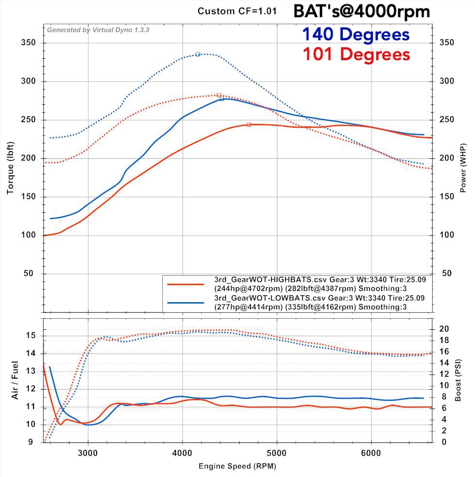

When my tune was completed, BAT's were about 120 max. Car was doing great, feeling great, running great. Then it heated up to 117 outside!!! KR started getting crazy when BAT's reached 140-150. One day it hit 5.96 and held for the last half of my 4th gear wot pull. It spiked, but then started dropping. It had dropped to 1.4 by the time I let off.
I have not seen it that high ever and never again since then. But, I was still getting wacky KR numbers in the 2's very frequently in part throttle and as high as 2.5, with 140+ BAT's.
I was told by a local Nator member to pop a gallon of E85 in and see what happens. So I did. KR disappeared. There were only few blips of .3's and .7's here and there. After 25 or so miles of testing her out; easing into the power, I got brave. I reverted my tune to an earlier revision, that had more boost and blasted out 3 pulls with High BATS... two 4th gear and one 3rd. one blip of .3 in all three runs!! Fuck you 91 Oct!!
I did a morning wot pull the next day. I was VERY PLEASED. the car has been a joy to drive. E is magical. Now I want the E85 tune. You guys weren't kidding.
***Log names contain the starting BAT numbers. The VD is from the morning run.
Side not: Yesterday, when I got home, I noticed my coolant reservoir was bubbling like crazy. I'm pretty sure its the high temps and the crack in my reservoir that's doing it. I have new reservoir coming and used JB Plastic Weld to, hopefully, hold it over. waiting for it to cure. Fingers crossed that the head gasket isn't toast.
I have no smoke, care has full power (evident by VD, below) and cylinders are dry.
Hell yeah man! Glad you jumped on board the E train haha! I just finished up my e33 tune with Justin and the car roasts tires gears 1-3. We had to switch to 4th gear logs which is difficult to do here in san diego at speeds of 105+ Fortunely i have 4 stations near me with E85 and i recently picked up a 5gal gas can to load up on so i always have it on me. My 91 tune is so damn conservative compared to my e85 tune. I'm addicting to E! I'm thinking of picking up a new exahust manifold and waiting on details about damond motorsports intake manifold adapter plate.
