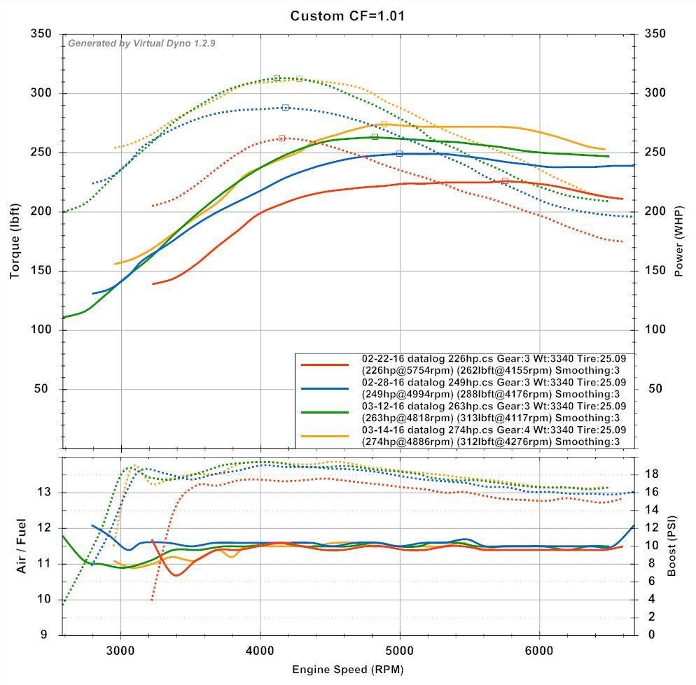

Just for documentation purposes... VDYNO of progression, with logs.
-Cobb OTS Stage2 I scaled for the 3" intake prior to Freektune Base Map.
-Freektune base map 4th gear WOT, after 30 miles.
-Freektune 1st revision map 4th gear WOT, prior to 30 miles.
Looks like my first run above @274 was due to a cooler day and lower BATS.

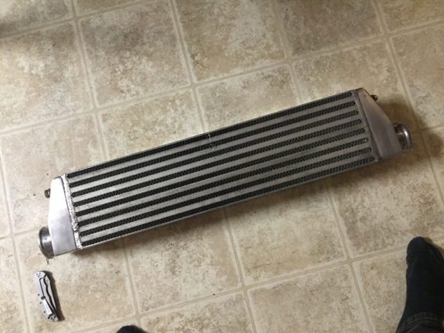

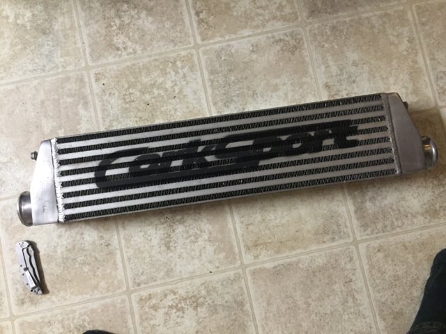

My next set of datalogs are off to @Justin@Freektune;, just now. It's getting warmer here in AZ. So, I will do a WOT log right before I load the next revision and then after its loaded.
My very first Vdyno, on the Base Map (above) was done on a very cool morning. Wish it was still that cool out, than with my 1st revision run. I'm getting high 240's - low 250's now.
I will probably go back to the base map, do a log and reload the 1st revision and do a log, to get an more accurate comparison between the two soon.
Pretty sure I need to get a FMIC stat.

Badass man. Great numbers. Just got my 3rd revision Friday. Will be doing and sending off my logs tonight.
Did this vdyno camparison from the time I was running Cobb OTS thru FREEKTUNE base, 1st and 2nd revisions. Didn't get 3rd revision logs done yet.
The days have been getting warmer. But still some good gains. Can't wait for the next.

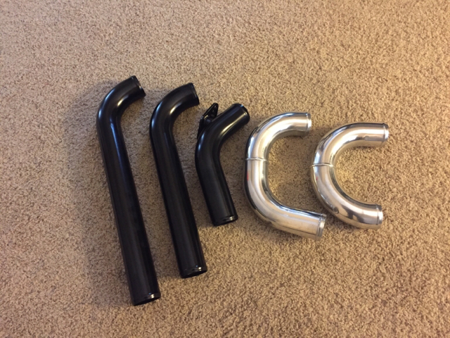

In my 4 revision, the car started having a bit too much KR. So, we reverted back to revision 3. I just got revision 5 Tuesday and have been crazy busy with the new baby. But, I finally got my logs done and sent off.
Here is my last one, I pulled. We had a decently cool day, yesterday.
Just scored a used, but in excellent condition Corksport FMIC and am going to pick up my FMIC pipes from being powdercoated, today. Wooooooooo!!
After this tune is done, I will install it and get a touchup tune.

I'm sure you'll enjoy the FMIC, I love my CS FMIC on the 6 especially as it started warming up lately the car still feels great. Everything is looking good, you should think about e85, feels fantastic .
Told you that the full tune quite a bit different, feels much smoother! Glad you're enjoying your decision.

I'm still not quite onboard with the E train, until I read up more on it. I am more of a no hassle, fill her up and go guy.
Regarding the IC. I was gonna got TR8. But then found the CS on my local NATOR page for only $150. It's basically a TR6. Got CX piping for $130 and powdercoated the upper pipes flat black.
Can't wait to install.
