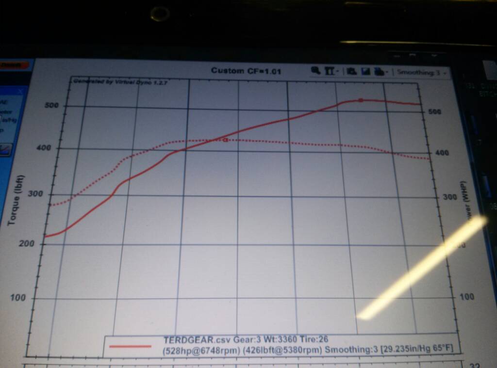

Default PTE 5858 dyno
Some have seen this either on the egde page, or FB, but here is a nice little dyno with a PTE 5858, Cpe manifold, precision 46mm EWG, kozmic DP, and screamer pipe. All purchased through edge as their precision kit This bad boy Made 510hp at 29psi. Was just about out of fuel, but added 2 more psi, to see if it had anything left in the tank, and it made 530. With more fuel this turbo will easily make 550+.

That TQ curve!

The turbo is very comparable to a gtx3076, which is why when my 3076 got killed (different story in itself) I went with this turbo. Spools damn near the same as a gtx3076 too. So it is still a very worthy turbo for stock block. 22psi and conservative ignition timing, will get you in the neighborhood of 400hp.

That torque plateau is pure drivability, it is one of the things I miss the most from my VR6 Golf, underpowered as it was I had full torque, full time, flat line is good
